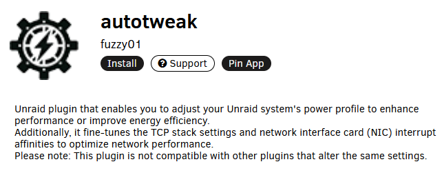

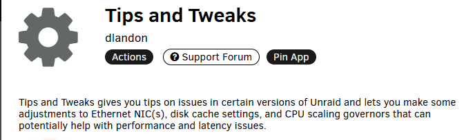

I see what happened now. I have the plugin tips and tweaks instaled which edited the varable for that option.
not sure if autotweaker does simlar:
Otherwise a quick check of system wide settings:
sysctl -p
The main sysctl Configuration File....
/etc/sysctl.conf
As this is the sysctl config and tips and tweaks touches that to make some changes... (why i didn't experience this with HA currently and in the past...)
