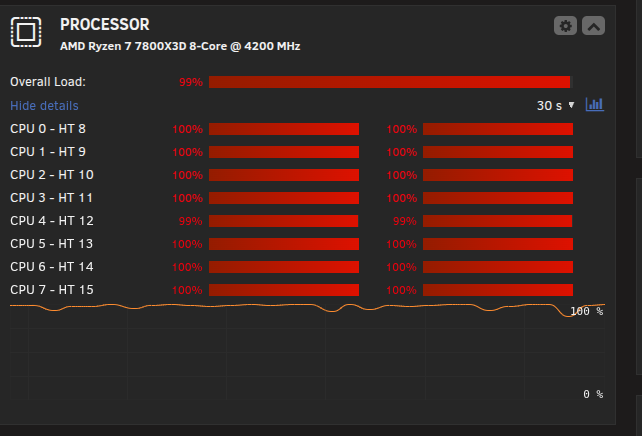

2 minutes ago, feederbox826 said:
Hm everything looks correct, try removing the Jellyfin Driver selector and Driver Selector variables in the config
So i removed the variables from the container:
But same message: [InitHWSupport] Supported HW codecs [0]:
and cpu going crazy:
Let me add some more debugging for AUTO_AVGID, I have a feeling your --device flags are throwing it off, don't pass in /dev/dri after passing in /dev/dri/card0 and /dev/dri/render128, or just pass in the entirety of /dev/dri
Right so just like this? (still doesnt work btw)

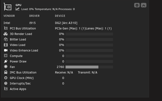

1 minute ago, feederbox826 said:
You might need to remove the LIBVA_DRIVER_NAME and LIBVA_DRIVER_NAME_JELLYFIN, im not sure if the driver is interpreting empty strings correctly. That's the end of my theories, will have to wait for the debug script to deploy
Omg that worked!
It doesnt show up as an icon in the gpu monitoring plugin, but it shows processes:1
and my cpu has much less load
Phew! Glad I could help!
Thank you so much for taking the time and troubleshooting it with me! I'm shocked im the first person to run into this problem since it's a standard variable when you create the container
default should be "" (empty), you might've had an old version that has the default set to iHD, but your system is using i965. Will probably remove it as Jellyfin is much more reliable with driver selector
Ahh, i manually set the value to "iHD" when i couldnt get it to work based on some posts i read elsewhere but it didnt work regardless
btw, i thought my system was using i915
