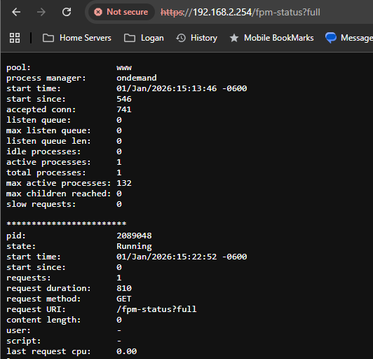

some more code prosperity..
https://forums.unraid.net/topic/194245-pool-www-server-reached-max_children-setting-50-consider-raising-it/#findComment-1598907
Script to finetune unraids fastcgi.. and add teh fastcgi status page to track the childs what pid how long etc...
a
#!/bin/bash
# Unraid PHP-FPM hardening + diagnostics
# Run: At First Array Start
PHP_FPM_CONF="/etc/php-fpm.d/www.conf"
set_value() {
    local key="$1"
    local value="$2"
    if grep -qE "^[;[:space:]]*${key}[[:space:]]*=" "$PHP_FPM_CONF"; then
        sed -i -E "s|^[;[:space:]]*${key}[[:space:]]*=.*|${key} = ${value}|" "$PHP_FPM_CONF"
    else
        echo "${key} = ${value}" >> "$PHP_FPM_CONF"
    fi
if [[ -f "$PHP_FPM_CONF" ]]; then
    echo "Configuring PHP-FPM limits and status endpoint in $PHP_FPM_CONF"
    # Process model
    set_value "pm" "ondemand"
    set_value "pm.max_children" "50"
    set_value "pm.process_idle_timeout" "10s"
    set_value "pm.max_requests" "200"
    # Hung / zombie worker kill switches
    set_value "request_terminate_timeout" "120s"
    set_value "request_terminate_timeout_track_finished" "yes"
    # FPM status endpoint (read-only diagnostics)
    set_value "pm.status_path" "/fpm-status"
    # Restart PHP-FPM
    echo "Restarting PHP-FPM..."
    /etc/rc.d/rc.php-fpm restart
    echo "PHP-FPM configuration enforced successfully."
else
    echo "ERROR: $PHP_FPM_CONF not found. PHP-FPM may not be installed or path changed."

adds and sets:
so lets makse some safe tuning:
pm = ondemand
pm.max_children = 50
pm.process_idle_timeout = 10s
pm.max_requests = 200
request_terminate_timeout = 120s
request_terminate_timeout_track_finished = yes
pm.status_path = /fpm-status
simnalr another base script needs ran to allow niginx / the web server to use the status page..

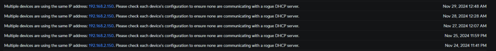

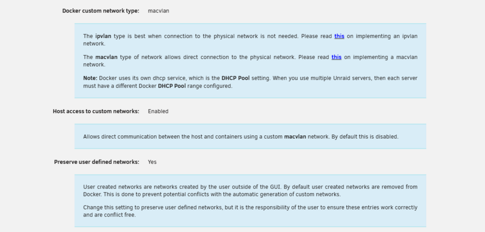

On 11/30/2024 at 1:09 PM, bmartino1 said:
no bridging, no bonding. Fix vhost service IP due to vhost getting a privatized MAC address and set a static assigned within the taps network.
In my case eth0 is 192.168.2.x/24 and my machine is set to 192.168.2.254. With bridge off and bonding off (as this machine doesn't need it)
My unifi network complains and i get phantom devices on Unraids Reboot. DHCP snooping and other layer 2/layer3 announces due to how unraids uses a bridge tap for docker and virtual machines. So I treat the vhost0@eth0 network tap as a service that I want a separate IP address assigned to.
By default in v7 with br0 "bridging enabled macvlan will use shim bridge to make the macvlan connection... by default unraid ships with docker networks using ipvlan. Pro cons to each...
The ipvlan type is best when connection to the physical network is not needed. Please read this on implementing an ipvlan network.
The macvlan type of network allows direct connection to the physical network. Please read this on implementing a macvlan network.
use ip a to see your interfaces. you will see chost#/shim-br# @ interface and will see that he ip address for your br#/eth# is the same which is the problem... so treat it as its own service.

unfi example in logs:
More a networking / unifi issues... as unifi is overzelaus in its ip snooping...
Note this requires unraid advanced docker settings enabled:
Due to a bug:
https://product.unraid.net/p/muti-nic-macvlan-host-enabled-relapse-ip-added-docker-rc-script-issue
I still don’t know how to reporduce on other systems… But inteh event other users experience this bug too...
