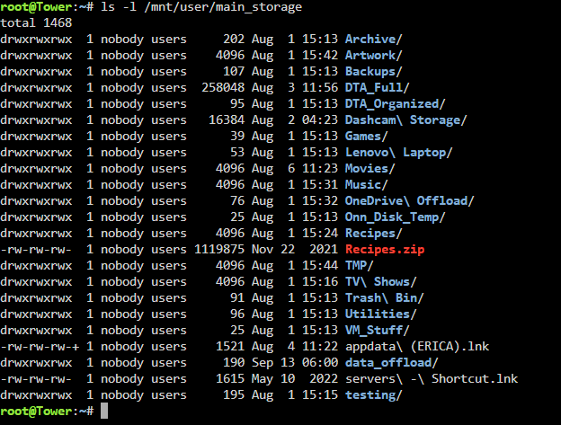

Post the output from
ls -l /mnt/user
Got an error. Ran it in the terminal accessible from the webUI.
You typed in a stray ~...
I updated my RAM config, I think that's why the server name went back to Tower.
That's OK, now output from
ls -l /mnt/user/main_storage
Testing is the only folder I can access.
Permissions look correct, if you can access one of them, you should be able to access all the other ones, post the diagnostics in case there's something visible there.
Nothing obvious, but they appear to be right after a reboot, did you try accessing the folder with issues? Also, you can access the other folders locally right?
Still no access under SMB. File browser in Unraid WebGUI still shows all the files, and the few I pulled down worked. Can I delete the SMB share and remake it without data loss? I only have a partial backup of this data.
