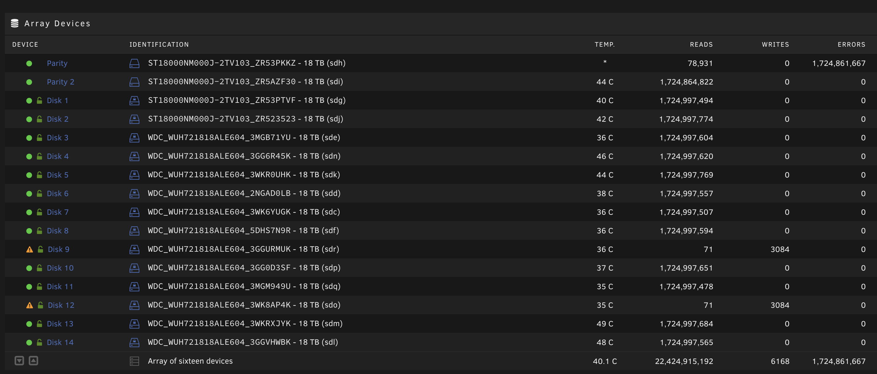

One of the parity drives is showing a 100% error rate during the rebuild - I highly suspect a cable issue with the drive.
Can I stop the rebuild, fix the cable, and then restart from the beginning?
Or should I let the current rebuild continue and presumably only one of the drives will be fixed, then I can 'redo' the rebuild to fix the other? I would prefer the former so I only have to rebuild once.

thanks for the reply, unfortunately i stupidly was not aware of the filesystem check and i started the array rebuild process.  one of the parity drives immediately also failed during the rebuild.  i suspect that one is a cable issue.  (new diag and picture attached)

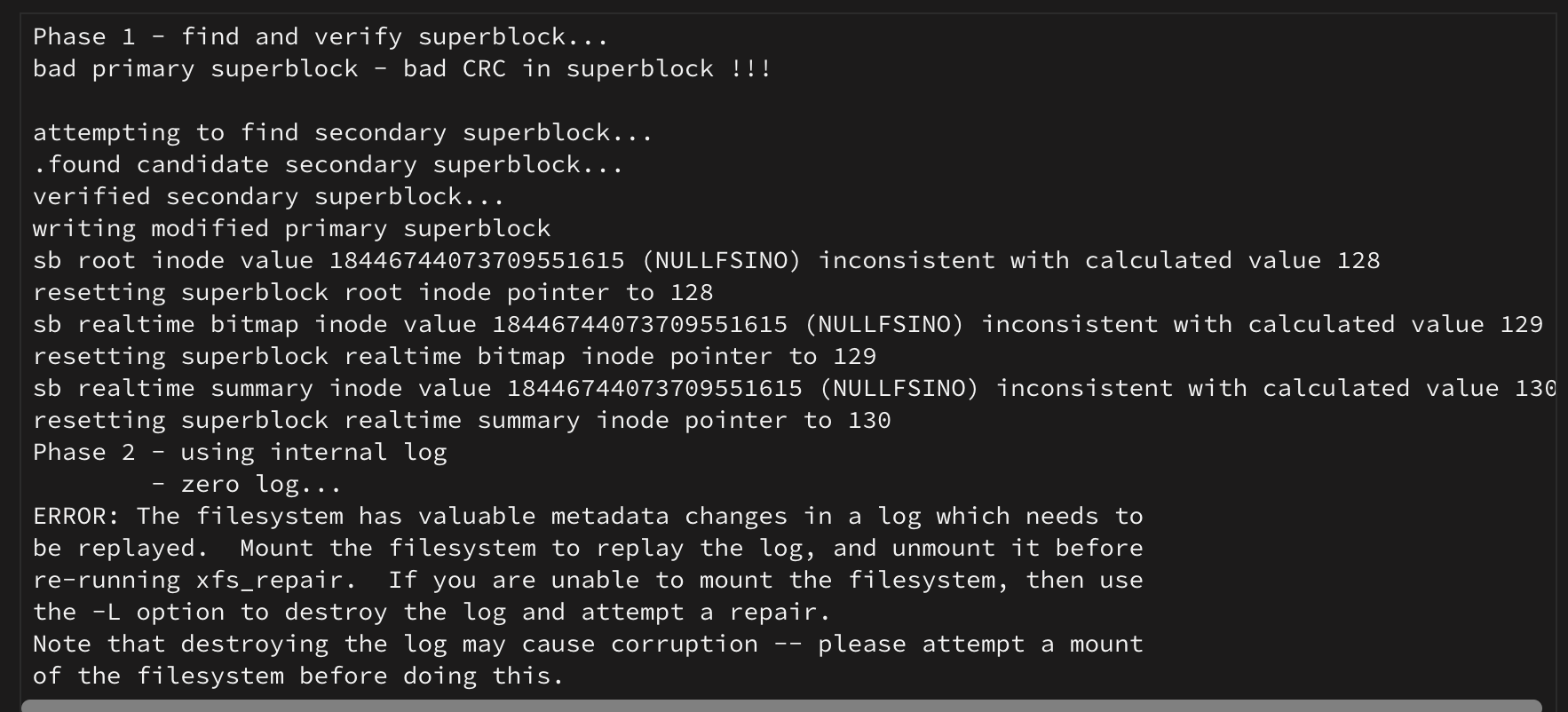

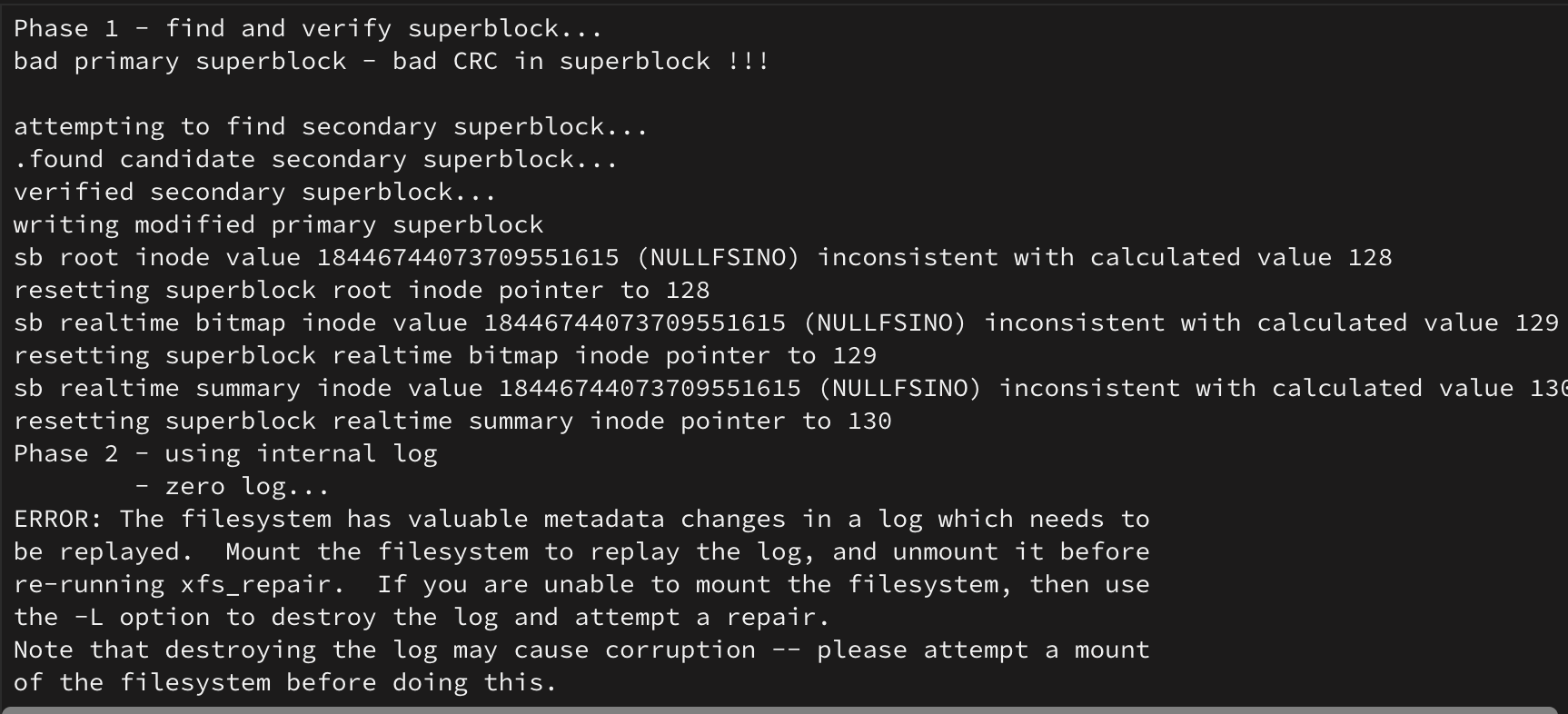

here's the output of xfs repair on both drives without the -n option (attached via screenshot because paste format was not cleanly pasting).  should i still proceed with a rebuild once all cables are checked?  or is this filesystem level corruption
Screenshot2024-11-19at6_35_57AM.thumb.png.18ae9940106a434e419add69efd962aa.pngScreenshot2024-11-19at6_35_38AM.thumb.png.89e884c9825d17f245bc45276024d1e6.png
Edited by oliver
Use -L

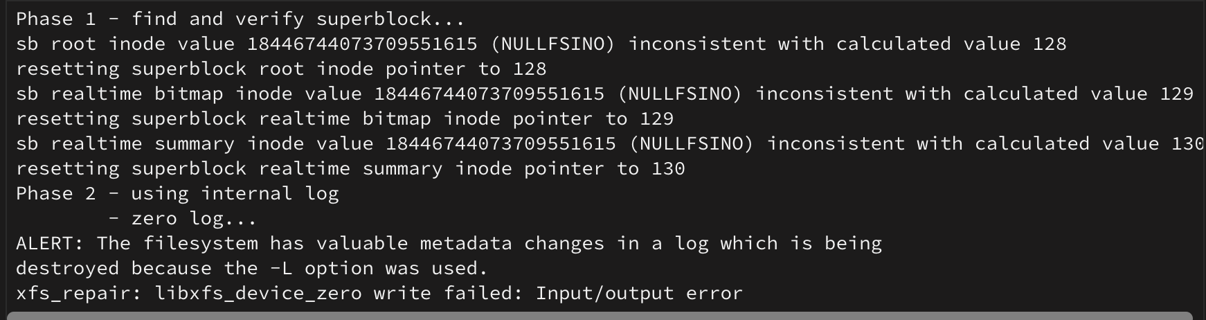

11 minutes ago, JorgeB said:
Use -L
Both failed with input/output error, along with the parity drive again suddenly showing as failed again (diags attached).  I need to double check the hardware.  All of this nightmare started when I did a motherboard upgrade.  I'll see if there's any common connections between the three drives but also probably just go back to my old motherboard and see what happens.  I just find it really unlikely all 3 of these would fail at the same time like this, especially if they are not all part of the same connection and have no issues prior to mobo change.  Thank you very much for the assistance so far.  Attached diags if there's any more info to give.
The first one got a little further before i/o:
2nd one failed immediately.
