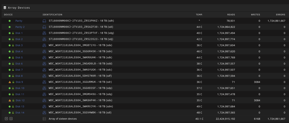

thanks i got a clean reboot.  im mulling over leaving it all shutdown vs emulating until new drives arrive.
i sat next to the sever while booting and i notice right when the UI loads, the area with the 2 drives, it sounds like the hard drives basically restart.  it sounds like they are abruptly stopped and restarted.  im not starting the array in any way, just when the UI is initially loading.   still doing more disassembly to narrow down individual drives
im curious, from these diags attached are you able to see anything to that?
from a hardware perspective, i am actually running my array on two power supplies since the last incident.  all of the hard drives are on one entirely dedicated 750W PSU and the rest of the hardware is on it's own.  at this point i've also replaced all the data cables so at this point i don't know what else it could be other than the drives although very interesting they seem to fail always together.  there's a set of 4 drives connected to the same power/data and the other two seem fine.
nas-diagnostics-20241208-1104.zip
I do see what look like power/connections issues for disks 9 and 12 during boot.
