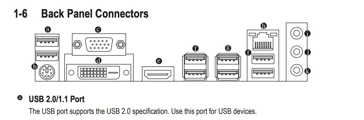

To rule it out, there are two USB2 ports on the back of your motherboard
Yeah, actually this was something I figured out when posting this. so those work then all my IO on the top of my case which is a USB2.0 and USB3.0

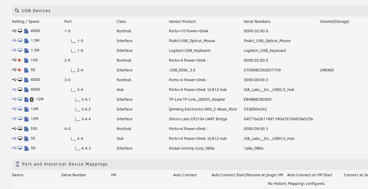

As you have USBM the logs would show any changes.
cat /var/log/syslog | grep -i usb_manager
if you have a spare usb lying around try loading up a fresh trial and see if things look better.  Maybe something in the OS got its wires crossed.
thanks @SimonF!
not 100% what i'm looking at but does look like it does some removed things, here is the output if you wouldn't mind validating. Currently for this I'm looking at the TP-Link_UB500 as I have that in a 3.0 for testing this (HA doesn't need this for too much in the house right now)

Looks like one of the host controllers is being removed are you passing into a VM? I would disable the usbip options if not using.
not specifically the controller no, I only need three of the USBs passed to HA

@Veah So yes here is the screenshot. it does looks like the USBs work fine in the trail at least basic like that.
