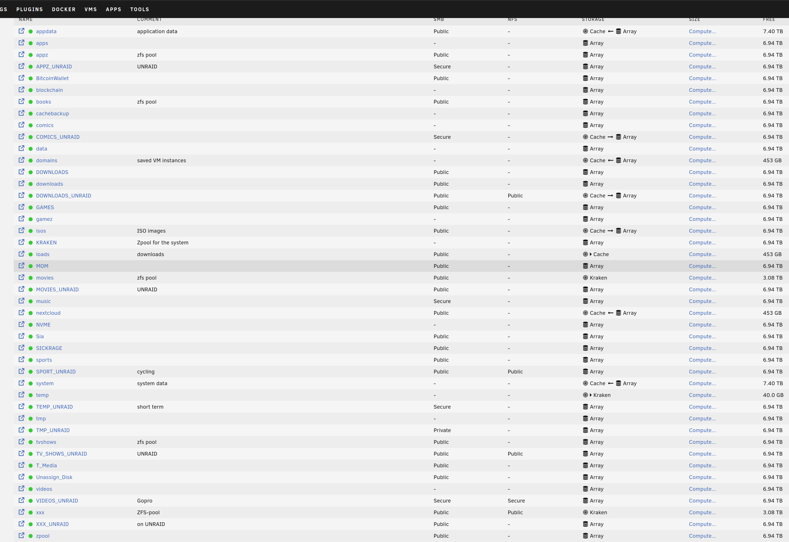

I was using the movie share but it look like it was putting it on the unraid array and not on the zfs pool with the same share name.  plus some files are not showing up on the zfs pool share and i dont know why

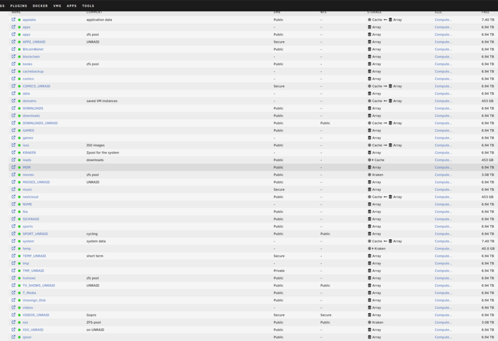

There are a lot of shares in the diags, and the names are anonymized, but don't see any that could be movie, maybe movies? Post a screenshot from the Shares settings page for that share.
yeah it's movies not movie.

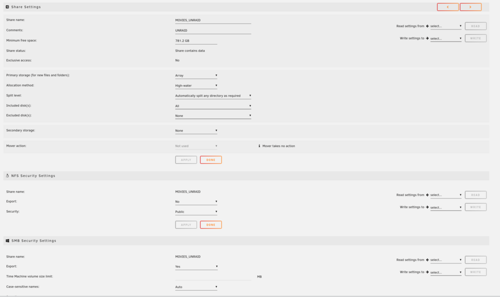

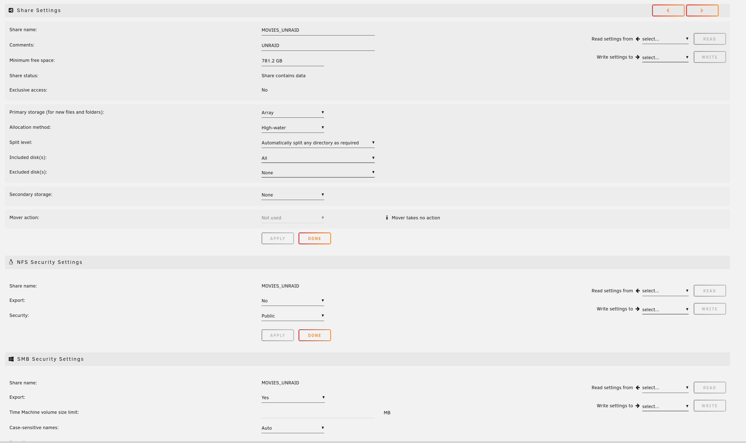

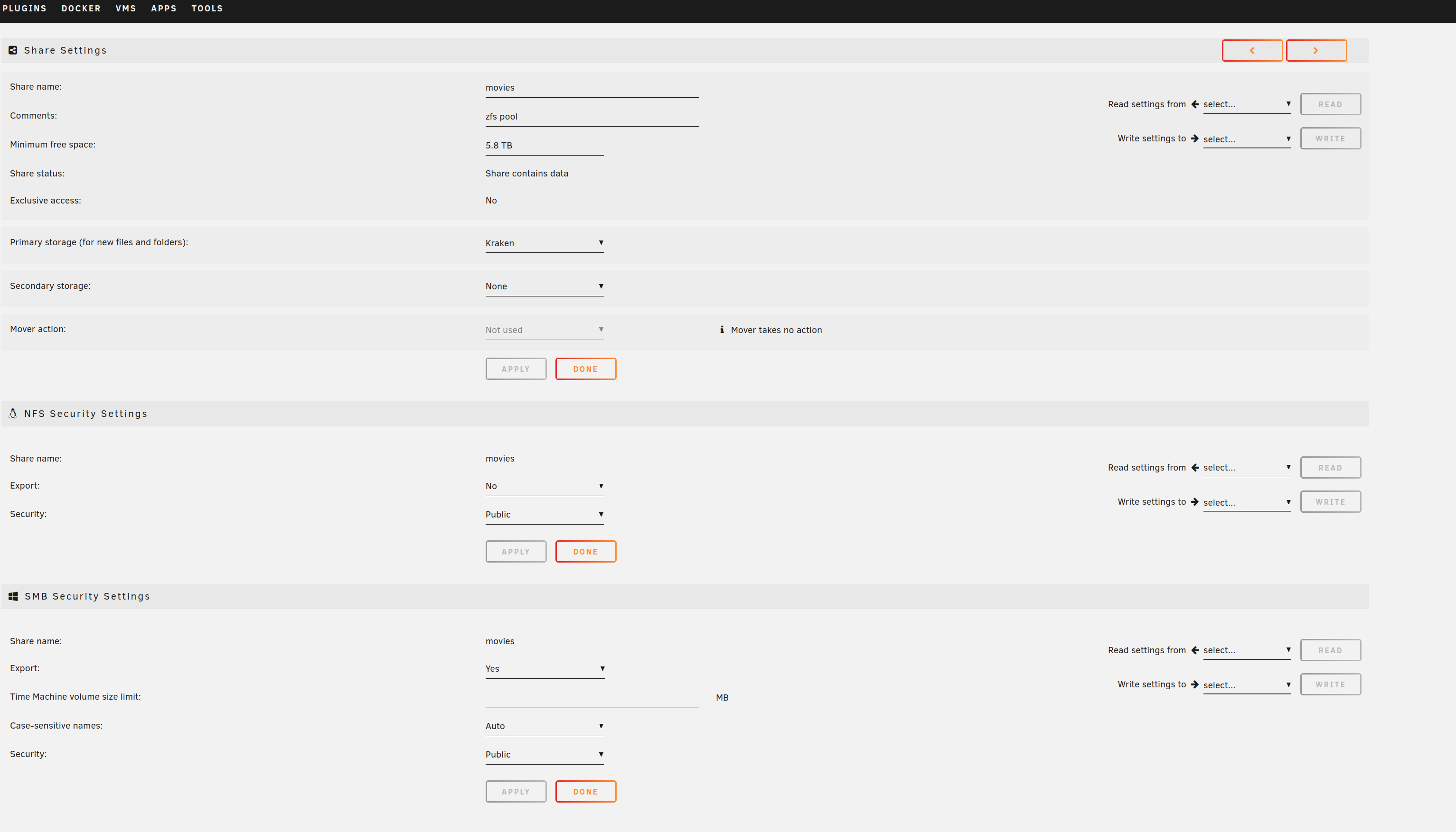

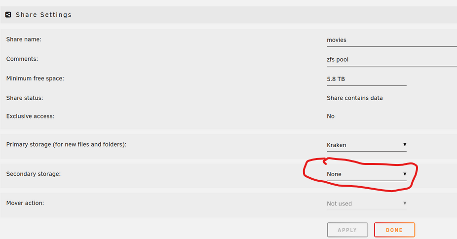

Click the Movies share and post a screenshot from the settings.
what are you looking for?
Yes, floor setting is 5TB, since that's over the pool capacity, it will go to the array
BUT as I see it, there is no secondary storage set up.
I assume he changed that after, since files already exists in the array for that share
that option wasnt there when i created the zfs pool.  I changed it when i saw the files going to the unraid arroy and not the zfs pool.

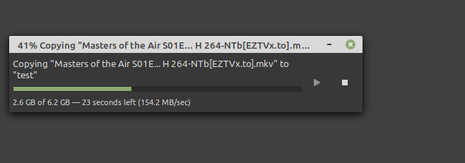

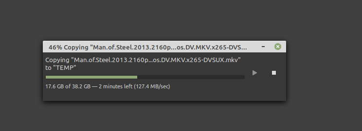

what is with the slow speed over my 10Gig network with 6 drives mirror. even went sending to nvme or zfs pool.  what kind of speeds should i be getting.
these are the speed i'm getting and i'm not sure why so slow?

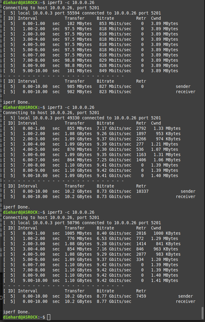

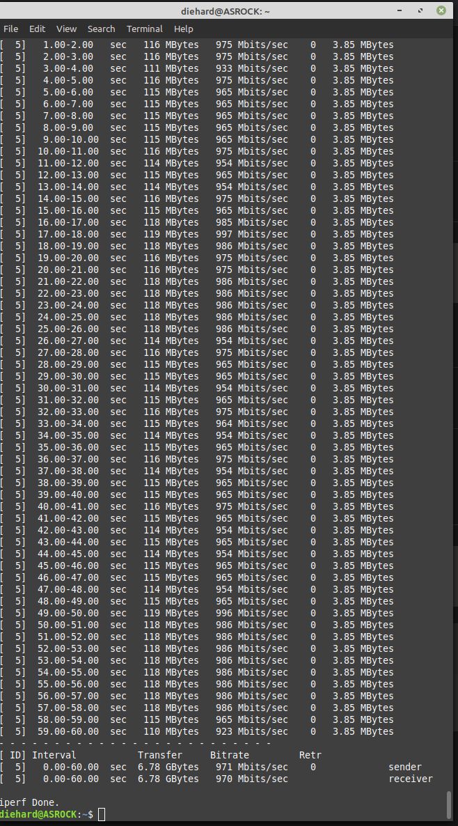

ok, I think I got the test run and it says that its running at top speed or am i missing something.

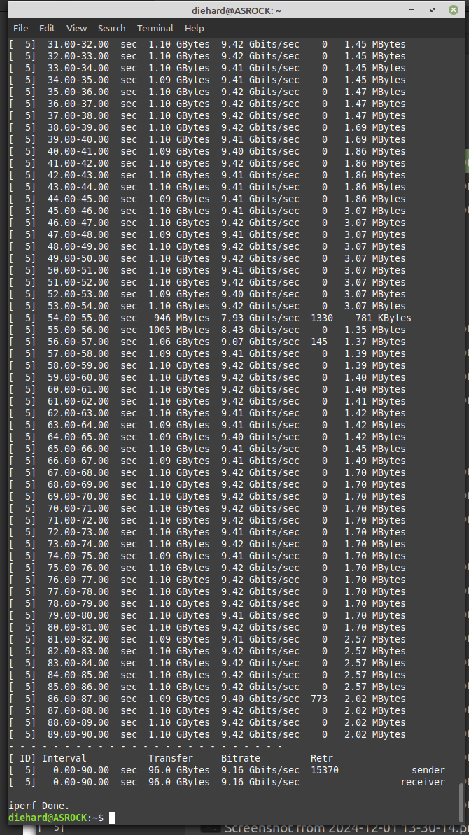

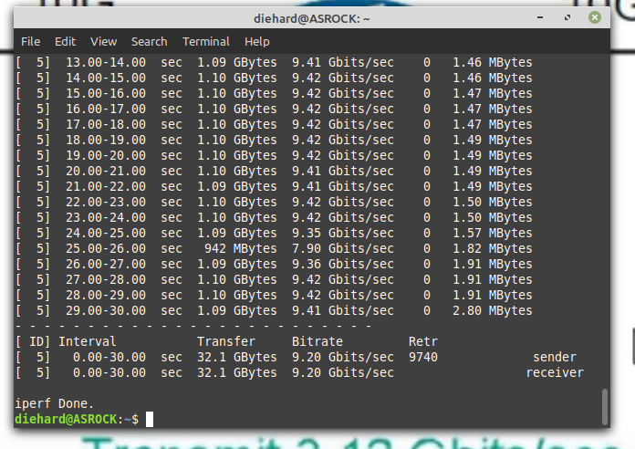

here is a longer test
11 hours ago, JorgeB said:

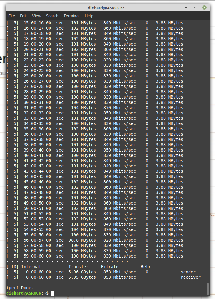

Start by running a single stream iperf test in both directions to rule out any network issues.
I ran two more test and when 60 sec is run it's slow and then i run a 90 sec and it's fast.
Not sure why the 60 sec keep running slow
Post the commands used for both, that's not normal.

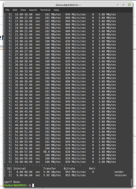

 iperf3 -c 10.0.0.26 -t 30
 iperf3 -c 10.0.0.26 -t 60
iperf3 -c 10.0.0.26 -t 90
I'm not sure why doing the  test for different sec would give a much slower speed.
So what it says the speed is slow what do i need to do to get it to run a full speed?
That's very strange, and it's always repeatable?

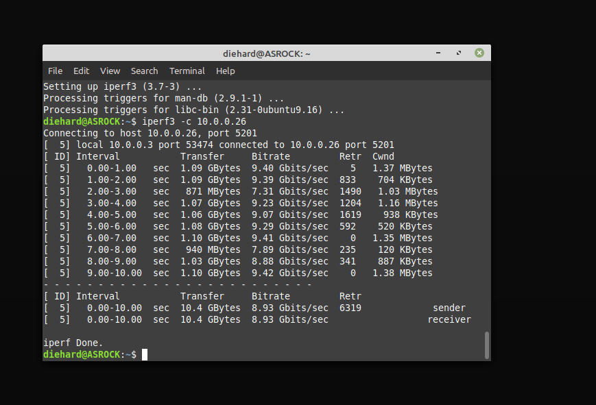

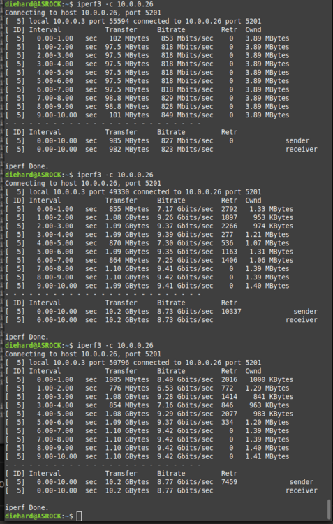

And if you do the regular test without specifying any time, and run it multiple times, do you always get good speeds?
run the test 3 times and the first round was bad but the other 2 were good
what can i do for the ones with the bad test speed? something must be ccauseing that.
I see that you have a bond, try retesting without it.
