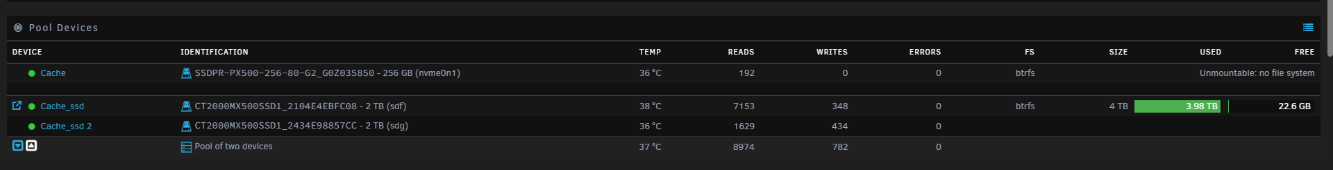

Just tried for the second time to update my unraid server from latest 6.12. version to newly released stable 7.0.0., and sadly I have a problem with my cache drive.

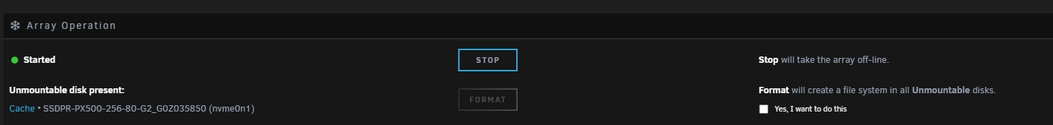

After a reboot it says, that my cache drive (for system, appdata and domains) is not mountable, and it wants me to format it to make it work, but after that I will lose all of my data, so is there any solution for this situation?
I know, that I can always backup my system, but that's not how it supposed to be right?
Below screens and diagnostic file attached.
Thank You
unraid-diagnostics-20250110-1403.zip

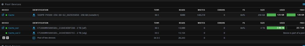

i also updated from latest 6.12 to 7, and now the array is not starting "Wrong Pool State-cache - invalid expansion" should i open another thread?

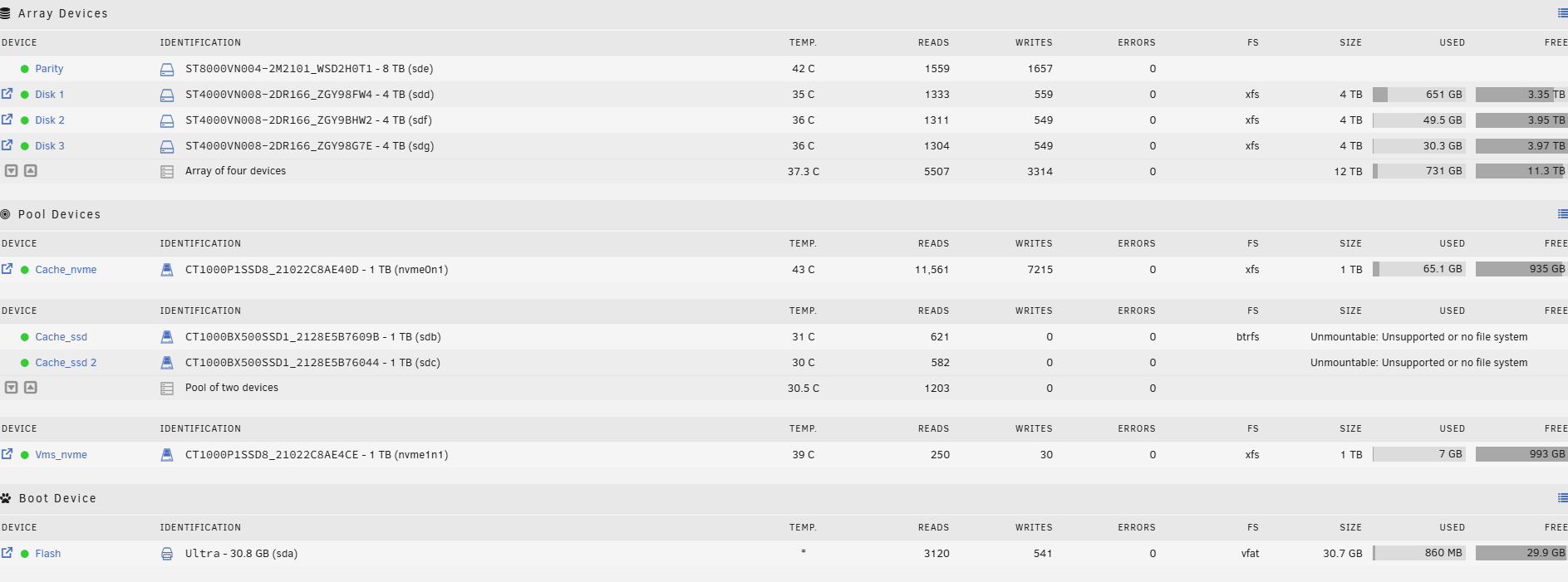

Hi first-time poster and a noob.
It seems since I tried to update to Unraid 7, I have had a similar problem to the above with my cache pool. I managed to downgrade and get the tower running.
What should I do?
Thanks in advance.....
