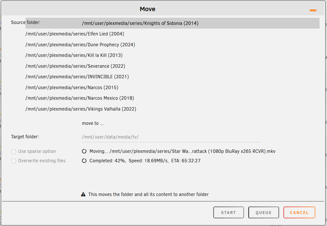

On a side note, I stumbled on another post about painfully slow DFM transfers, which you answered back in 2022. It made me do some quick math regarding my own transfer: if the average parity disk write speed I'm seeing in the "Main" tab on the Unraid GUI was accurate (~150MB/s), this whole thing would have been done in around 19 hours.
The move has been running for almost exactly 24 hours at this point, and I'm only barely halfway through the 9TB. So the writes I'm seeing on the parity drive can't possibly be accurate, or they're not all contributing to the move order. (I currently have no other process working on the array). So it seems that the speeds reported by DFM are indeed accurate.
One thing I noticed looking more attentively, is the DFM speed sometimes spikes to around 60MB/s, which you mentioned was the realistic maximum for an intra-array move; yet it also comes crashing down as low as 5MB/s regulary. When you mentioned this 40-60MB/s maximum, was it sustained or peak speeds? What could explain such speed volatility? Errors in DFM reporting; inefficiencies inherent to the parity process, fragmentation issues (is defragging even a thing in Unraid)?
Either way, at least I'm seeing peaks which match your stated real-world maximum. The initial 100MB/s I was seeing must have been attributed to the large cache on these enterprise drives.

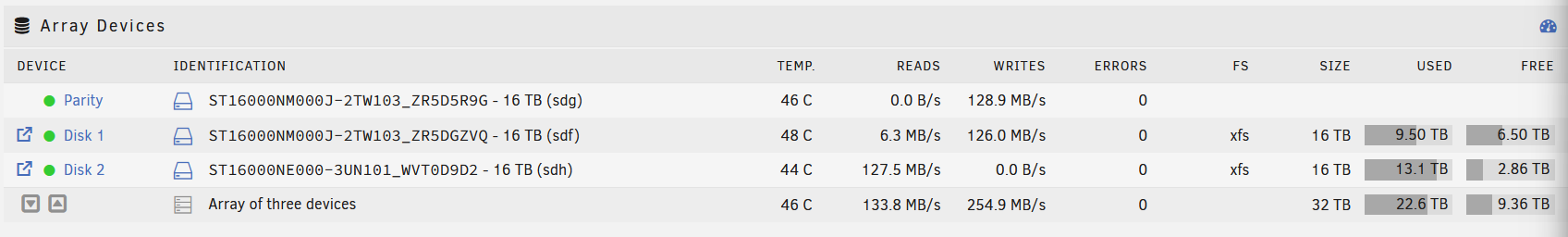

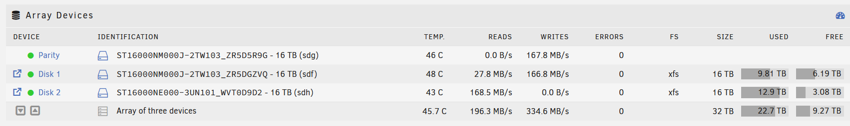

I was referring to the speeds here:
Which consistently, throughout the entire run, do not match the speeds I'm seeing here:
How can the drives be writing faster than the speed at which the transfer takes place, throughout the entire run? And the math with the elapsed time seems to show the DFM estimate is accurate.

Something's definitely wrong then. DFM speeds have dropped to 9MB/s max this morning, and the time elapsed vs amount of data transferred math backs that up. It's now saying it needs 4 more days for the remaining 4TB. So almost a week in all to move 9TB from one share to another... And that's assuming it doesn't slow down more over time than it already did.
