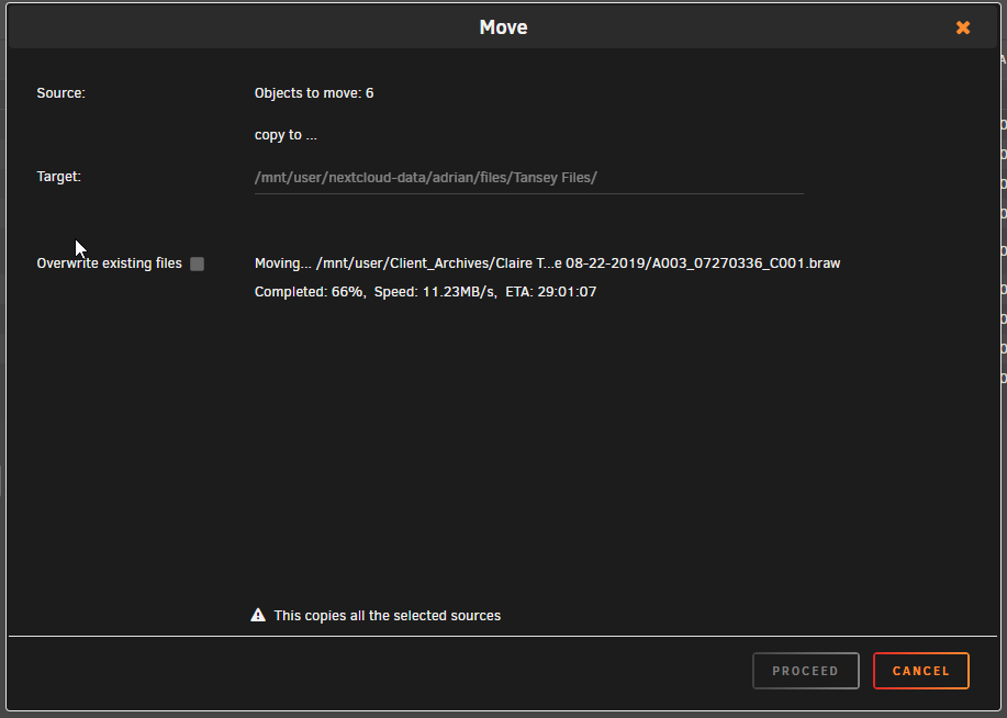

I have had my issues with network performance and now I am seeing overall internal performance that I can't ignore or accept.
I am transferring files from one share to another share, internally using the Dynamix File Manager. I have 8 drives that are all SATA3 600Gbps. So why is it that this internal file transfer is running at 11MB per second?? That is 2.2% of the drives potential throughput!
I understand that UnRaid does not stripe data across drives. But going from one SATA3 drive to another SATA3 drive, internally should NOT be going this slow. I've seen transfers start at a high speed but then peter out to almost nothing dropping as low as 6MB/s
The target nor the source share DO NOT use the cache.
Unraid is always pretty slow when transferring data inside the array, because of how parity works, and currently it's not possible to use turbo write for internal transfers, though I would still expect it to be faster than that unless you're using SMR drives, what drive model is parity and the disk you're writing to?

@JorgeB - All drives are Seagate Ironwolf, 5x6TB + 3x8TB except parity. Both parity drives are Seagate Exos 12TB and 14TB.
I would expect better performance with those, especially since it looks like you're transferring large files, though like mentioned it will never be close to disk speed, maybe 50/60MB/s at best, I believe the plugin uses rsync internally for the transfers, but never tested myself, you could try for example with midnight commander (mc on the console) to compare, but note that it would be much faster transferring to a pool or an unassigned device then transferring back to the array with turbo write enable, I always try to plan things to avoid internal transfers in the array.
The transfers speeds are bouncing around topping out at 160MB/s but then dropping down to >30MB/s then back up for a short period but then back down. It never goes much higher than 160MB/s which is still way off the 500MB/s potential of a single drive and more realistically, stays in the lower 30MB/s or less speeds for the majority of the activity.

True, just checked the specs on the Ironwolf drives and they are rated at 240MB/s on paper.
I guess my frustration is the constant up and down speeds. Especially dropping down so low for so long.
I know they are different animals but I don't see this kind of fluctuation from the old Synology box I have which doesn't have any highspeed cache at all.
Plugin might just not be reporting a correct/stable average, the actual speed is what really matters, at 100MB/s you can transfer around 300GB per hour, if you get anywhere close to that I would consider a great speed for an internal transfer.

So I did a very non-scientific test and timed a section of files. It transferred 30.9GB of data in 8 minutes. If my math is right, that works out to approx 66MB/s average transfer rate. This is a significant performance hit when considering hardware capabilities IMO.
Seems about right to me.
Also as already mentioned Unraid will always be slow for internal transfers, it's because the way parity works, you can find more info here, turbo write part is not relevant since it can't currently be used for internal transfers, which by itself is a shame since it would be faster.
