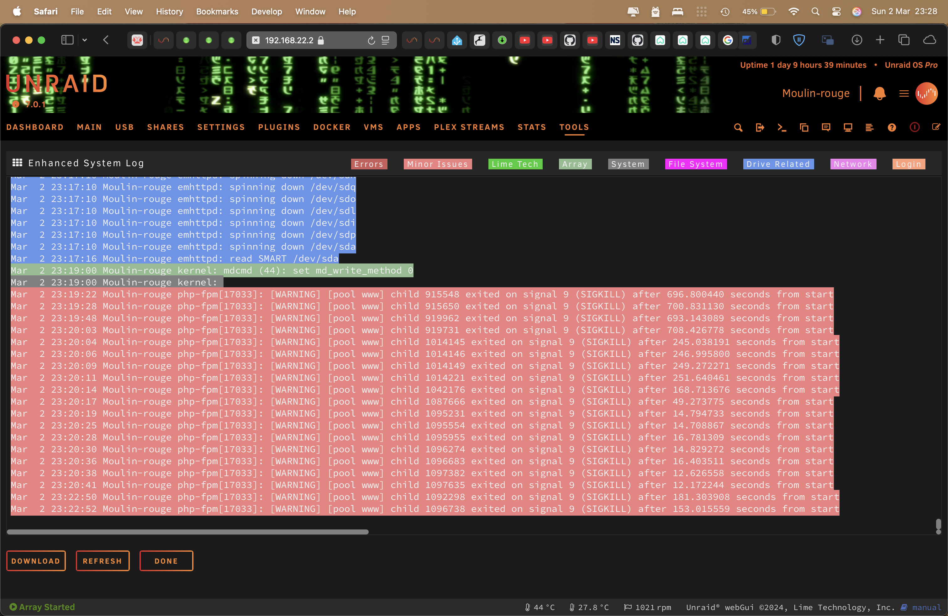

Slow web management when docker cpu usage load high causes PHP crash?
Only started happening since recent up date to 7.0.1
I did up my zfs ram allowance but there's still about 11GB free so it shouldn't be a ram issue.
All containers still accessible and if I pause NZBGET then I get main unraid webGUI back.. so is it some php bug?

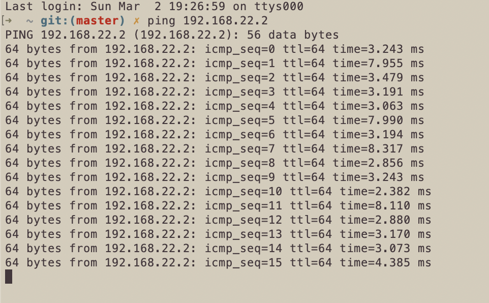

Ping is fine.

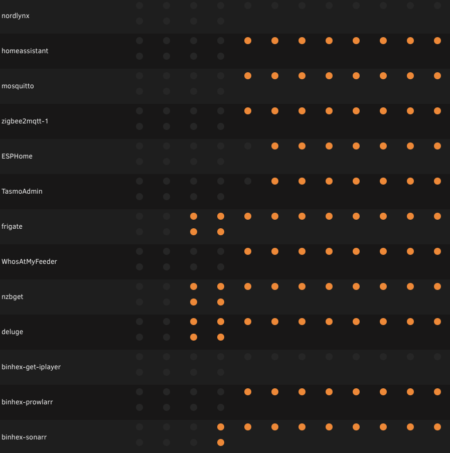

Sounds like nzget is being a resource hog and starving the system, try restricting cpu through pinning resources (avoid first 2 cores if possible).
example:
note: advanced view must be toggled to see this option in docker template

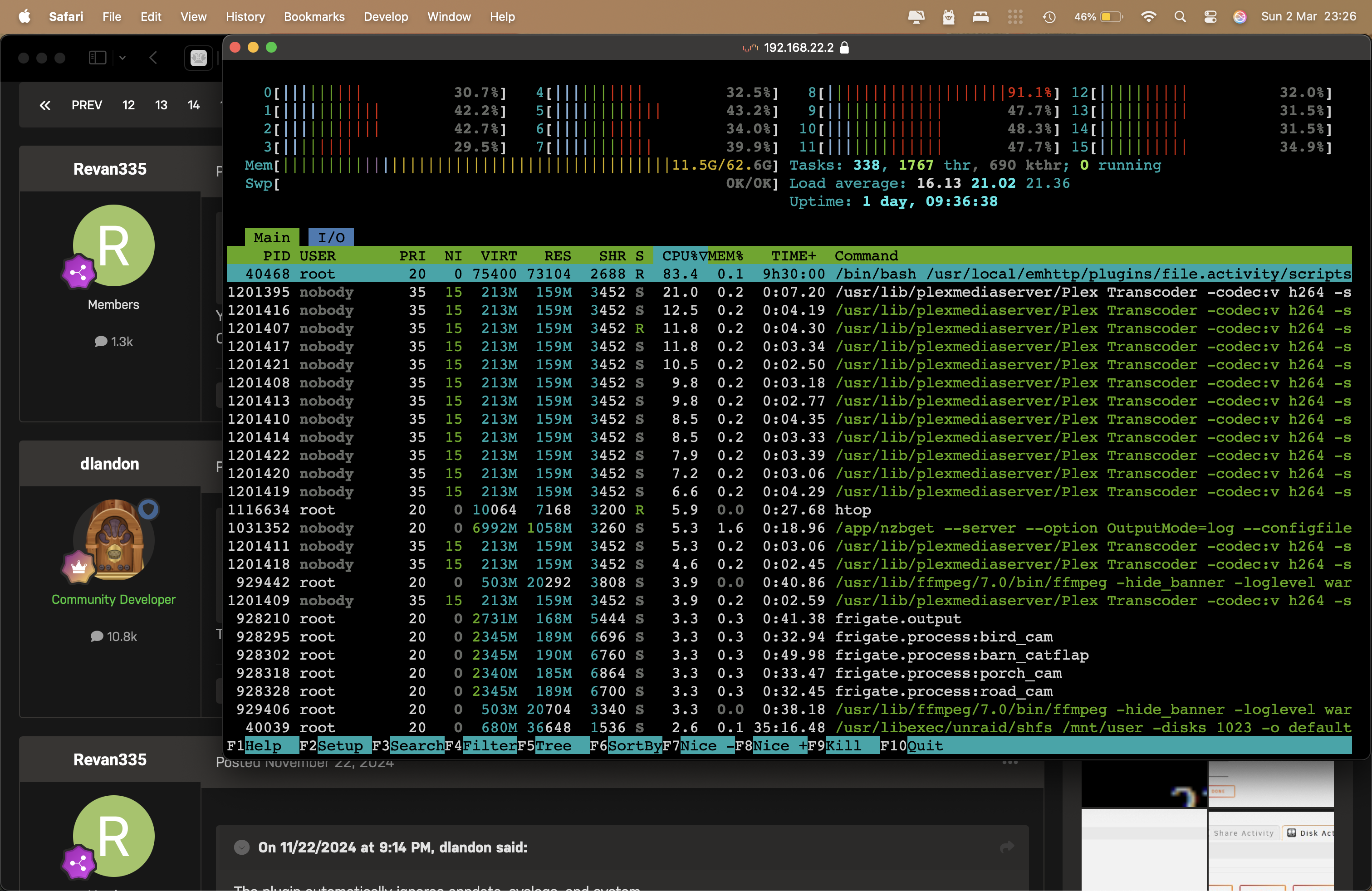

Thanks yeah that's helping stop it overtaking. Noticing that the file monitor plugin seems to be eating some cpu up when nzbget is going which is odd?
I've disabled it for now.

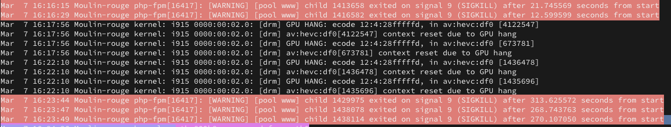

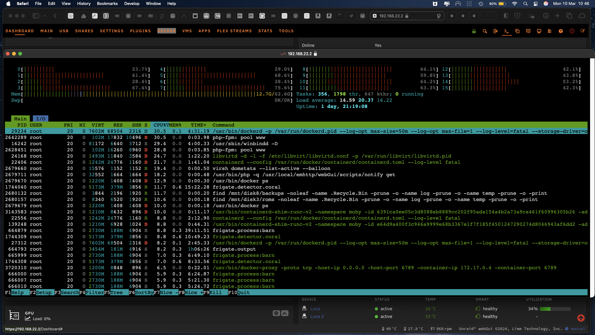

Just now had this again.
Something causes the PHP bug but only for main Unraid GUI, then gpu says it hang but frigate still working.
Am I being hacked or something?
Noticed if I reboot firewall regain access to unraid gui.

Mar  7 17:24:08 Moulin-rouge nginx: 2025/03/07 17:24:08 [error] 763884#763884: *1744649 connect() to unix:/var/run/syslog.sock failed (111: Connection refused) while connecting to upstream, client: 192.168.22.155, server: , request: "GET /webterminal/syslog/ HTTP/2.0", upstream: "http://unix:/var/run/syslog.sock:/", host: "192.168.22.2", referrer: "https://192.168.22.2/Main"

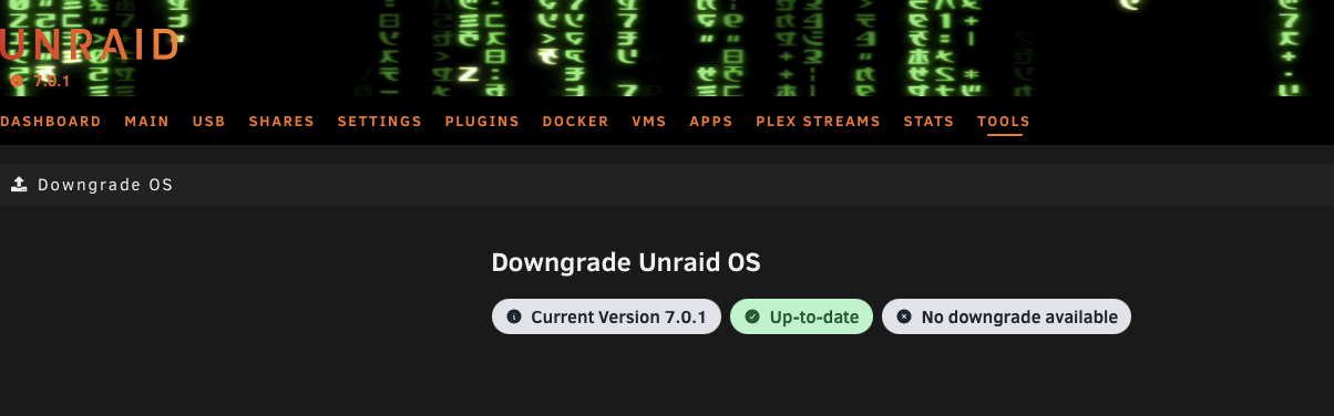

How do I downgrade?
The downgrade button doesn't seem to work says a downgrade is not available.

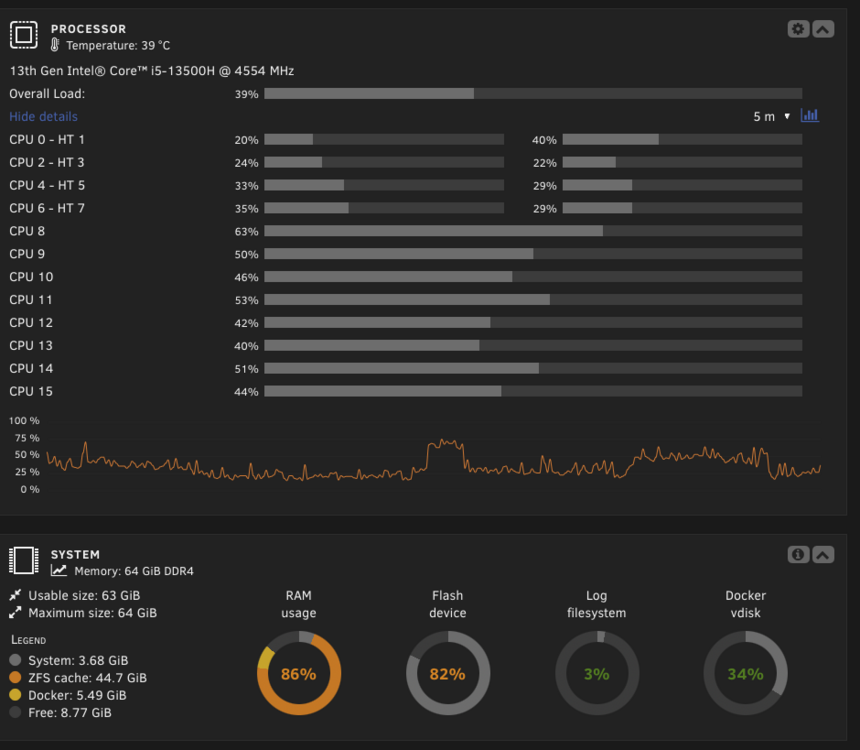

On 3/7/2025 at 6:50 PM, dopeytree said:
Server has 11 - 8GB ram free

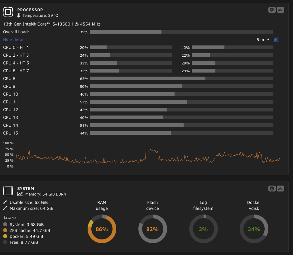

From my experience on several RAM amounts stability is more percentage-based than absolute quantity, I've only had issues like the one you have when RAM usage was >80% or so, reaching 85-ish% would usually eventually lead to a crash.
My guess is if you undo your ZFS ARC increase to stay below 80% use it'll likely be stable again.
Edited by Kilrah

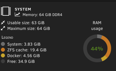

Thanks ok now set at 40GB instead of 48GB out of 64GB.
Currently seems the ZFS cache is slower to fill. It's opting to use 19GB for cache.
Perhaps before although it says free ram. Perhaps it is not available without using a swap file or similar.
