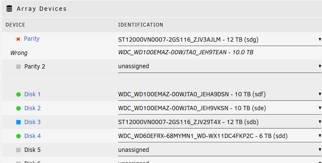

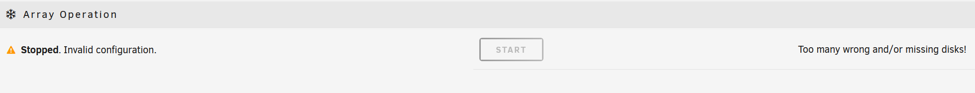

I followed your instructions. After new config, I can't start array. Too many or wrong disc?
You didn't do a new config, or all disk icons would be blue, try again, make sure you hit apply.
The array is not started, start it in normal mode and post new diags.
