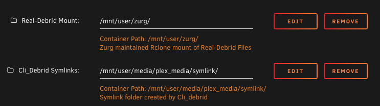

  • Cli_Debrid
    • Container Path: /data as per the guide, did not allow Cli_Debrid to see my RD files for some reason.
      • Confirmed with @Godver3, the container mount should match the location you want Cli_Debrid to search
        • so both container path" & host path: should be /mnt/user/zurg/
    • I noticed that in the guide, you are using the direct mount within Cli_Debrid - which works and is fine.  I'm using the symlinks path (Anime will struggle without symlinks)
      • I had to add another path to both Cli_Debrid, and Plex containers for Cli_Debrid to manage the library properly via Symlinks
      • Screenshot about show's that path (for mysetup).  Others would look like '/mnt/user/user_folder/user_folder/symlinks/' where the user corrects the path their specific location.

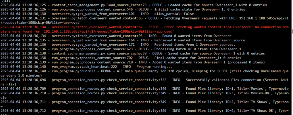

Fantastic Guide. I think I am 99% of the way there, but running into 1 issue. I sent a request from Overseerr and in the docker logs it looks like CLI Debrid receives the request. But I see the following error in the CLI Debrid log (also in attached screenshot)
"2025-04-04 13:20:36,134 - overseerr.py:fetch_overseerr_wanted_content:87 - ERROR - Error fetching wanted content from Overseerr: No connection adapters were found for '192.168.1.188:5055/api/v1/request?take=100&skip=0&filter=approved'"
My theory is that this has to do with what you mentioned in the guide about the Overseerr API key having two "=" at the end. Mine also pasted with == at the end, but I tried it with one and none and that didn't work either. And those == are present in the Overseerr application. I also refreshed the key as well.
Looking forward to hearing your thoughts. Again thank you for the wonderful information.
My advice is to reach out to Godver3, at their Discord channel. He is very helpful, and will help you nail down that issue. I'm having some Oversee issues at the moment. Not sure if I changed something....

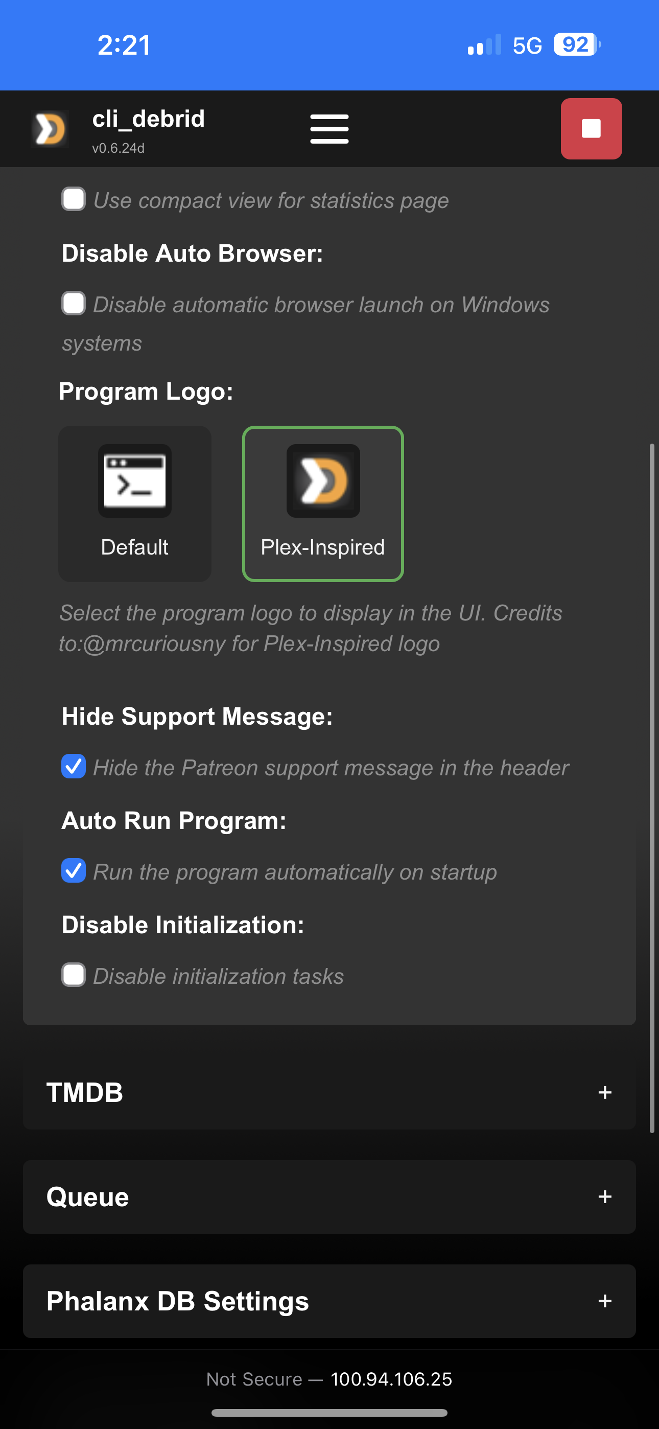

Great Guide. Won't have got this working without it. Thanks for putting it together hernandito.
Just wondering if there is a way to automatically start the cli-debrid program after the docker container has been stopped and restarted? Every time my appdata backup plugin runs i have to go in and manually restart the program. i assume this will also happen on container updates aswell.
Yes there is a way to start the program automagically when the container restarts.  It’s in the advanced settings.
IMG_0935.thumb.png.0c8caad00238d1489b4b36b20458aff9.pngIMG_0934.thumb.png.57d8272643db541e1ba6802772243289.pngGo to system>settings>advanced…check the box that says “auto run program”
Thanks. i cant believe i missed that.

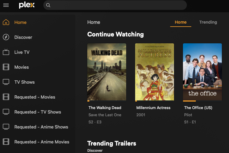

CLI_Debrid is designed to not just fetch, but also upgrade.  Without screenshots of your logs, or more information, I would only be speculating.  So here is my best guess on what little info you provided.
You have an existing Plex library.  You setup CLI_Debrid with that existing library and mainly need it for 'new' requests.  If that's the case, CLI will scan the library it has available to it...and if it 'determines' that it is a bad copy (or that it can scrub a better one), it's going to download new versions.  (I say this with experience, as I did this exact thing on my initial setup.  I ultimately SHUTDOWN CLI_Debrid and now run 6 separate folders for my Plex media.
  • Movies (these are the files I already have locally)
  • TV Shows (these are the files I already have locally)
  • Requested - Movies (CLI_Debrid Symlinks)
  • Requested - TV Shows (CLI_Debrid Symlinks)
  • Requested - Anime Movies (CLI_Debrid Symlinks)
  • Requested - Anime Shows (CLI_Debrid Symlinks)
Setting up CLI this way does NOT scan your existing library and does NOT download 'EVERYTHING'
