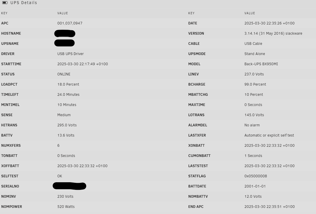

I brought a APC Back-UPS BX950MI, which is connected via USB (supplied via APC) I have plugged everything and am running the UPS pluggin which is displaying the error
"Emergency! Batteries have failed on UPS NameOfNAS. Change them NOW"
seeing this, I had swapped it out and still I am getting the same error message.

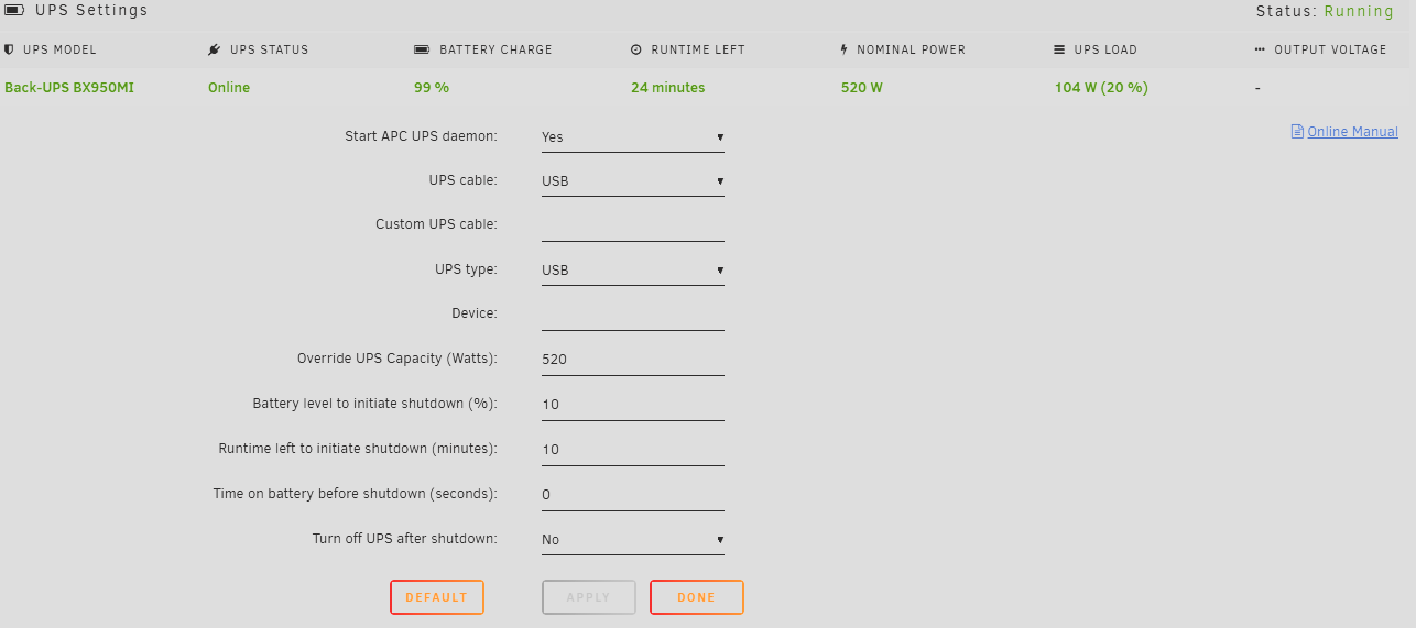

I have tried the various options to switch to Smart / APC Smart, but this displays a communication lost message.
Does any one have any suggestions for this?
Below are my settings, I have tried entering the actual Watts, but this didn't make any difference.
Any suggestions appreciated

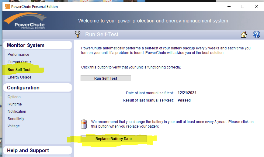

For APC UPS, many times after replacing the battery you need to plug the UPS into a Windows machine, run the APC app (PowerChute), and set the Replace Battery Date.
@DippyDolittle ^^^ This is exactly what I had to do when I replaced the battery a couple of years ago in the APC UPS attached to my Unraid server.

After replacing the battery in an APC UPS, you need to connect it to a Windows PC, run the APC software (PowerChute) and reset the battery install date.
This is assuming the battery is functional and was installed correctly. The UPS will reset the battery health parameters it has stored.
