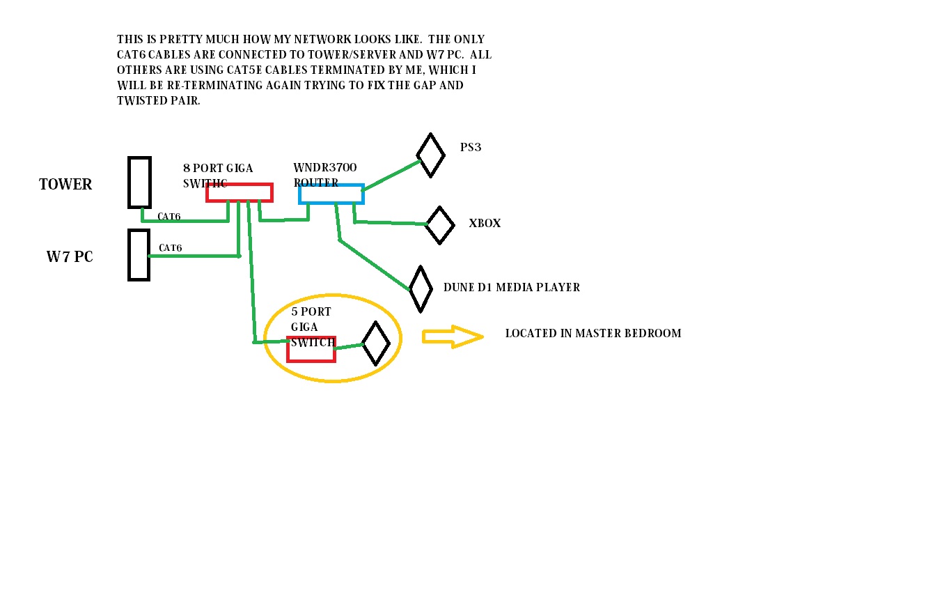

I've created a map of my network.  I've isolated the tower/server and W7PC to be directly in the 8 port Trendnet Gigabit switch.  However, I didn't have enough ports in the router, so I had to connect my 5 port Netgear giga switch to the 8 port.  Everything else is connected to the WNDR3700 router.
My question is since I know that my tower/server and W7 PC cables and hooked up are done correctly, will I be getting the errors, dropped packet, frames, etc due to one or more of the other ethernet cables?
I just order 5 more cat6 cables to replace the ones hooked up to the 2 xboxes, ps3 and dune media player.  The only cable I probably won't be changing will the one from my master bedroom (5 ports giga switch) to the living room (8 ports gigabit switch).  That's like a 100 feet long cable, which runs from the living room, to the out side back yard, running along the inside of the roof all the way to the master bedroom's wall to the 5 port giga switch to the xbox.
I feel so freaking stupid.  I didn't know that the strands from the cat cable would go through RJ45 plug...no wonder I wasn't able to make it look like a already terminated cable.  I youtubed how to terminate a Cat5e/Cat6 cable with RJ45 plugs.......and I was like....STUPID STUPID STUPID!!!
Not trying to pile on here, but I must warn you that unless you ran outdoor rated cable, you will likely be rerunning that one anyway in a year or 2. The jacket material on standard cable just isn't made for exposed use. It will get brittle and crumble at the slightest touch. If there truly is no way to run it indoors, I'd get some pvc pipe and make a conduit for it. At least that way it's sheltered. You didn't staple it to the house did you? Bare staples will damage the wires inside the jacket. You can get cable attachment staples that have plastic guides that don't pinch the wires.
I know it sounds like I'm beating you up about your wiring, but I'm just trying to help, really I am.
It is rated for outdoor, and no I didn't staple it to the roof, but the wire that was there before was stapled by the U-Verse tech.  I used plastic loop holders.

Well, I've been replacing Cat5e cables for Cat6 cable, and 8 port gigabit Trendnet routers fro 8 gigabit Netgear routers.  I proceeded to do some testing pinging www.google.com from my W7 PC, and from my server.
I also pinged W7 PC with the server, and I got no errors or dropped packets from my network.  I then proceeded to transfer a 2.2 GB file from my W7 PC to the server.  I logged in to unmenu and uses the ethernet info.  I noticed 2 errors and 143 dropped packets after completing the file transfer.  I then logged in to telnet and ran the ifconfig, and got no errors by using telnet to server.
So, which one do I go by?  I don't understand why one would show errors and the other one doesn't.

It appears you still have a problem, for some reason packets are getting dropped  :-\
Did you try going back to basics? I would try connecting your PC directly to the unRAID server with a crossover cable and set the IPs manually, then do your file transfers and check for any drops.
I've tried connecting my pc to the server directly, but I wasn't able to connect / communicate with it.  I'll try it again see what happens.
To directly connect you must manually set IP addresses on both machines. Easiest is to check what IP's you have now, and manually set the addresses to what they automatically are getting right now. That way you can confirm your manually set addresses are working before you unplug from the switch. Actually, you shouldn't even need to shut down after you confirm the manual addressing is working, just switch the network cables.
A cross-over cable is not required with Gig-E.
This I did not know, cheers ;D
