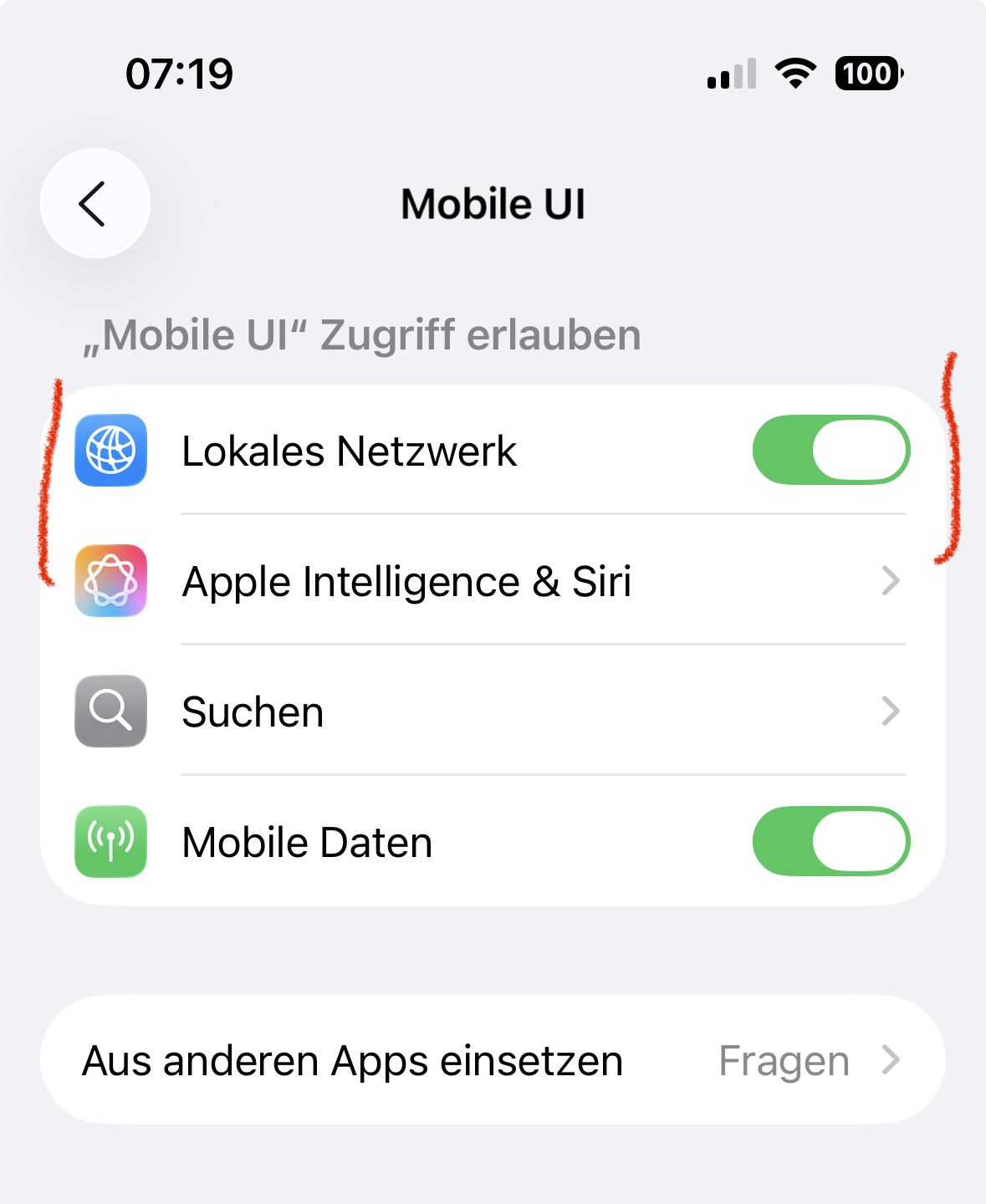

Yeah running iOS 26
It seems there is a bug.. if you install the app fresh on ios26 the app is missing the local area networks permission.. but up to know i dont know why
image.pngCan please check if this is missing?
Yeah, it's there. Tried to toggle it too in case it was some setting that hadn't been set correctly.

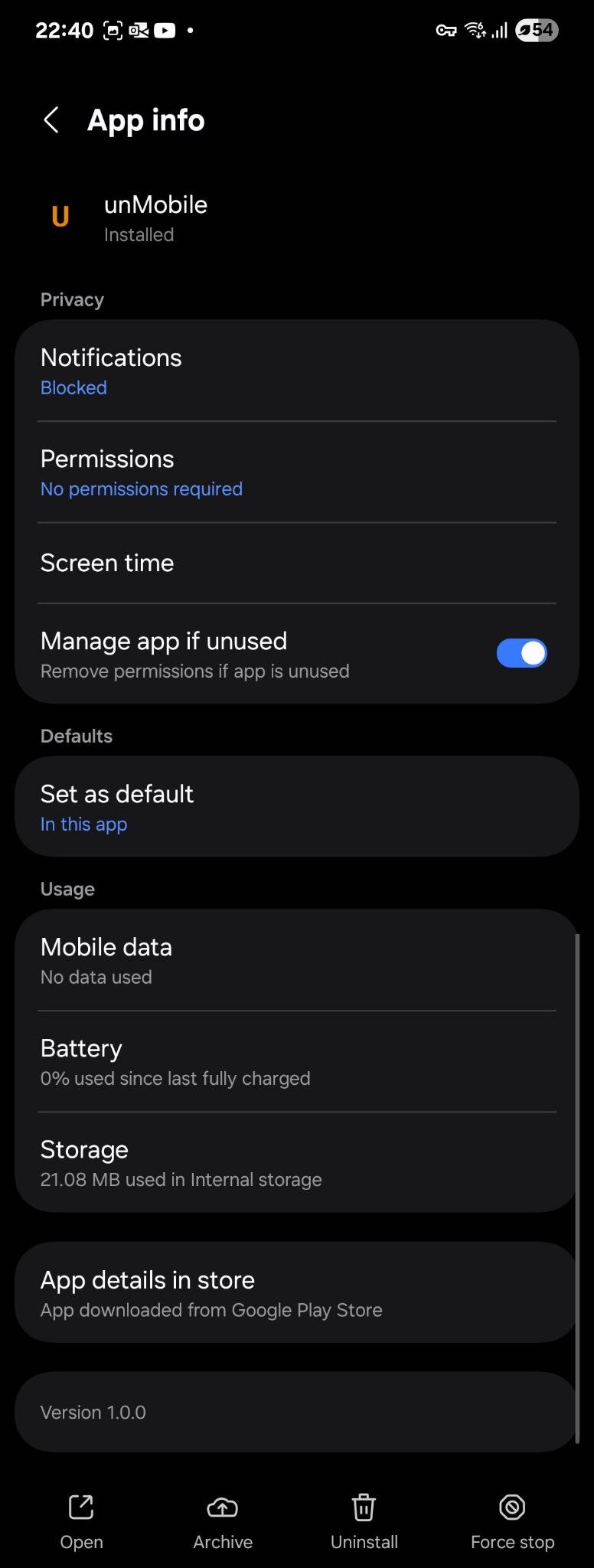

Same for me also on android
Hmm thats strange.. i dont have an android device..
I just got reported that its working fine.
Can you guys please check app settings if theres something to need to be enabled?
There's nothing to enable in the app settings. Can't even turn on notifications as it won't allow me to.

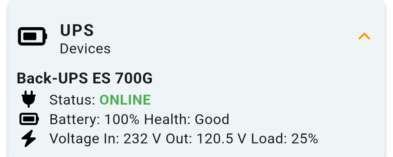

This is wrong.
Out 120,5V? (EU)
Can't find 120,5 anywhere in the "UPS Details" in the web gui.
Edited by Niklas
13 hours ago, Niklas said:
This is wrong.
Out 120,5V? (EU)
Hi!
and thanks for the feedback.
this is not app releated, because the values comes from the api.
would be very cool if you could make a bugreport at @ https://github.com/unraid/api/issues :)
