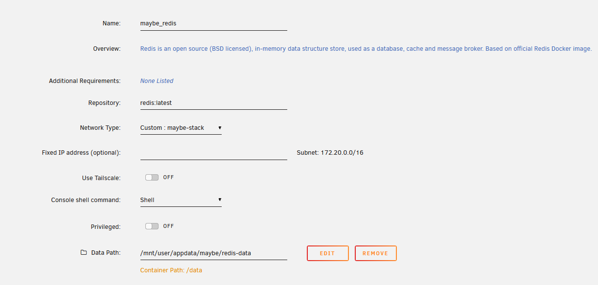

June 4, 20251 yr 2 hours ago, headtrip0 said:Hi, I set up Maybe following your guide, thanks for providing such detailed instructions BTW, however I can not get onboarding to advance past preferences. A blue progress bar appears at the top of the screen after clicking submit but nothing happens after that.Any ideas?One question I did have about the install process is regarding the Redis data path. The container template did not include a path initially so I added it but wasn't sure if /data was the correct container path.Thanks!Update: It randomly worked but I had to refresh the pages a few times and even received a few timeouts (unable to connect) which is not something I have encountered from the webui for any of my other docker containers. I am having this problem frequently as I attempt to navigate around the UI so something seems to be wrong. I was able to find one issue. It looks at though the Maybe-Web container is disconnecting over and over frequently. This is a small example from my unraid logs. When the Maybe-Web container is turned off these messages stop completely unless I start/stop a container so this is ALL from that one container.Jun 4 14:51:16 Unraid kernel: eth0: renamed from vethd4ff049Jun 4 14:51:16 Unraid kernel: br-4a4a323fda54: port 4(vethb269508) entered blocking stateJun 4 14:51:16 Unraid kernel: br-4a4a323fda54: port 4(vethb269508) entered forwarding stateJun 4 14:51:44 Unraid kernel: br-4a4a323fda54: port 4(vethb269508) entered disabled stateJun 4 14:51:44 Unraid kernel: vethd4ff049: renamed from eth0Jun 4 14:51:45 Unraid kernel: br-4a4a323fda54: port 4(vethb269508) entered disabled stateJun 4 14:51:45 Unraid kernel: vethb269508 (unregistering): left allmulticast modeJun 4 14:51:45 Unraid kernel: vethb269508 (unregistering): left promiscuous modeJun 4 14:51:45 Unraid kernel: br-4a4a323fda54: port 4(vethb269508) entered disabled stateJun 4 14:51:46 Unraid kernel: br-4a4a323fda54: port 4(veth99ee0be) entered blocking stateJun 4 14:51:46 Unraid kernel: br-4a4a323fda54: port 4(veth99ee0be) entered disabled stateJun 4 14:51:46 Unraid kernel: veth99ee0be: entered allmulticast modeJun 4 14:51:46 Unraid kernel: veth99ee0be: entered promiscuous modeJun 4 14:51:48 Unraid kernel: eth0: renamed from veth70fbfbcJun 4 14:51:48 Unraid kernel: br-4a4a323fda54: port 4(veth99ee0be) entered blocking stateJun 4 14:51:48 Unraid kernel: br-4a4a323fda54: port 4(veth99ee0be) entered forwarding stateJun 4 14:51:56 Unraid kernel: br-4a4a323fda54: port 4(veth99ee0be) entered disabled stateJun 4 14:51:56 Unraid kernel: veth70fbfbc: renamed from eth0Jun 4 14:51:57 Unraid kernel: br-4a4a323fda54: port 4(veth99ee0be) entered disabled stateJun 4 14:51:57 Unraid kernel: veth99ee0be (unregistering): left allmulticast modeJun 4 14:51:57 Unraid kernel: veth99ee0be (unregistering): left promiscuous modeJun 4 14:51:57 Unraid kernel: br-4a4a323fda54: port 4(veth99ee0be) entered disabled stateJun 4 14:51:58 Unraid kernel: br-4a4a323fda54: port 4(vethb50d1af) entered blocking stateJun 4 14:51:58 Unraid kernel: br-4a4a323fda54: port 4(vethb50d1af) entered disabled stateJun 4 14:51:58 Unraid kernel: vethb50d1af: entered allmulticast modeJun 4 14:51:58 Unraid kernel: vethb50d1af: entered promiscuous modeJun 4 14:52:01 Unraid kernel: eth0: renamed from veth1f5edadJun 4 14:52:01 Unraid kernel: br-4a4a323fda54: port 4(vethb50d1af) entered blocking stateJun 4 14:52:01 Unraid kernel: br-4a4a323fda54: port 4(vethb50d1af) entered forwarding stateJun 4 14:52:05 Unraid kernel: br-4a4a323fda54: port 4(vethb50d1af) entered disabled stateJun 4 14:52:05 Unraid kernel: veth1f5edad: renamed from eth0Jun 4 14:52:06 Unraid kernel: br-4a4a323fda54: port 4(vethb50d1af) entered disabled stateJun 4 14:52:06 Unraid kernel: vethb50d1af (unregistering): left allmulticast modeJun 4 14:52:06 Unraid kernel: vethb50d1af (unregistering): left promiscuous modeJun 4 14:52:06 Unraid kernel: br-4a4a323fda54: port 4(vethb50d1af) entered disabled stateJun 4 14:52:07 Unraid kernel: br-4a4a323fda54: port 4(vethed2487d) entered blocking stateJun 4 14:52:07 Unraid kernel: br-4a4a323fda54: port 4(vethed2487d) entered disabled stateJun 4 14:52:07 Unraid kernel: vethed2487d: entered allmulticast modeJun 4 14:52:07 Unraid kernel: vethed2487d: entered promiscuous modeJun 4 14:52:10 Unraid kernel: eth0: renamed from veth416ec6eJun 4 14:52:10 Unraid kernel: br-4a4a323fda54: port 4(vethed2487d) entered blocking stateJun 4 14:52:10 Unraid kernel: br-4a4a323fda54: port 4(vethed2487d) entered forwarding state Edited June 4, 20251 yr by headtrip0 Adding additional detail.
June 5, 20251 yr Author Hey @headtrip0 , Sorry it didn't work smoothly! This log tells me that the container itself keeps crashing and restarting. In the container settings, under advanced, you can remove --restart unless-stopped from the extra parameters line, this will clear up this spam from your Unraid logs. You are correct that the container path for Redis is /data . If you provide the logs from the docker container itself I may be able to help figure out what is causing it to crash repeatedly. If the logs button for the container isn't working you can access specific container logs by running docker logs maybe_web in the Unraid console (maybe_web will be case specific to your name).I have also heard of Unraid not checking for conflicting ports when one is in a custom network, which leads to similar connectivity issues, please confirm you have no other containers exposing the same port (3000).

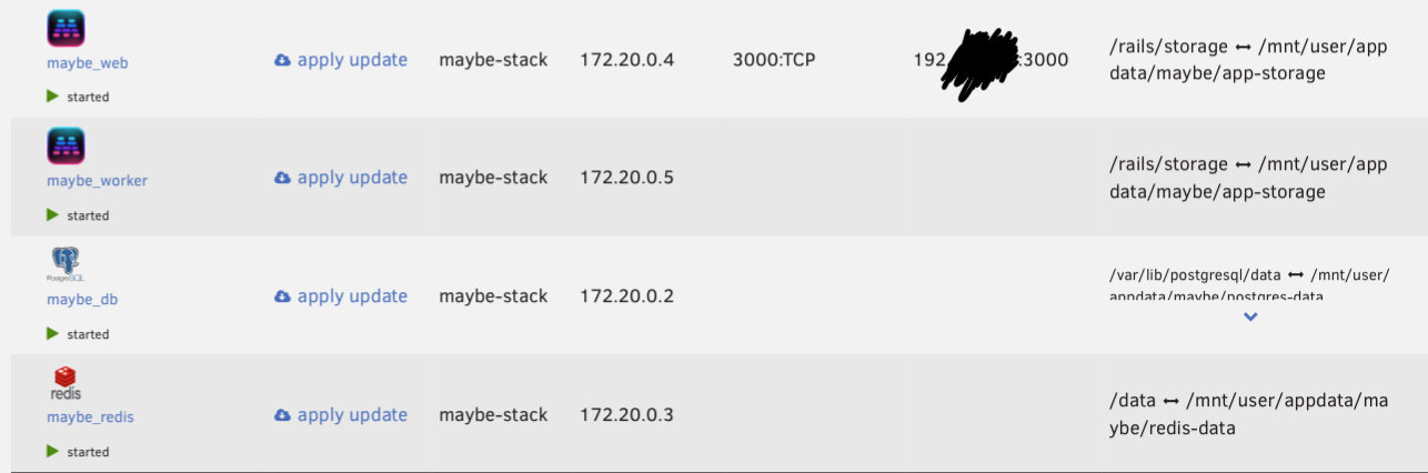

June 30, 20251 yr Hi and sorry for taking so much time to answer! You know life do things.. good things but cant find time..I just checked the logs again for all four parts of maybe and have a sreenshot of these from the docker tab. I've checked the Maybe docu to look for something but I guess I dont know enought to understand what those logs wnat to say me^^It feels like im throwing my homework to you to get it done but I appreciate you to show and teach me something so i can solve more and more my self!
June 30, 20251 yr Howdy, I've got this working well except for Enable Maybe AI. I've set my OPENAI_ACCESS_TOKEN and entered the correct value but the app still complains about needing this key in order to make use of AI. Any help would be much appreciated.

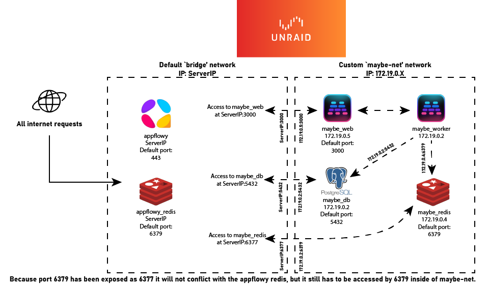

July 1, 20251 yr Author @exputesco No worries! Hopefully we can solve this and then it won't be a problem for the next person! :) I looked through your logs and your database and redis look to be running perfectly!It does look like the issue is still with how your Maybe_Web and Maybe_Worker are reaching Redis, I am finding this in the Maybe_Worker logs Connection refused - connect(2) for 172.19.0.4:6377 (redis://maybe_redis:6377/1) . I may have been mistaken about how local dns works in custom docker networks... 😅. I think that Maybe is not seeing your custom defined port at all, only docker containers outside of the network see the custom number. I have made a small diagram about how this works, happy to clarify if it doesn't make sense, I will add to the guide if helpful! (Appflowy is used as an example app that would have another redis container.)Setting your Redis port in the Maybe_Web and _Worker containers to the 6379 value in the column should fix your issues. Apply in both containers and see if you get past the redis screen of the app.If the app is now working, and you don't need access to the DB or Redis in the bridge network, you can remove the port like in the config below. Edited July 1, 20251 yr by dkeners
July 1, 20251 yr Ahh ok. so it was my understanding of the custom networks! Thanks allot it seems to work!!For the guide is maybe a note that subnets/customnetworks are that way, or im one of the few not knowing that^^ Thank you again that will help my selfhosting journey for ever!! :)
