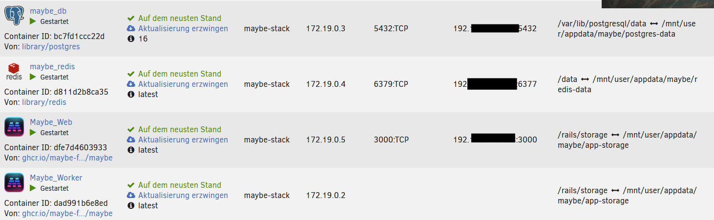

  8. Hi and sorry for taking so much time to answer! You know life do things.. good things but cant find time.. I just checked the logs again for all four parts of maybe and have a sreenshot of these from the docker tab. I've checked the Maybe docu to look for something but I guess I dont know enought to understand what those logs wnat to say me^^ It feels like im throwing my homework to you to get it done but I appreciate you to show and teach me something so i can solve more and more my self!

  10. Hi @dkeners , thank you for responding! I tried a few configs on the network side, but you are right the container comes the farest with redis://maybe_redis:3677/1 but the WebUI shows: "Redis Configuration Required Your self-hosted Maybe installation needs Redis to be properly configured." At leased its not crahsing^^ The port is changed becaus redis is already running for differend apps. I thing you have to install a Redis instance for every app that needs one right? I thought changing ports is no problem as far as they are equal? The Worker is charshing no matter what i enter in the template.. could that be the problem?
