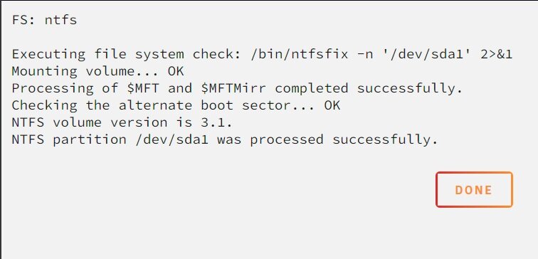

  12. So I did try rebooting with the internal drive unplugged and reformat the internal drive using UD. Neither solution worked. It would seem my last option is probably to move my files off the external, format, then move them back. Is it possible the problem I'm having is due to the external being formatted to ntfs instead of xfs?
  13. This is what the external that won't mount after a reboot reports.
  14. External had no errors. The internal reported errors. It attempted to fix. Did a reboot. Still not mounting the external. Ran the check again on internal. Still errors so I did the extra step (forgot what it was called) and that fixed it. Rebooted. Still won't automount the external. I'll probably do your suggestions slightly out of order because I don't have anything critical on the internal one so I'll probably just format and see if that fixes the issue without disconnecting it.
