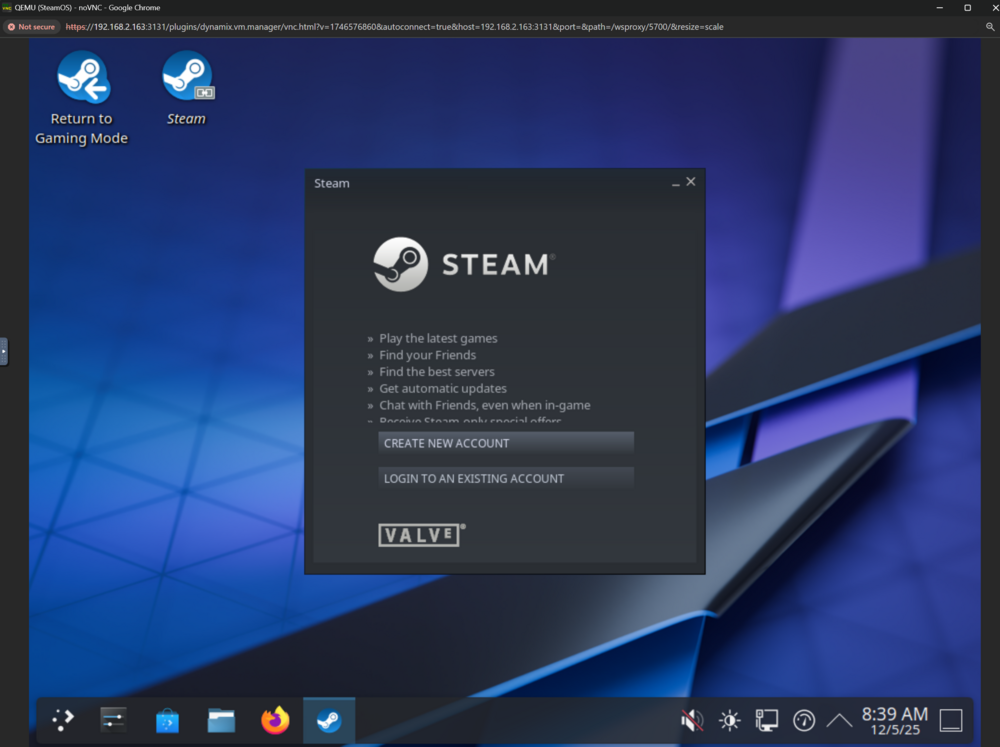

Hello )
This maybe the first ever post I can help.
(1) Download image
(2) WinRAR extract img file
(3) Use Rufus to flash USB - on the img is 5 partitions.
(4) Plug into UNRAID
(5) Mount - not my 5th partition would not mount (to check if this is a problem with the USB)
Partitions
1 - esp vfat
2 - efi vfat
3 - rootfs - btfs
4 - var - ext4
5 - home - ext4 (unmountable?)
(6) In terminal type: ls -lha /dev/disk/by-id/
(7) Find usb-Kingston_DataTraveler_3.0_60A44C426518BEA0DB429420-0:0
lrwxrwxrwx 1 root root 9 Dec 5 14:50 usb-Kingston_DataTraveler_3.0_60A44C426518BEA0DB429420-0:0 -> ../../sdx
lrwxrwxrwx 1 root root 10 Dec 5 14:50 usb-Kingston_DataTraveler_3.0_60A44C426518BEA0DB429420-0:0-part1 -> ../../sdx1
lrwxrwxrwx 1 root root 10 Dec 5 14:50 usb-Kingston_DataTraveler_3.0_60A44C426518BEA0DB429420-0:0-part2 -> ../../sdx2
lrwxrwxrwx 1 root root 10 Dec 5 14:50 usb-Kingston_DataTraveler_3.0_60A44C426518BEA0DB429420-0:0-part3 -> ../../sdx3
lrwxrwxrwx 1 root root 10 Dec 5 14:50 usb-Kingston_DataTraveler_3.0_60A44C426518BEA0DB429420-0:0-part4 -> ../../sdx4
lrwxrwxrwx 1 root root 10 Dec 5 14:50 usb-Kingston_DataTraveler_3.0_60A44C426518BEA0DB429420-0:0-part5 -> ../../sdx5
(8) In SteamOS VM template; I used OVMF for bios
(9) In SteamOS VM template; add a second vdisk, select manual and type: /dev/disk/by-id/***copy the device in step 7 and dont include these 6 stars***
(10) Ensure usb devices you have not selected the USB
(11) Select virtual; note I found the RTX3060ti sluggish; VNC worked better for the install.
(12) Run steamOS template
(13) At shell type exit to go into boot manager
(14) Select "UEFI Misc Device"
(15) SteamOS installer boots
(16) At GUI select Wipe Device & Install SteamOS icon
At this point I had issues with "NVME" - if you have passed through a NVME you will unlikely have this issue, if you have a vdisk like me.
(A) Force Stop VM
(B) Into the template, select XML.
(C) Under the vdisk (not your USB) - change <target dev='hdc' bus='sata' rotation_rate='1'/> to <target dev='nvme0n1' bus='nvme'/>
(D) delete the <address type='pci'> under vdisk1.
(E) Save and restart the SteamOS
(17) Select "Wipe Device Device & Install SteamOS icon
(18) With the format caution, click proceed.
(19) Click proceed to reboot after "Reimaging Complete"
(20) Enter username, password and steam guard.
(21) Hit shutdown to shutdown VM, configure GPU in VM template. Remove rufus steam.img USB - I used a NVIDIA RTX3060ti
(22) Restart VM
(23) When booted open Konsole type "flatpak install flathub org.mozilla.firefox"
(24) Once downloaded type "flatpak run org.mozilla.firefox"
You have to set a admin password to unlock read-only, enter console and type: passwd
if you have locked yourself out you will need to reboot, and do the next steps otherwise ignore.
Goto "Terminal with repaire tools" and type:
sudo ~/tools/repair_device.sh chroot
rm -f /var/lib/overlays/etx/upper/passwd
rm -f /var/liv/overlays/etc/upper/shadow
then reboot removing USB. Goto Settings > User and set password
(25) Type sudo steamos-readonly disable
(26) Type sudo pacman-key --init
(27) Type sudo pacman-key --populate archlinux
(28) sudo pacman -S archlinux-keyring
(29) For nvidia: sudo pacman -S nvidia nvidia-utils nvidia-settings
(30) hit proceed with installation
(31) sudo reboot
After this point I just got a black screen, so went back to VNC.
No matter what I did I could not progress.
I gave up with the NVidia 3060ti, and used my Arc - it worked.
