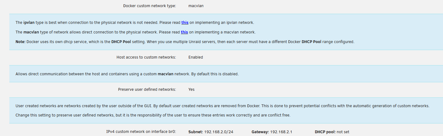

Docker settings:

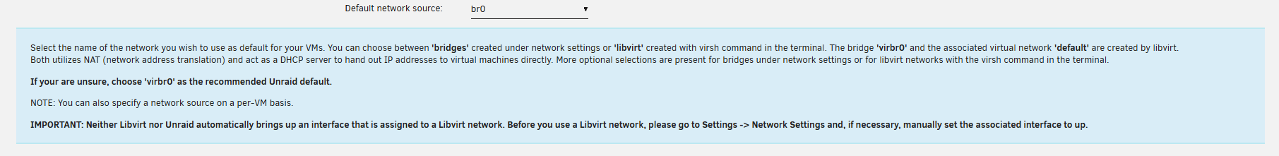

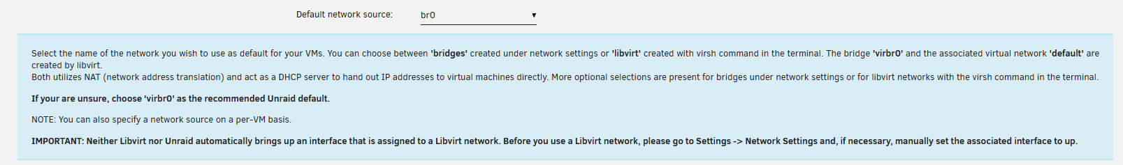

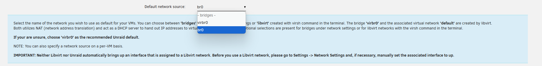

VM Settings:

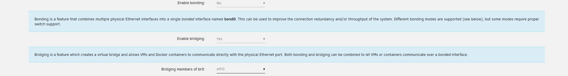

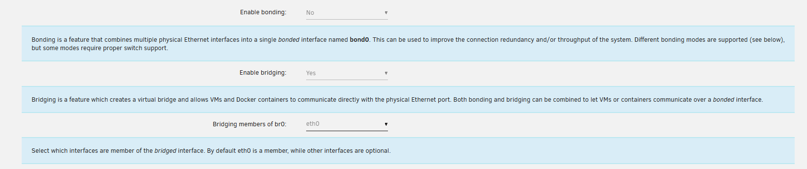

Unraid Network settings (Default Bridging on, bonding off)

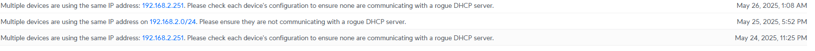

I suspect that we are seeing the same issue. So far, I have found one other besides myself and this post.
https://forums.unraid.net/topic/190305-712-docker-vlan-host-comms-broken/
In my case, nothing was changed in the networking or Docker config prior to or following the 7.1.1 or 7.1.2 updates, and it has been working with the same configuration since 6.12.

NO, the script is messing with the network interfaces no the docker networks driver.(doent' matter if its ipvlan/macvlan....).. While it may affect how the docker driver uses the network interface...
While it will work with ipvlan its really meant for macvlan due to how the interface use the mac address.
macvlan will randlomy make a mac address
ipvlan will reuse teh eth0/br0 mac address

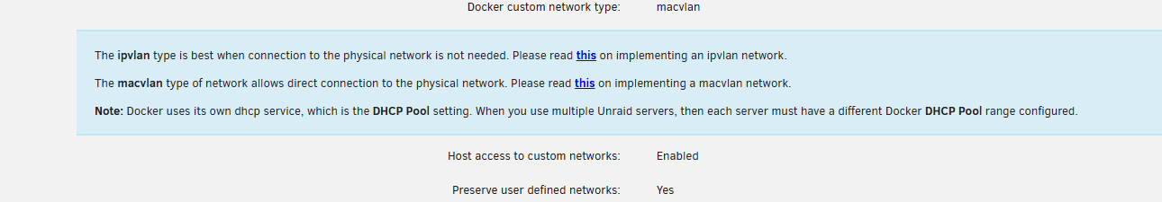

some more info on the docker networks...
with tips and tweaks plugin giveing some nice notes to some settings:
The ipvlan type is best when connection to the physical network is not needed. Please read this on implementing an ipvlan network. https://docs.docker.com/engine/network/drivers/ipvlan/
The macvlan type of network allows direct connection to the physical network. Please read this on implementing a macvlan network. https://docs.docker.com/engine/network/drivers/macvlan/
Note: Docker uses its own dhcp service, which is the DHCP Pool setting. When you use multiple Unraid servers, then each server must have a different Docker DHCP Pool range configured.
Your unraid settings look good. moving into the script:

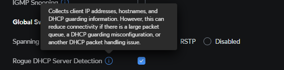

step 3 assign a static ip to the vhost/shim bridge interface (I do this to remove the same ip assigned that it gets from the br0 at eth0 creation

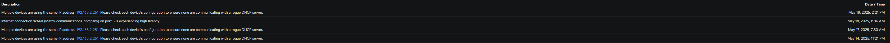

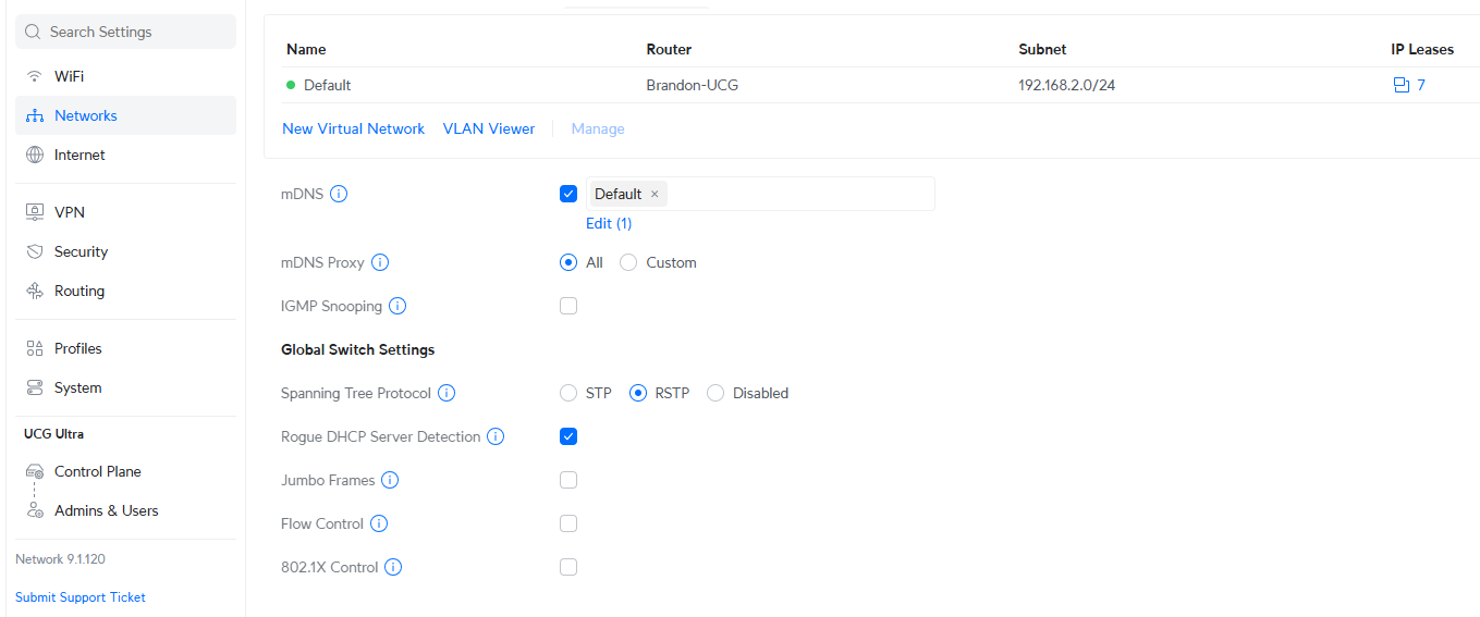

- as this make a duplicate mac taht can be flaged asa  rouge dhcp as 2 ip are on 2 different mac address!...

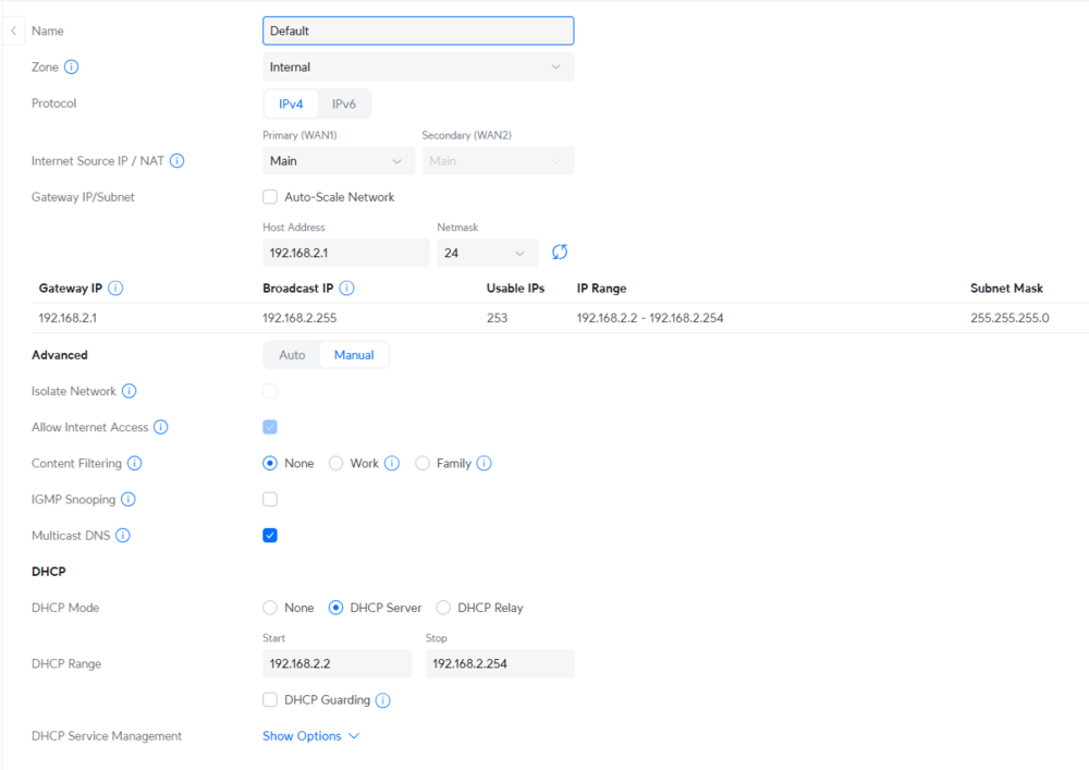

btw. this is my current routing table:
2025-05-1815_17_09-HomeServerCS_NetworkSettings.thumb.png.a0a3912667b31c4ed83d1672ee463d63.png
thank you for your help!

as noted in the programing scripts chat. this is a known issue with how linux network bridges are made and the over security in unfi equipment
hoard to exaplin depends on unif settings. It would be the host network and may be a vlan network depending on your setting and how you have unraid netwroking setup.
the option that flags this in unifi is rouge dhcp server.
this is due to first bridge creation it wil not make a endpoint on itself and will reuse the orginral interface
defualt unraid eth0 will make a br0 interface
br0 is then softwre shim bridge made for the ip[vlan/macvlan network.
the shim-br0 (or vhost0) interface is a bridge on a bridge and how the setting was passed is simlar to what it did to eth0
as eth0 is assigend ot the bridge interface the ip if set static or vlan if set on the interface gets assinged to br0 interface.
to make the docker network another bridge was called to br0 and it duplicated instead or replacing the interface of the netwrok.
SO for me
I don't run vlans.. I run unifi

to assing a static ip onthe same subnet as eth0 which is not br0 with default unedided unraid network settings...
this way teh other side of teh brdige doen't keep ping unifi taht the same IP is on 2 seperate mac address and using the same ip...
as each reboot the dam mac address chages... so i had to edit it at the unriad linux level...
more do to a unfi setting and other internal route that unifi does:
this also can fix some docker bridge setting and defines the docker network as its own lan idenity setting a seperate non unraid ip
(more for leverage 2 ip address to talk to teh docker network bridge.) but that other advance linmux shanagins like on linux iptable using 2 ports for the same service... FUN wiht IPTABLEs...

Settings docker:
I recomend mobing into macvlan as you want seperate macs as ipvaln will duplicate the same interface mac casuign other lan identity issues latter...
then making a docker netowrk targeting the interface with vlan example br0.2
with macvlan, preserve and a docker newtok crate comand that will s8rvice a reboot (as the data exist within the docker vdisk image in a database file...)
that docekr even though it was told its parent interface is br0.2 will still ataemt to connect over the shim-bridge...
even VM settign play a roll

Make sure this is not the setting virbr0...
Chose the interface be it eth0, br0, bond0

I also assume you have bridging off and bonding off as I don't see a br0 interface

What are your unRAID settings.

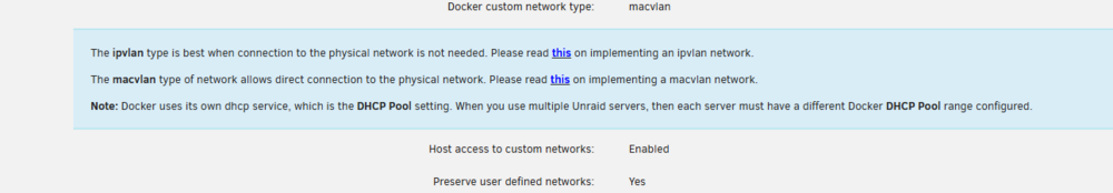

VM network not virbr0
Docker setting network allow host access
?macvlan/ipvlan
unRAID interface settings bridge off, bond off?
Router you use ipv6 via slack? RA is needed then ... For some reason I road won't flag having a DHCP ipv6 using slack DHCP with our ra enabled ...
I can guarantee unRAID with my inifo networks setups and testing... I Find it better with bridge on bond off
Macvlan with host access to network enabled
Vmbir0 not enabled for VM
This makes a shim br0
Thank you @bmartino1 , here is my settings

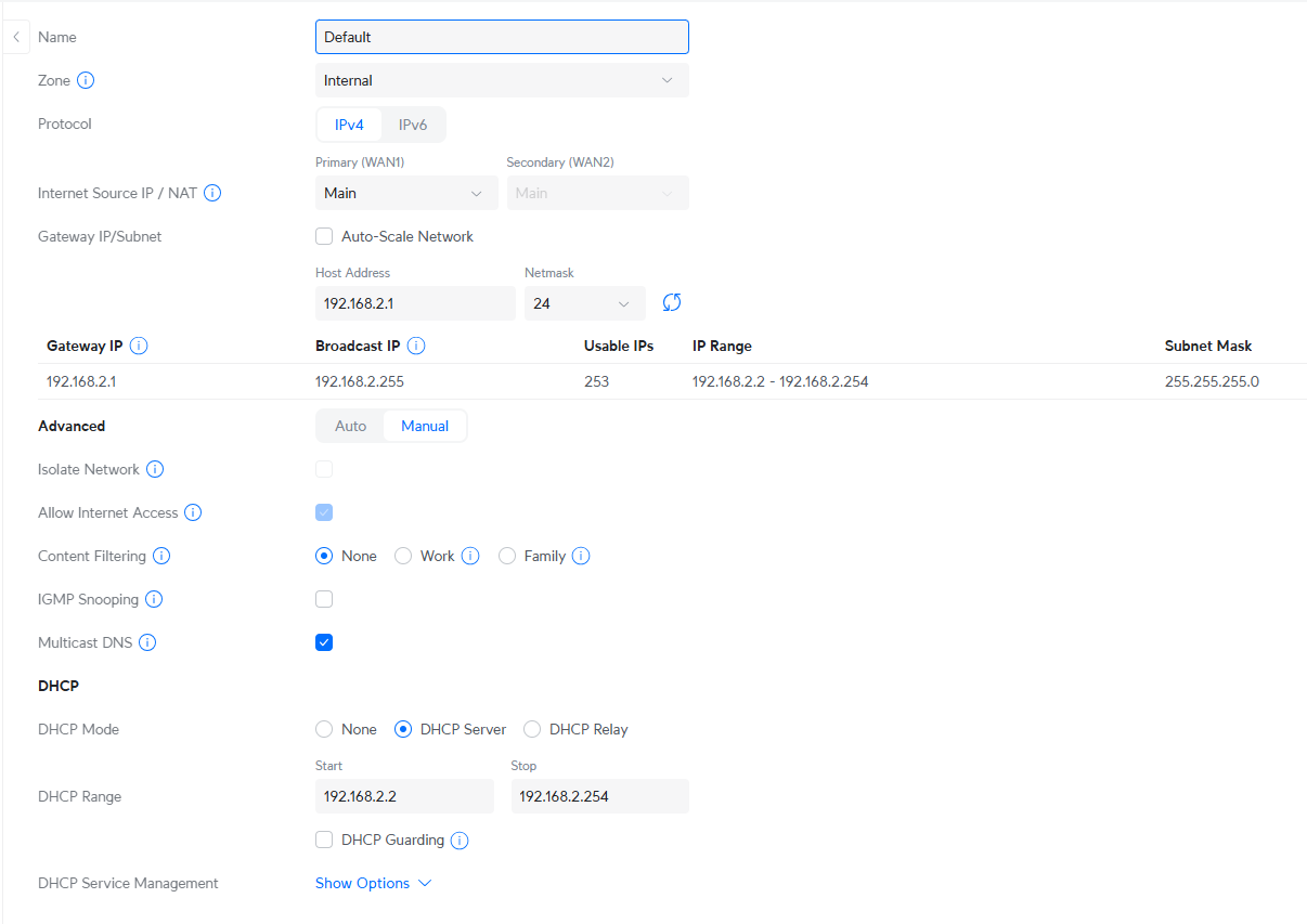

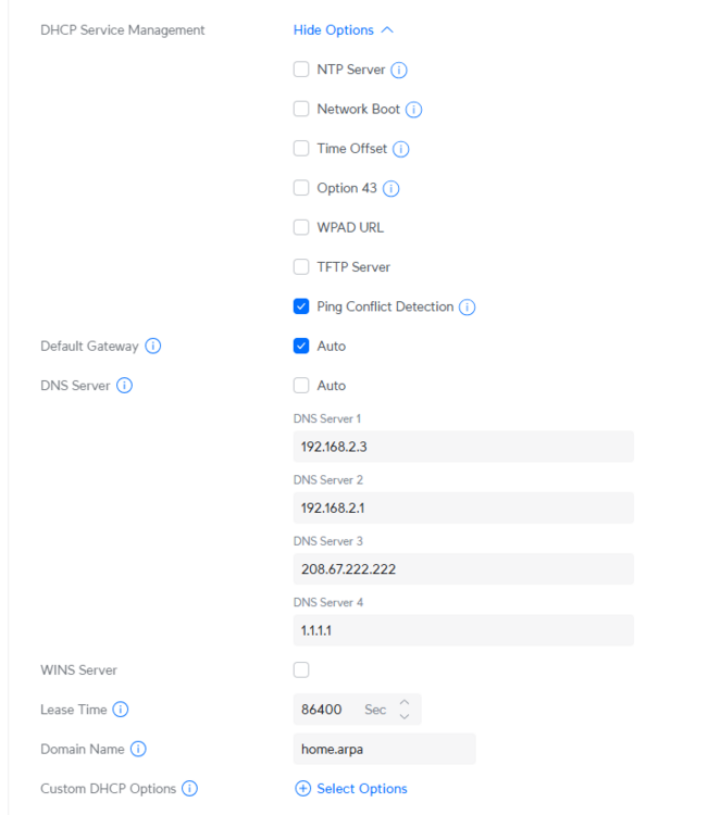

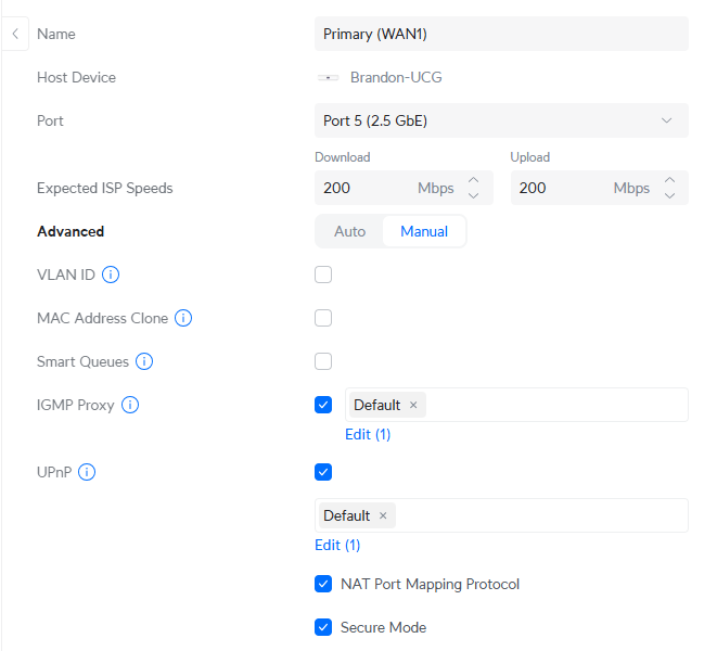

Here what I run at home...

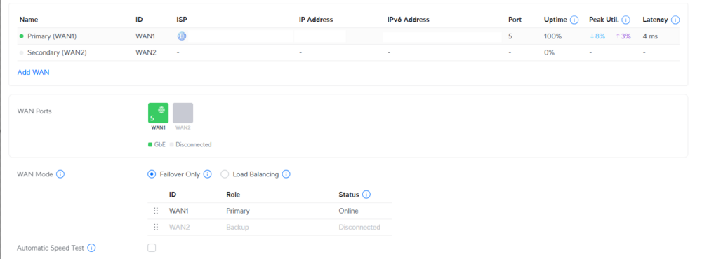

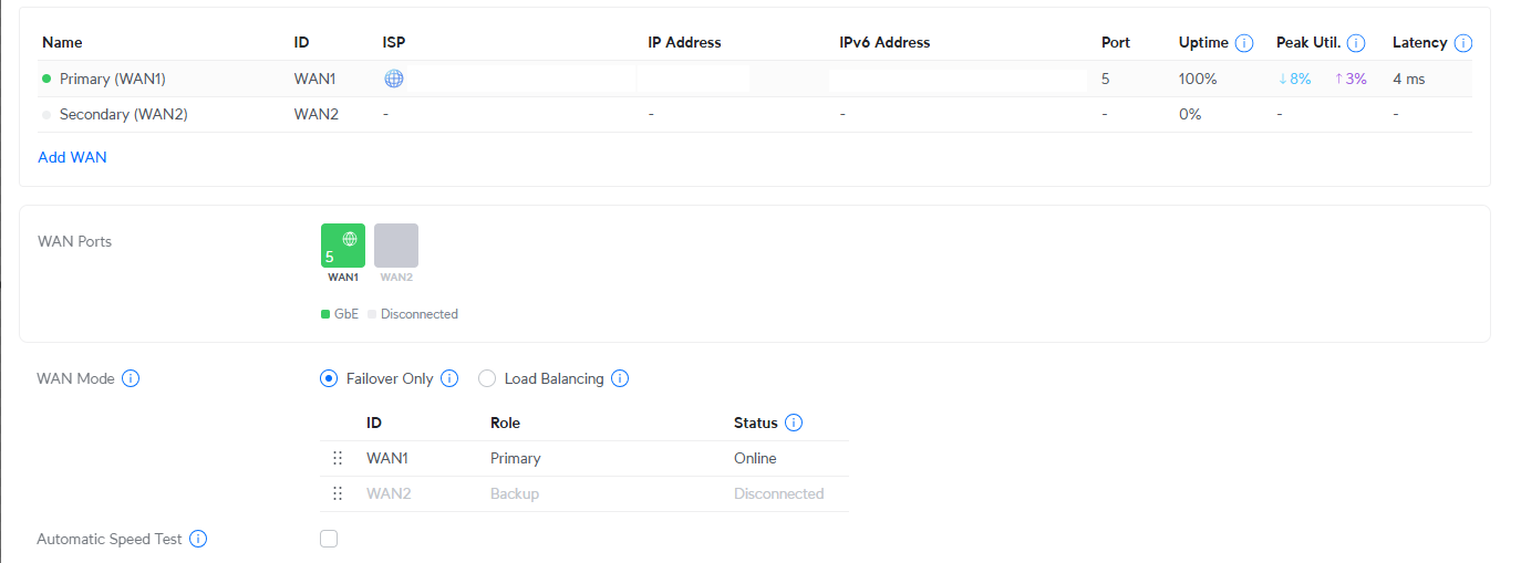

go to gear settings. Lets take a look at the internet settings.
The UCG has the ability to have a second wan... I only use the 1 2.5 GB for my fiber ISP providers.
Depending on your ISP your Provider may give you a IPv4 and a IPv6
most communications and network setups latter will require what your ipv6 address is.
For security I have removed my ipv6, ipv4 and isp provider...
so lets click on primary and setup so settings...
Here I have UPnP and NAT enabled. (for security it advised you turn of UPnP
(since this is my test net I have it on for testing as some standard routers run similar settings)
Note the IGMP Prosy and the circle with a "i" read the info on settings you don't understand
My Provider offers iptv for their cable package with internet.

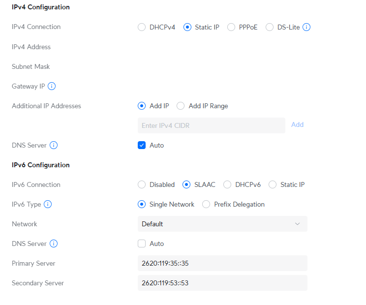

My Provider technical done't server ipv6 address. I have a cgnat ipv4 address for my connection with fiber.
I pay for a static IPv4 address due to work and other server I run from my homelab

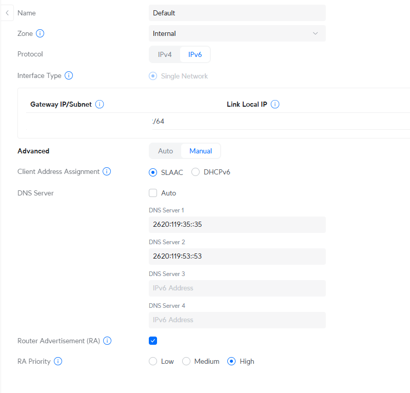

Since I don't have a IPv6 public IP I can still setup and use ipv6 on my lan DHCP network.
Companies like Comcast, Xfinity, mediacom in the USA give both a ipv6 and ipv4 in which case I would recommend you run DHCPv6
as this can affect lan settings latter.
Here I set my ipv6 dns on the WAN port to opendns Cisco ipv6 address.
-OpenDNS utilizes the following IP addresses for its DNS servers: 208.67.220.220 and 208.67.222.222
support recursive IPv6 DNS resolution and security filtering for IPv6 traffic. Our IPv6 DNS server addresses are: 2620:119:35::35 and 2620:119:53::53
more info here:
https://adguard-dns.io/kb/general/dns-providers/
If I'm running Vlans, I may have more networks outside the default. In which I would switch to Prefix Delegation. I have yet to see the need to run Vlans in a Home Lab. While useful to separate traffic. Its not worth the headache to get cross talk and other setting setup...
?DO YOU HAVE VLANs?
  • As this will dictate other unraid settings...
With general start of IPv6 out of the way with unifi equipment...
Lets take a look at networks...
Note the mDNS setting and Rouge DHCP server Detection.
The mDNS is avahi that Unraid is also pre packaged with... This can get in the way or assist with Vlans and with "chrome cast" devices...
Most generic home routers run avahi zero conf without additional settings for their dhcp networks. (More a Unix / Apple and some linux additional settings)
This can affect dns / netbios and other machine name access xyz device latter.
UnRaid do to its inet.rc script at boot makes a br0 network of the eth0 interface with the settings marked above when docker loads its network it also makes a bridge network interface but gets flagged and bridges off br0
Thus, the name shim-br0 as it shims a bridge network over a bridge network interface. Thus, due to what the inetrc script is told the ip of br0 is that of eth0 the initial ip route and default interface UnRaid uses for networking.
Due to shim brdige it also grabs the same IP but is at a different Mac address.
This creates the error in unifi:
You can ignore this, or turn off a security feature in unfi or, edit unraids shim-br0 network interface IP address.
as a bridge has 2 IPs the starting side (br0) and the other side (shim-br0). From What I can tell this is essential from Limetech due to a one size fit all shoe as most end users are not running network enterprise equipment and will never see this issue or error as the ip for both interfaces are the same. so I treat shim-br0 since its the docker network for unraid as a service that needs its own lan Identity meaning my unraid host is set to 192.168.2.251 where I need the shim-br0 at a different mac address to be at 192.168.2.250...
--This makes a mess of the unifi client device list for other edits such as IP and hostname static sets... (especial at reboots of unraid where it make a new random mac address)
SO! You can turn off Rouge DHCP Server Detection which will stop the error or run a unraid script to change the ip address of unraid which is what the script does. Thus moving the ip the docker network uses and makes unifi happy. (as their are 2 ip address with 2 different interfaces with different macs.... usually br0 duplicates the mac of eth0 where shim-br0 attempts but since its a software macvlan tap it randomly assign shim-br0 mac address. thus make extra entries in unifi and flagging that ip as duplicate due to 2 ips on the same mac. While going to the same interface, this cause network communication issues...
The only fix I found when running unifi equipment is to edit unriads shim-br0 / vhot0 interface to a different IP which is what the script does...
example above

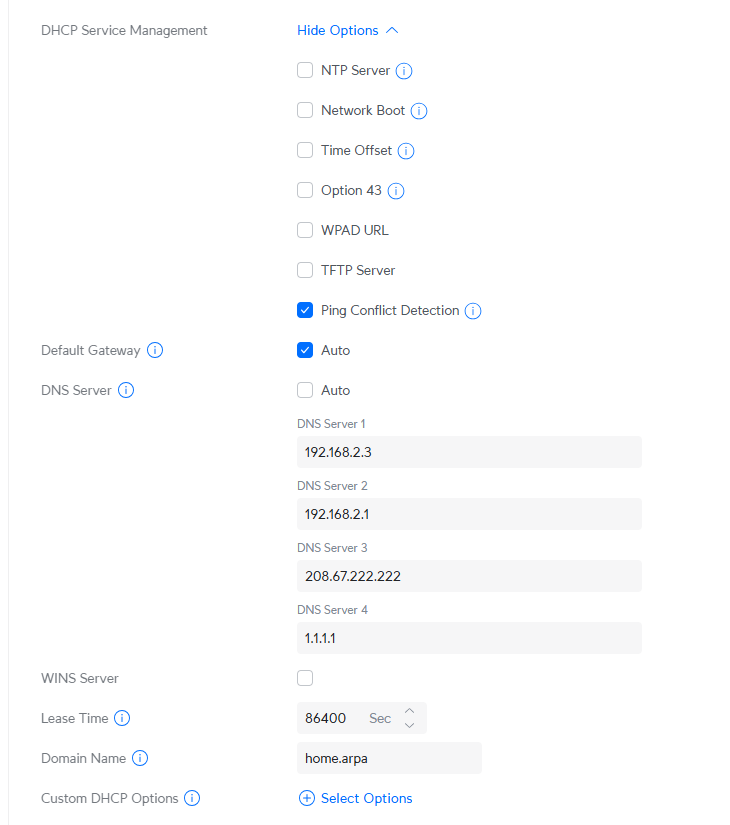

so with that lets take a look at unifi defeat network... Especial with ipv6 as I'm using slacc ipv6 and unraid doesn't like that... Most ipv6 dhcp server that use slacc will not advertise a ipv6 without a setting "RA" route advise... (More a android phone ipv6 connection issues as android don't get ipv6 address without slacc...) - Data throughout the forum form bug reports to other passign communications...
Unifi Networking settings are fairly straight forward in the settings group. by default unifi is set to auto mange these settings. I went manual as I've set these up for ISP over the years... Not a professional installer, just what the ISP company I worked for used...
Since this network is a internal network I use for testing as usualy the default network is 192.168.1.x
This equipment is on subnet 192.168.2.x so its runs a 192.168.2.x dhcp server device in this network receive a 192.168.2.x address
I went manual as unifi by default may have this set to auto for you. But you may want to run something like pihole or adblock home as a dns server and protect the entire network...
you can do this by click show options
Note the additional options... You may need to alos turn off ping confit detection along with rouge dhcp to stop unraid log errors in unifi...
I set my dhcp dns settings to use 192.168.2.3
as in this test net
192.168.2.1 is unfi - the brandon-UCG equipment
192.168.2.2 is my ac-pro the wifi device for this test net...
thus the net network device IP availbe is 192.168.2.3 so I run a dns server
-this get weird when running ipv6 as "RA" can overwrite your custom static ipv4 dns servers, thus defeating the use and purpose of running adblock home or pihole...
-Noe the Domain Name. This sets the search domain for your network some default may be local localdomain lan etc... so a machines FQDN or full machine name would be hostname.searchdomain
In my dockers I use the extra parm options to assit unifi and static graps this also means on my network i can go to dockername.home.arpa
so plex.home.arpa is my FQDN of my plex docker...
I use .home.arpa due to IEEE and RFC standards.... .local is Apple linux and avahi zerconf network setups... unriad by default will also use .local and settings can be found in setting > management
Note that theses setting will need to match to fix samba machine names...
why .home.arpa:
https://www.rfc-editor.org/rfc/rfc8375.html
https://www.iana.org/domains/arpa
For me this is due to .local in else upstream and crossing subnets...
so without ipv6 land DHCP this sets my ipv4 address and give machines a 192.168.2.x in the .hom.arpa subnet for FQDNs...
Lets review ipv6... especial if I want my docker networks to use ipv6 confirmed via docker network inspect commands...
With theses IPv6 unfi commands I was finally able to get unraid to get a unifi dhcp lan ipv6 address vial SLACC and RA...
RA can and will overwrite and set your rotuers ipv4 dns... as you want your ad block dns of pihole or adguard home to be the first and main ip that the dhcp give out to enable full network blocking!!!
To acomplish this TURN OFF DNS SERVER AUTO!
a IPV6 dns server then needs set I used opdns cicso ipv6 dns servers.
Slacc requires RA. with that unraid will now get a ipv4 and ipv6 address for network comunications...
Unraid by default doen't enable ipv6 forwarding for dockers another script is needed to add system ctl comand to enable ipv6. however, unraid does run ipv4 forwarding automatically...
thats its Ths is why I find endusers issues more to do with unraid and docker netwrok miscomunications... Unriad doen't make it simple and as its mutable it can be hard to setup a patch/fix/workaround that doen't break ...
As this is more a Unifi Network setup issues as this isn't found in normal endusers network setups. You would need to ensure you either setup you unifi enterprise equipment to act as a home router woul or edit machine network settigns to conect with how you run your networl
This is a very detailed answer, thanks a lot! Here some screens of my unifi configurations
My provider does give Ipv6 addresses, no need to hakky that part
I have the DNS servers pointing to 2 pihole-unbound instances (one on the unraid itsself, one on a second unraid server)
I don't have any "special" need from unraid, I just need some containers to sit on their own IP, nothing more
