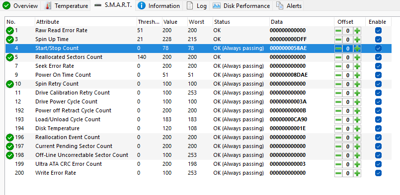

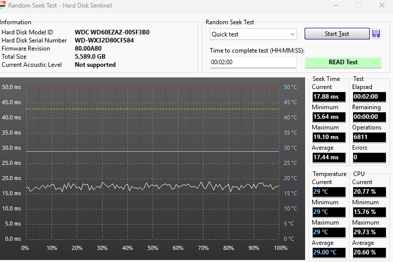

Hard Disk Sentinel reports zero errors under a random seek test.
S.M.A.R.T. reports no errors.
Short self test successful.

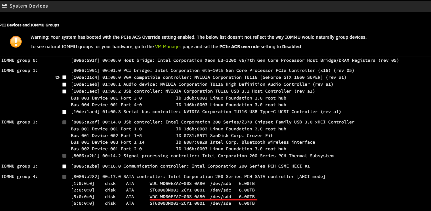

When plugging it back into my Unraid box, I thought to check 'system devices', and it looks like it appears there. Is this good news?
I have no idea where to go from here. I'd really appreciate any help!

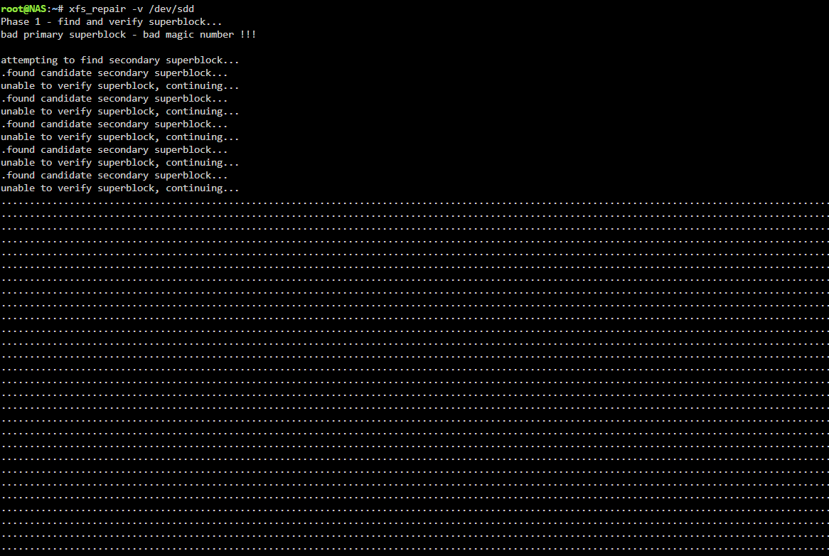

So I've been reading other threads, and I ran xfs_repair -v /dev/sdd
This is what it spits out:
Apparently this means the filesystem is corrupted.
Is this fixable? If so, how?

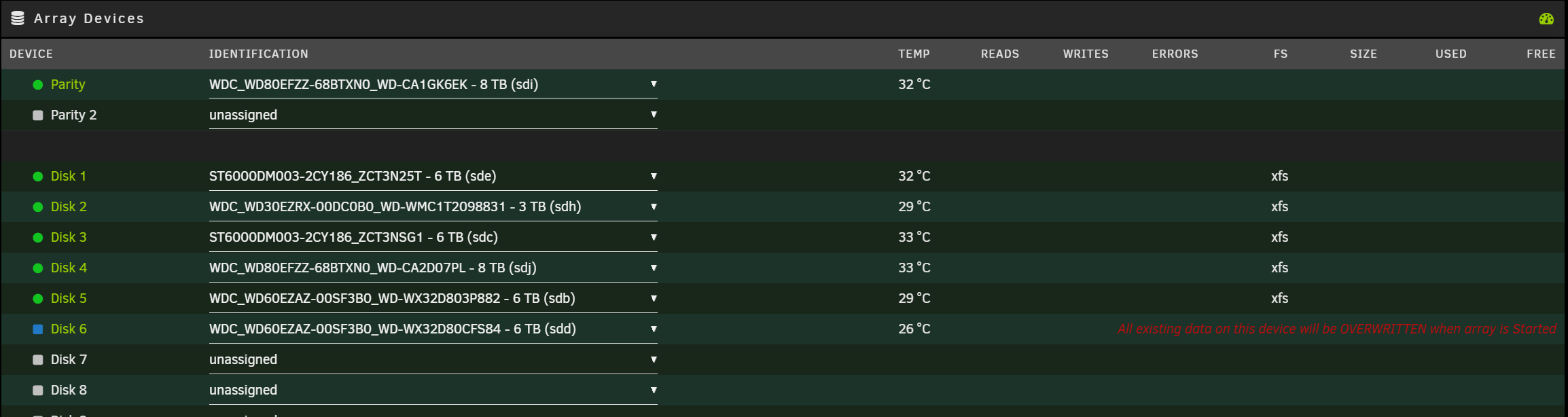

Update:
I stopped the array, then I removed the disk from the array, started the array again, and then it appeared in my unassigned devices (with an option to mount). I then stopped the array again and assigned the same disk back to the array, however there's a message saying 'All existing data on this device will be OVERWRITTEN when array is Started'. If the data is erased, will it be restored via parity? I just want to make sure because I don't want to permanently lose the data on the disk.
To be clear, I haven't changed or written any files to the disk manually when I attached it to the SATA caddy.
Am I safe to continue?
Edited by Corvus
