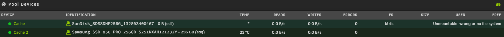

May 23, 20251 yr Hey guys,All of a sudden, my server which has been running fine for 5 years decides to spit this error at me.Both disks are in a shared pool in RAID0.I've tried the advice in this thread here:Cache: Unmountable: Unsupported or no file system (after update) - General Support - UnraidHowever, when I go to restart the array after removing the drives from the pool, it says 'Wrong pool state: Cache - too many wrong or missing devices'.I'm freaking out because I know I've got my Plex database stored on my cache and I don't want to lose it for all my remote users.I've attached my diags.What should I do? Are there any steps I should be taking now to recover/backup things ahead of any solution?I'm not very good with Linux/Unraid, so please explain like I'm 5.nas-diagnostics-20250523-2017.zip Edited May 23, 20251 yr by Corvus
May 23, 20251 yr If the pool is raid0 you cannot mount it with a missing device, there are constant errors with cache1, replace its cables and post new diags and the output from btrfs fi show

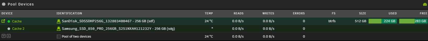

May 23, 20251 yr Author 1 hour ago, JorgeB said:Open a terminal window in Unraid and type that command, then post the results.Ok, I replaced the cable (literally the hardest thing ever to do in that case) and it's now displaying all of my drives successfully with no error messages on main tab, and automatically started the array on startup. Terminal says:HOWEVER, when going to the Docker tab, it says 'No docker containers installed'(!!!)Also in 'Fix Common Problems', it says this:It doesn't look like it's full though?I'm freaking out now. Did I just lose all my docker containers, and all associated settings/databases??What can I do?Diags attached.nas-diagnostics-20250523-2017.zip Edited May 23, 20251 yr by Corvus Whoops, forgot to add terminal output
May 23, 20251 yr There's a new docker image, so that's why it's empty, the old one should still be there, and if it wasn't, you could easily recreate it, the main issue for now is that there are still errors with a pool device, and some stats are missing from the diags, post the output from btrfs fi usage -T /mnt/cache

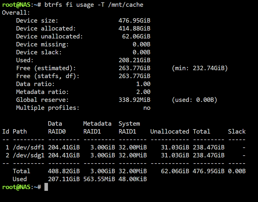

May 23, 20251 yr Author 2 minutes ago, JorgeB said:There's a new docker image, so that's why it's empty, the old one should still be there, and if it wasn't, you could easily recreate it, the main issue for now is that there are still errors with a pool device, and some stats are missing from the diags, post the output from btrfs fi usage -T /mnt/cacheHere it is:
May 23, 20251 yr It is raid0, so if one device is failing, and it appears to be if the cables were swapped, you may lose some data, I would try to copy what you can to the array or another pool/device.

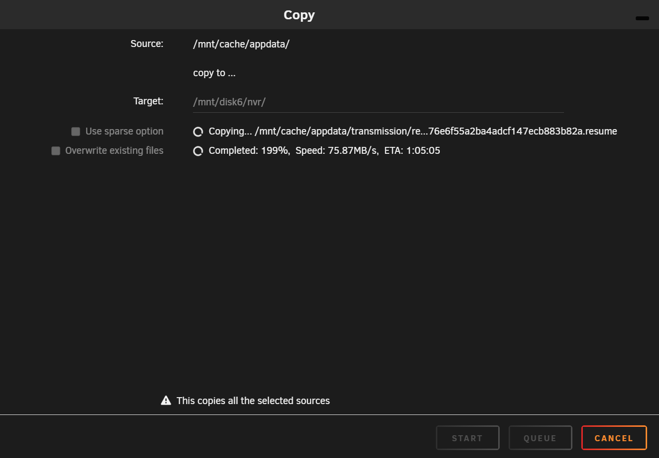

May 23, 20251 yr Author 1 minute ago, JorgeB said:It is raid0, so if one device is failing, and it appears to be if the cables were swapped, you may lose some data, I would try to copy what you can to the array or another pool/device.Ok, so how do I do that if I don't have Krusader to use anymore?I tried copying the 'appdata' directory on the cache pool to another folder on the pool which is shared on my LAN, but it said:
May 23, 20251 yr If the pool is read-only you can't change anything on it, have to copy to other storage (e.g. array, unassigned device...)
May 23, 20251 yr Author 1 minute ago, Kilrah said:If the pool is read-only you can't change anything on it, have to copy to other storage (e.g. array, unassigned device...)I tried copying (as my previous post), but it gave me an error.Plus JorgeB said there's still errors on it.How do I check if it's read only?
May 23, 20251 yr Author Just now, JorgeB said:Try copying to the array, not the pool.Ok thanks, that seems to be working.What's next after that finishes?
May 23, 20251 yr Remove the bad pool device and create a new pool with the remaining, or add a new one.
May 23, 20251 yr Author 16 minutes ago, JorgeB said:Remove the bad pool device and create a new pool with the remaining, or add a new one.A new what?Do you mean the drive itself is dead?If so, how is this possible if it's letting me copy data from it?
May 23, 20251 yr Author Hey so it looks like the transfer progress is stuck.It's been like this for over 2 hours now.Is it finished? I'm worried to press cancel because I don't want to screw anything up.
May 23, 20251 yr Author Ok so I eventually cancelled it, but I figured out that it ended up copying everything in that folder over anyway.The next folder was the 'system' folder, but as I went to copy that... It got stuck immediately. So I pressed cancel, and rebooted the server from the UI. As soon as it booted, now it can't find that cache disk at all! It doesn't even say 'unmountable', just 'not found'!The system folder contains my docker.img file.Am I now screwed?You mentioned previously that I can recreate it. Can you please guide me through this? I'm going to do to the store today and buy two new cache drives. Sorry for all the questions, but I'm completely clueless here. Edited May 23, 20251 yr by Corvus
