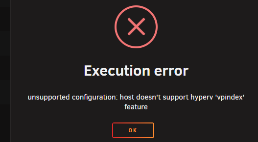

Unrelated but I just did an edit to the template (just remove the OS install iso) and it wouldn't start anymore with
Had to set Hyper-V to No. Was OK with it on Yes before.

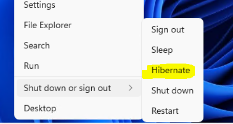

8 hours ago, dxb said:
Can you share the VM configuration settings you are using in Uraid? Also what's power options/settings are you using in Windows?
VM was created with all default settings, only changes made was selecting 4 cores and changing RAM to 8GB, then just install the guest tools, power options were also left as default, just enabled the hibernate option that is disabled on Windows by default, then hibernate from the VM:
And can then resume from the Unraid GUI.
Thanks for sharing the instructions. Manually selecting that option worked on Windows 11. I'd hoped that setting would automatically hibernate (not sleep) after inactivity to bypass the sleep issue, but it's pausing the VM and locking up when I try to resume from the Unraid GUI.
