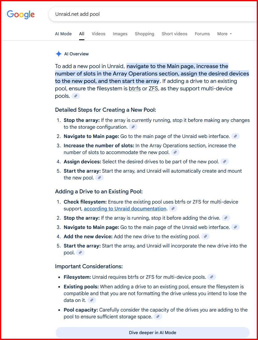

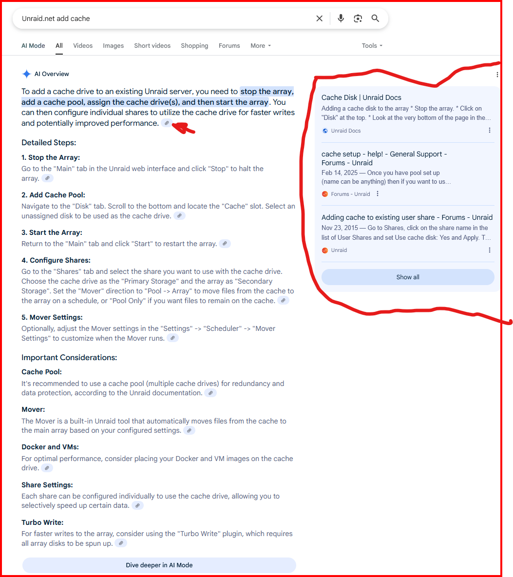

Google is my goto option when look for something about Unraid. This is an example of what their new AI search does:
The box on the right contains links from the 'arrowed' link symbol. I am not real sure what the defaults are on a new install of Unraid regarding pool vs cache. IF 'cache' is not showing up, you may have to add it by clicking on 'Add pool' and so naming it. Search terms are important with Google:
Still hitting the language barrier. Is the Cache added as a "New pool"?
That "AI" is also describing something that does not exist. It looks like it is cloned from the normal manual as it says "go the Disks tab". That is lifted from the standard help page and I still can't work out where my DIsks Tab is. 🙂
The second screen shot is talking about BTRFS, ZFS and multi-device pools. Not something I thought I was dealing with here

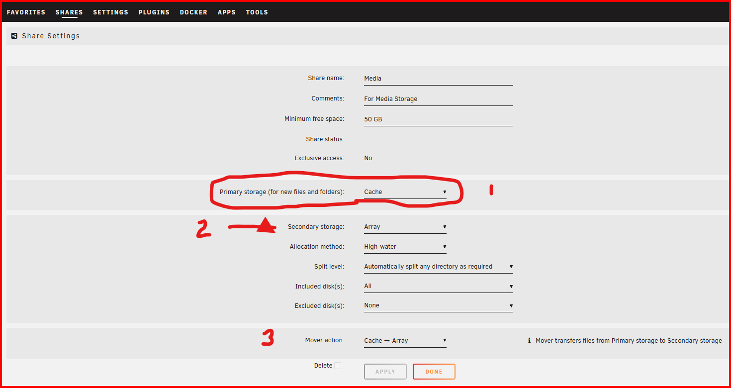

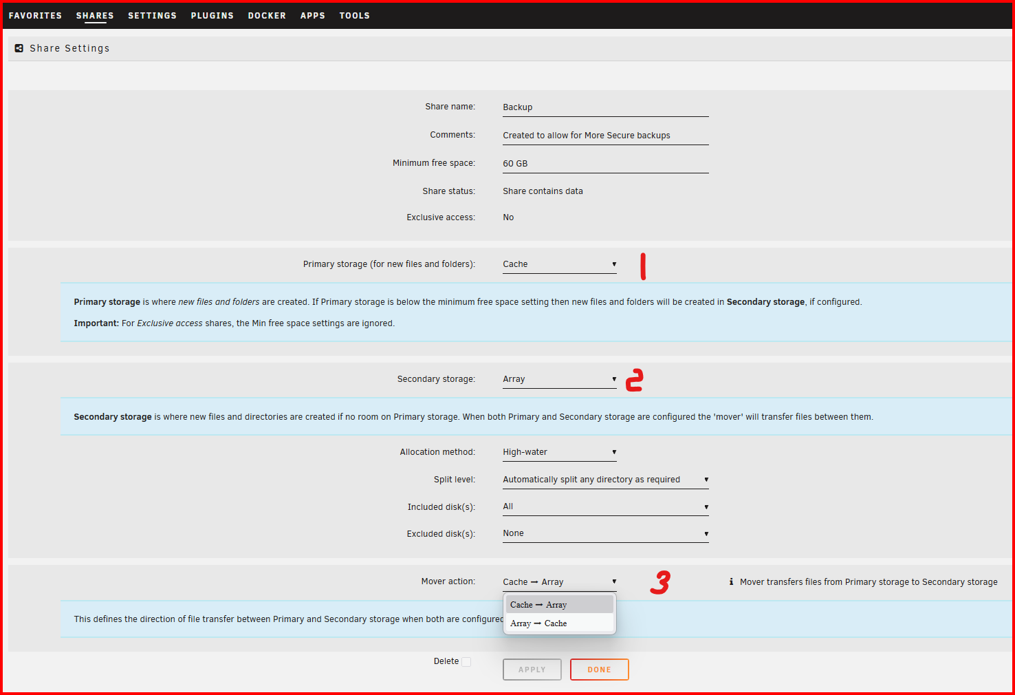

Caching is set at the User Share level, not the disks level. It is set up when you set a pool as primary storage and the array (or another pool with v7) ans secondary storage annd mover direction ans pool->array), and the pool names are irrelevant when doing this.
The term ‘cache disk’ probably reveres to the fact the default name for the first pool created is ‘cache’. However this is historical and there is no requirement for any pool to have that name.
I was just getting lost here: https://docs.unraid.net/legacy/FAQ/cache-disk/ as it was talking of a Disks Tab.
I thought the Cache was part of the Array. Likely an old memory when I half read about it years ago when setting up my first Unraid.
Now I understanding the idea of how this is separate to the Array as there can potentially be multiple arrays in v7.
Literally creating the thing was where my confusion mostly lay.
Got it now.
If upload a lot of data that you overflow the cache, Don't assign cache as primary (1) until the array has its initial load.
Then make Array secondary. (2) And set up mover to move future data from cache to array. (3)

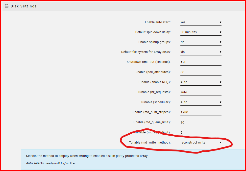

As soon as you assign a parity drive that will drop in about half! You can recover a good part of the by changing the following setting to 'Reconstruct write'. This will spin up all drives during 'wriite' operations. (it is trade-off, speed vs power saving issue..)
I moved the main bulk of the data in by mounting the NTFS disks in the Unraid box and direct copied. Without Parity or Cache in place yet. And likely to keep the shares without Cache as this is mainly going to be a read-only music server.
Parity will be introduced once all the files in place, and then I'll let that rebuild itself as I know the maths will take a while..
Cache is more for the other stuff I'll start playing with at a later date. This box is over powered \ over spec'd as I am going to play with a few other features alongside the NAS. But first I just wanted to get the NAS settled into place.
Even when the Parity "halves the transfer speed" I am still a long way up on my old system.
