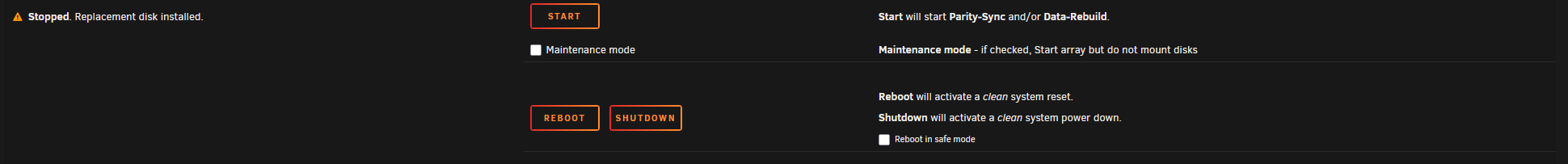

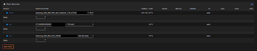

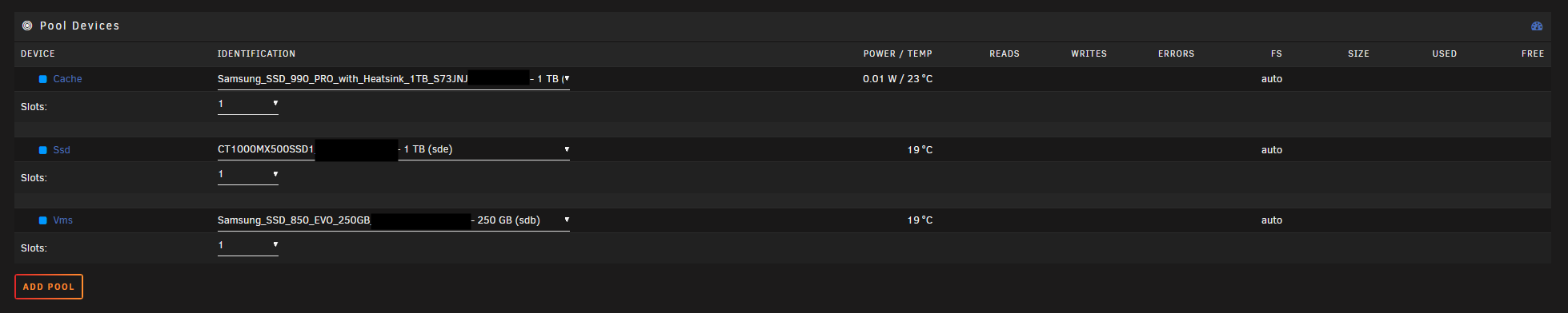

July 3, 20251 yr Hello all, I think I've made a major stuff up while trying to replace a 6tb drive with a new 20tb drive. Pre clear and formatting of the new 20tb drive went to plan, however, I wasn't able to remove the 6tb drive (as disk 5) in my array. So I foolishly went ahead and proceeded into Tools > New Config and under Preserve current assignments: checked 'Array Slots'.This has created a new config which I'm pretty sure has wiped my Array/Pool config. I've yet to start the array as then message 'All existing data on this device will be OVERWRITTEN when array is Started' is appearing next to the parity drive.Is there a way I can recover the pool settings from the USB drive?

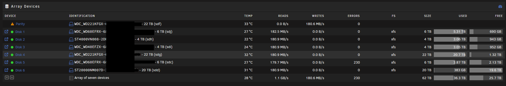

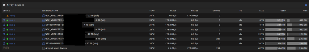

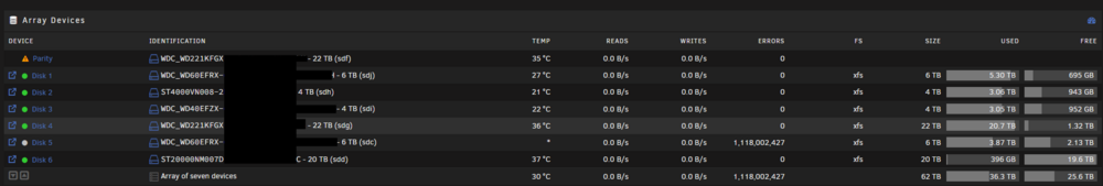

July 3, 20251 yr Author My 6tb drive (disk 5) has had increasing 'UDMA CRC error count' errors/warnings. I suspect this is due to the pins being damaged/stripped as I have an adapter on the drive, image attached. But it has been working ok. This changed when I changed the "Default spin down delay:" from none to 1 hour, as the next morning the drive was not detected. This also occurs during some reboots/power outages.In the meantime I had started to clear and format the 20tb drive (disk 6), I stopped the array placed it in maintaainence mode to re discover the 6tb drive. It did start a data rebuild, but failed pretty quick due to read errros. Instead of rebooting like I normally do to see if the disk would be again picked up, I went into mainatinence mode, removed the 6 tb drive, then tried to replace it with the 22tb drive in disk 6. However, I couldn't start the array to do incorrect config, it did try a rebuild and this is when I decided to create a new config.While waiting for my post to be approved, I got the usb drive and renamed 'super.dat' to super1.dat and then changed super.old into super.dat.As per the screenshot, it appears to have assigned the drives as they were, with "All existing data on this device will be OVERWRITTEN when array is Started" next to disk 5 (6tb) and the message "Start will start Parity-Sync and/or Data-Rebuild." near the start array prompt. I'm concerned the FS is picking up as 'auto'.NOTE: Diagnostics dump has been taken after I renamed super.old into super.dat and rebooted. I then powered the system down last night.Screens after booting this morning :ur-diagnostics-20250703-1939.zip Edited July 4, 20251 yr by Drew_F Attached image of sata adapter in use / Order of images & additional info

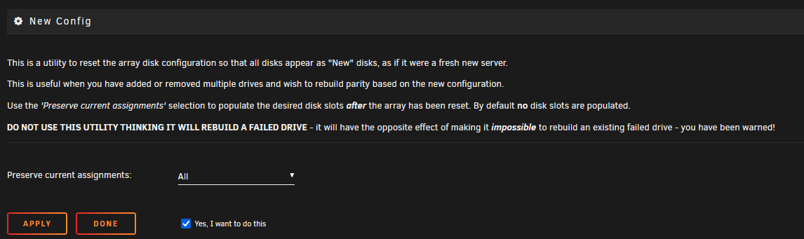

July 4, 20251 yr Community Expert Disk5 looks healthy, best to probably just do a new config and resync parity with that disk in place, do you also want disk6 to be added to the array as a new disk?
July 4, 20251 yr Community Expert Tools - New config - Keep allThen check assignments are correct and start the array to begin a parity sync, disk6 will need to be formatted.

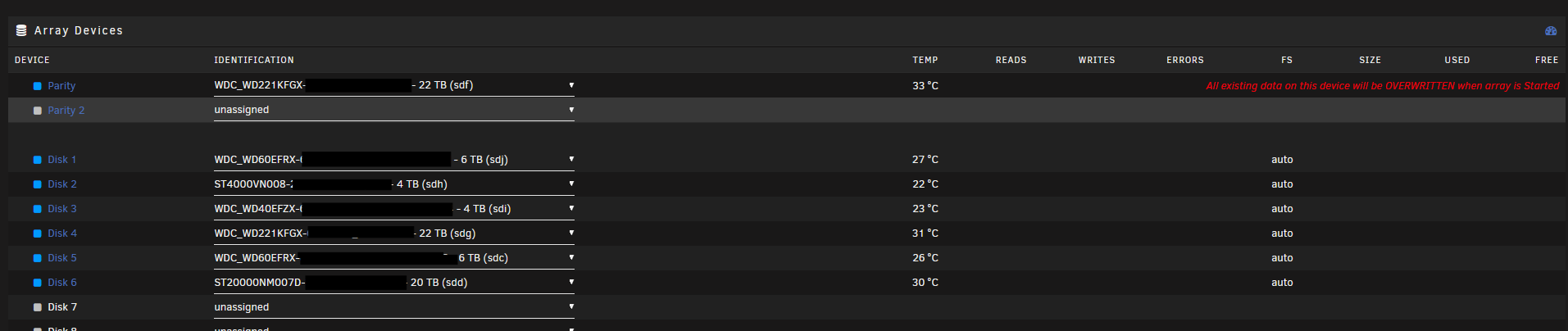

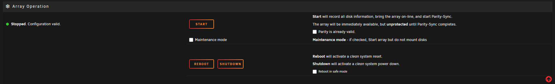

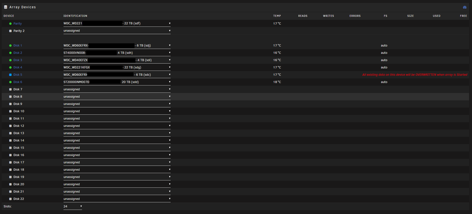

July 4, 20251 yr Author I clicked applyThen drives appear in order, however, it looks like it's suggesting the parity drive will be erased? Edited July 4, 20251 yr by Drew_F Additional Context
July 4, 20251 yr Community Expert That is normal, parity will be resynced, but before starting can you confirm if this refers to disk5?10 hours ago, Drew_F said:It did start a data rebuild, but failed pretty quick due to read errros.

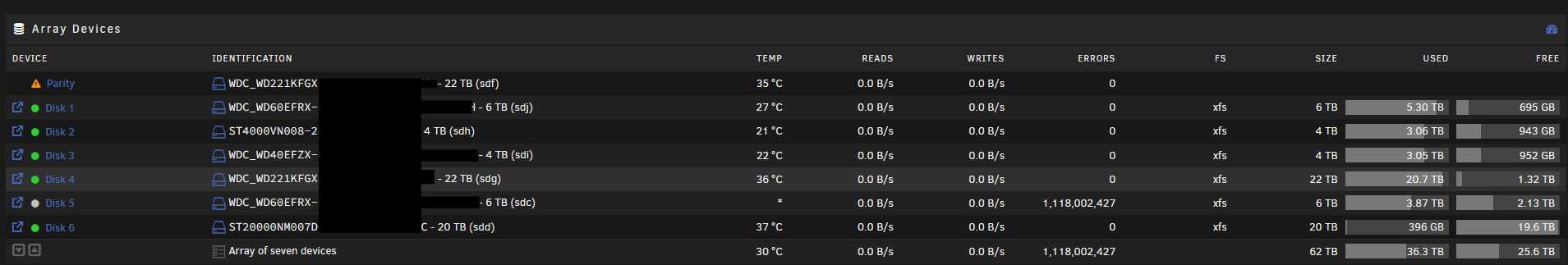

July 4, 20251 yr Author Thank you! Will report back once its done fully.Only 0.1% in and assume these errors are nothing major? Edited July 4, 20251 yr by Drew_F
July 4, 20251 yr Author When I woke up this morning, so I've paused the sync for now. Diags attached. ur-diagnostics-20250705-0910.zip

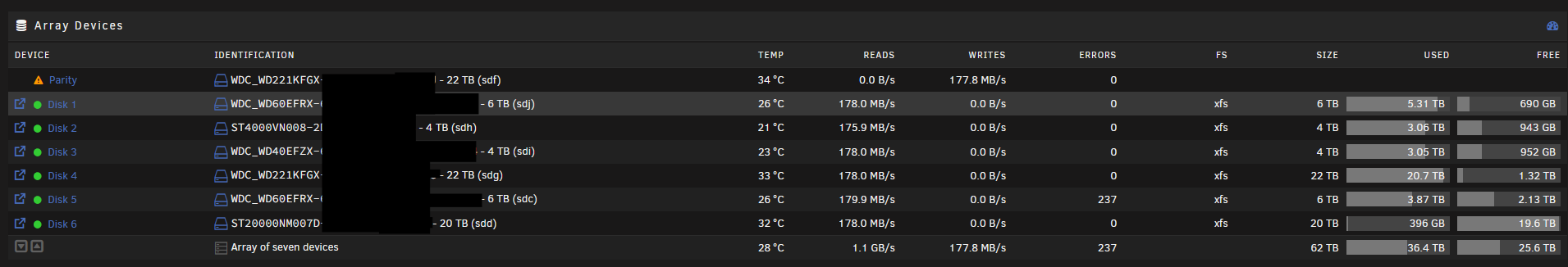

July 4, 20251 yr Author So I've stopped the array, shutdown completely. I suspected the cable from the HBA card do not like this adapter on drive, so I have replaced it with a right angled SATA cable into my motherboard directly. Then rebooted. I was able to mount the drive in UD and view directories and files. So I've retsarted the array and parity sync, but am still getting errors. I suspect this drive might be on its way out.For now have left parity sync running. ur-diagnostics-new-sata-cable-20250705-0952.zip
July 5, 20251 yr Community Expert SMART still looks good, but the errors are logged as an actual disk problem, I would recommend trying to clone that disk with ddrescue, or manually copying what you can to another disk.

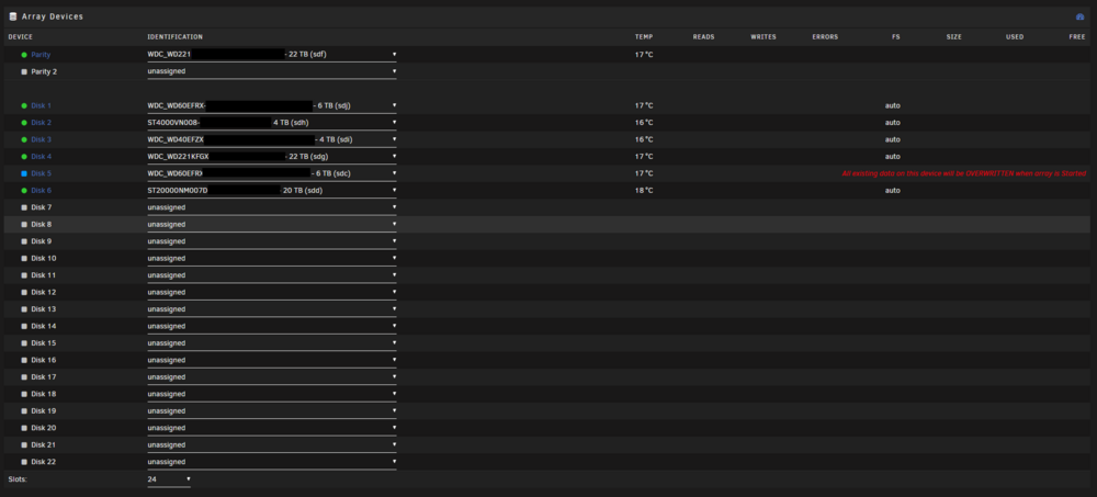

July 5, 2025Jul 5 Author Re: "manually copying what you can to another disk."I have paused the Parity Sync and have started to copy the existing directories from disk 5 (6tb) onto disk 6 (20tb) with krusader.Once this is completed, my understanding is I will need to do the following:Stop the array, unassign both disk 5 and disk 6. Shutdown. Disconnect disk 5 (6tb) completely. Reboot Create a new config with the 20tb drive as disk 5, and start a parity sync. Edited July 5, 2025Jul 5 by Drew_F
July 6, 2025Jul 6 Community Expert Solution You just need to do a new config and not reassign disk5, no need to actually disconnect it, but you can also do that of course.
July 6, 2025Jul 6 Author Yep, I'll remove it and use it as some offline storage for non critical stuff. I don't trust it as part of the array!With the new config, will the order of disks matter? Obviously I will keep the existing parity drive as parity, my understanding of how the disks are labelled and handled (eg mnt/disk1 etc) is limited.
July 6, 2025Jul 6 Community Expert 38 minutes ago, Drew_F said:With the new config, will the order of disks matter?Nope, you can reorder them if you like.
