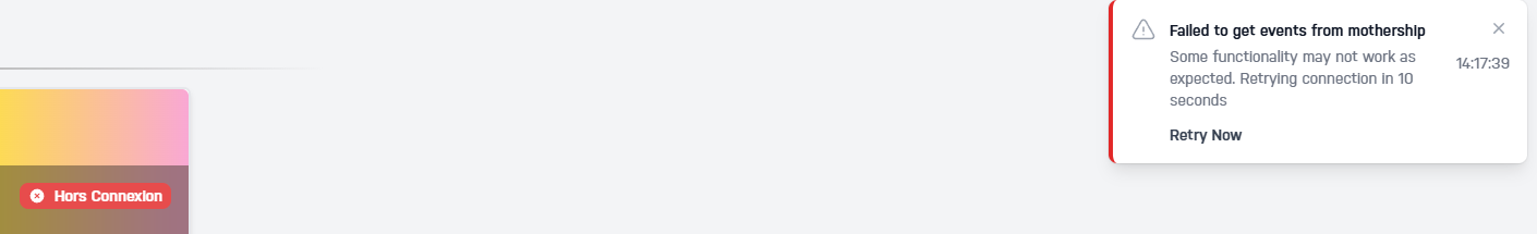

can't connect since the last update of plugin (unraid 7.1.4)
i set to static, port xxx, or upnp, i just have sometimes a message that i can' get events from mothership ?
i try to add a uuid for sso, restart , nothing , infinite loading page

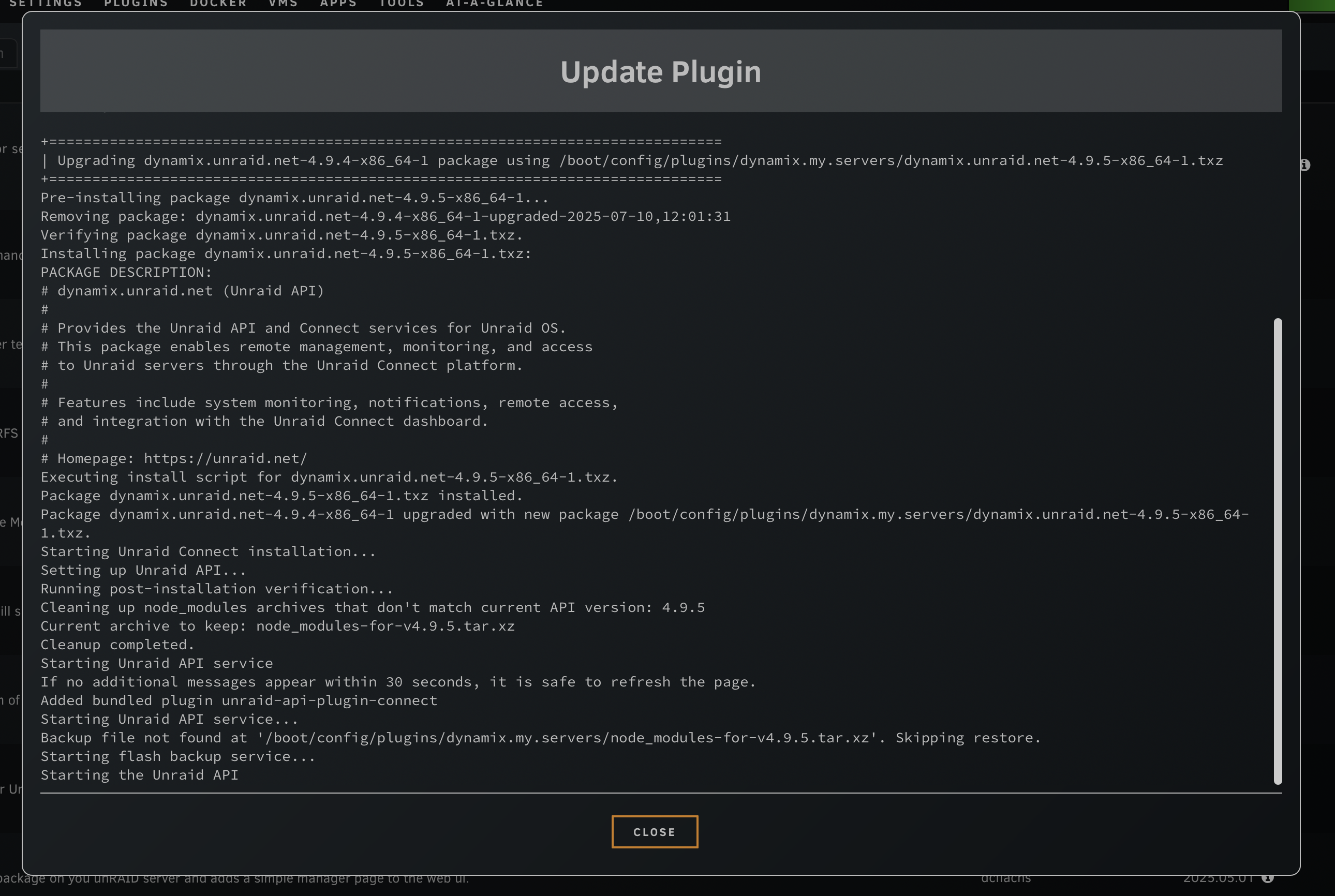

Thanks, but I am still having the same issue from my initial post - it seems to hang on install:
Starting the Unraid API
plugin: updating: dynamix.unraid.net.plg
Executing hook script: pre_plugin_checks
plugin: downloading: dynamix.unraid.net-4.9.5-x86_64-1.txz ... done
Running on supported version 7.1.4
Backing up original files...
Backup complete.
Patching header logo if necessary...
Installing package...
Removing old package file: /boot/config/plugins/dynamix.my.servers/dynamix.unraid.net-4.9.4-x86_64-1.txz
Cleaning up existing node_modules directory...
Removing: /usr/local/unraid-api/node_modules
| Upgrading dynamix.unraid.net-4.9.4-x86_64-1 package using /boot/config/plugins/dynamix.my.servers/dynamix.unraid.net-4.9.5-x86_64-1.txz
Pre-installing package dynamix.unraid.net-4.9.5-x86_64-1...
Removing package: dynamix.unraid.net-4.9.4-x86_64-1-upgraded-2025-07-10,12:01:31
Verifying package dynamix.unraid.net-4.9.5-x86_64-1.txz.
Installing package dynamix.unraid.net-4.9.5-x86_64-1.txz:
PACKAGE DESCRIPTION:
# dynamix.unraid.net (Unraid API)
# Provides the Unraid API and Connect services for Unraid OS.
# This package enables remote management, monitoring, and access
# to Unraid servers through the Unraid Connect platform.
# Features include system monitoring, notifications, remote access,
# and integration with the Unraid Connect dashboard.
# Homepage: https://unraid.net/
Executing install script for dynamix.unraid.net-4.9.5-x86_64-1.txz.
Package dynamix.unraid.net-4.9.5-x86_64-1.txz installed.
Package dynamix.unraid.net-4.9.4-x86_64-1 upgraded with new package /boot/config/plugins/dynamix.my.servers/dynamix.unraid.net-4.9.5-x86_64-1.txz.
Starting Unraid Connect installation...
Setting up Unraid API...
Running post-installation verification...
Cleaning up node_modules archives that don't match current API version: 4.9.5
Current archive to keep: node_modules-for-v4.9.5.tar.xz
Cleanup completed.
Starting Unraid API service
If no additional messages appear within 30 seconds, it is safe to refresh the page.
Added bundled plugin unraid-api-plugin-connect
Starting Unraid API service...
Backup file not found at '/boot/config/plugins/dynamix.my.servers/node_modules-for-v4.9.5.tar.xz'. Skipping restore.
Starting flash backup service...
And as you can see, the CLOSE button never changes to DONE and:
I get this at the top. Same as with 4.9.4.

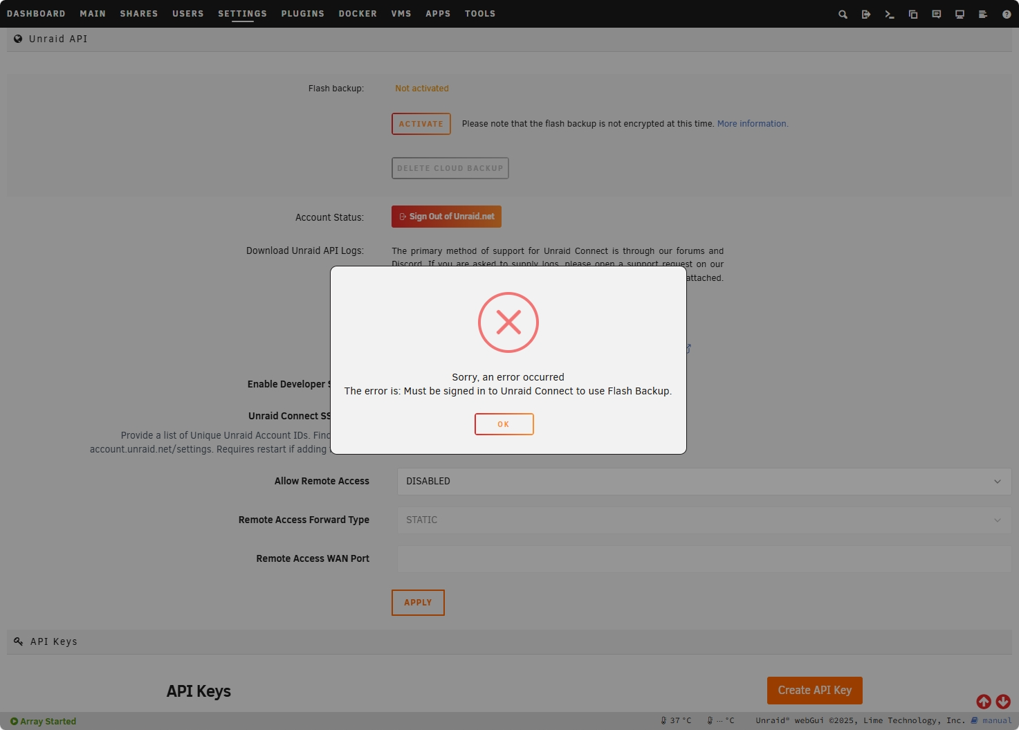

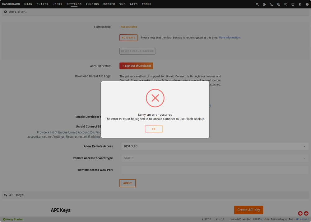

Just adding my 5 cents here that I'm facing the same problem. I tried both updating just the Unraid Connect plugin on my Unraid 7.1.4 OS and removing it completely and installing again.
On top of that the flash backup stopped working as well giving the following error (I tried disconnecting and reconnecting my unraid.net account to no success):
Is there a way to downgrade the plugin until it is tested thoroughly?

Thanks, @elibosley - the latest version restored flash backup which was very important for me!
On that note I still face same issue with logs hanging on Starting the Unraid API just as other users stated above.
Please send the response from the prior DEBUG statements in the install, that may help us get to the bottom of this.
Checking disk space on /usr... ok. (30937MB free)
Backup complete.
| Upgrading dynamix.unraid.net-4.10.0-x86_64-1 package using /boot/config/plugins/dynamix.my.servers/dynamix.unraid.net-4.10.0-x86_64-1.txz
Pre-installing package dynamix.unraid.net-4.10.0-x86_64-1...
Removing package: dynamix.unraid.net-4.10.0-x86_64-1-upgraded-2025-07-16,20:15:46
Verifying package dynamix.unraid.net-4.10.0-x86_64-1.txz.
Installing package dynamix.unraid.net-4.10.0-x86_64-1.txz:
Executing install script for dynamix.unraid.net-4.10.0-x86_64-1.txz.
Package dynamix.unraid.net-4.10.0-x86_64-1.txz installed.
Package dynamix.unraid.net-4.10.0-x86_64-1 upgraded with new package /boot/config/plugins/dynamix.my.servers/dynamix.unraid.net-4.10.0-x86_64-1.txz.
Running setup_api.sh
Starting API setup script
Environment: CONFIG_DIR=/boot/config/plugins/dynamix.my.servers, API_BASE_DIR=/usr/local/unraid-api
UNRAID_BINARY_PATH=/usr/local/bin/unraid-api
Env file already exists
API setup completed at Wed Jul 16 20:15:56 EDT 2025
Running verify_install.sh
Performing comprehensive installation verification...
Checking executable files...
✓ Executable file /usr/local/bin/unraid-api exists and is executable
✓ Executable file /etc/rc.d/rc.unraid-api exists and is executable
✓ Executable file /usr/local/emhttp/plugins/dynamix.my.servers/scripts/gitflash_log exists and is executable
Checking directories...
✓ Directory /usr/local/unraid-api exists
✓ Directory /var/log/unraid-api exists
✓ Directory /usr/local/emhttp/plugins/dynamix.my.servers exists
✓ Directory /usr/local/emhttp/plugins/dynamix.unraid.net exists
✓ Directory /etc/rc.d/rc6.d exists
✓ Directory /etc/rc.d/rc0.d exists
Checking symlinks...
✓ Symlink /usr/local/bin/unraid-api exists -> ../unraid-api/dist/cli.js
✓ Symlink /usr/local/sbin/unraid-api exists -> ../bin/unraid-api
✓ Symlink /usr/bin/unraid-api exists -> ../local/bin/unraid-api
Checking configuration files...
✓ Environment file /boot/config/plugins/dynamix.my.servers/env exists
Checking shutdown configuration...
Checking for shutdown scripts in rc6.d...
✓ Shutdown script for flash-backup exists and is executable
✓ Shutdown script for unraid-api exists and is executable
✓ rc0.d symlink exists
✓ unraid-api is in PATH
 Installation log file not found
Verification summary:
- Executable files errors: 0
- Directory errors: 0
- Symlink errors: 0
- Configuration errors: 0
- Shutdown configuration errors: 0
- Total errors: 0
All checks passed successfully.
Installation verification completed successfully.
Installation completed at Wed Jul 16 20:15:56 EDT 2025
Cleaning up node_modules archives that don't match current API version: 4.10.0
Current archive to keep: node_modules-for-v4.10.0.tar.xz
Cleanup completed.
DEBUG: Checking PATH: .:/usr/local/sbin:/usr/sbin:/sbin:/usr/local/bin:/usr/bin:/bin
DEBUG: Checking if unraid-api files exist:
total 80
drwxr-xr-x 3 root root 100 Jul 15 14:34 .
drwxr-xr-x 5 root root 320 Jul 16 20:15 ..
drwxr-xr-x 2 root root 460 Jul 15 14:34 assets
-rwxr-xr-x 1 root root 69534 Jul 15 14:34 cli.js
-rwxr-xr-x 1 root root 11321 Jul 15 14:34 main.js
DEBUG: Checking symlink:
lrwxrwxrwx 1 root root 25 Jul 16 20:15 /usr/local/bin/unraid-api -> ../unraid-api/dist/cli.js
DEBUG: Checking Node.js version:
v22.17.0
DEBUG: Checking if cli.js is executable:
-rwxr-xr-x 1 root root 69534 Jul 15 14:34 /usr/local/unraid-api/dist/cli.js
DEBUG: Attempting to run unraid-api directly:
Unraid API v4.10.0+81808ad
Backup file not found at '/boot/config/plugins/dynamix.my.servers/node_modules-for-v4.10.0.tar.xz'. Skipping restore.
