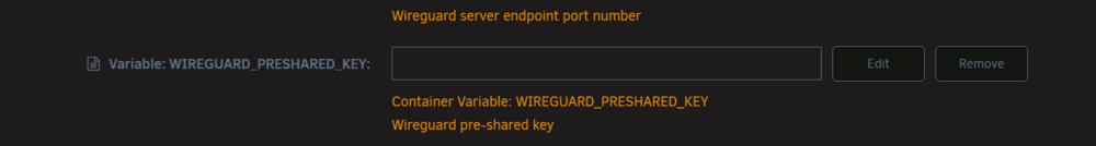

For some reason I keep getting this error trying to set up AirVPN with wireguard. There is no place to put the preshared key though, not in advanced settings or anything. making a custom variable with 'WIREGUARD_PRESHARED_KEY" doesn't work either. Any thoughts?
2026-01-29T18:24:15Z ERROR VPN settings: Wireguard settings: pre-shared key is not set
You’ll need to use a configuration file. See the documentation- https://github.com/binhex/documentation/blob/master/docker/faq/vpn.md
Scroll down to Q28.
WIREGUARD_PRESHARED_KEY is used in the gluetun container and is available (binhex-official-gluetun) as a env var:
