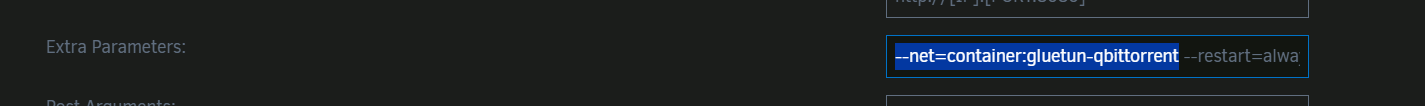

I tried setting this up today filling in all of these variables and was getting this error when starting qBit:
"[ERROR] Unable to determine VPN adapter name, please check your gluetun configuration and ensure the VPN is connected. "
Edited by Casel
ok and you have set the network for qbittorrent to use the gluetun containers network, right? for example my gluetun container is called gluetun-qbittorrent, so therefore i have set --extra-parameters for qbittorrent to:

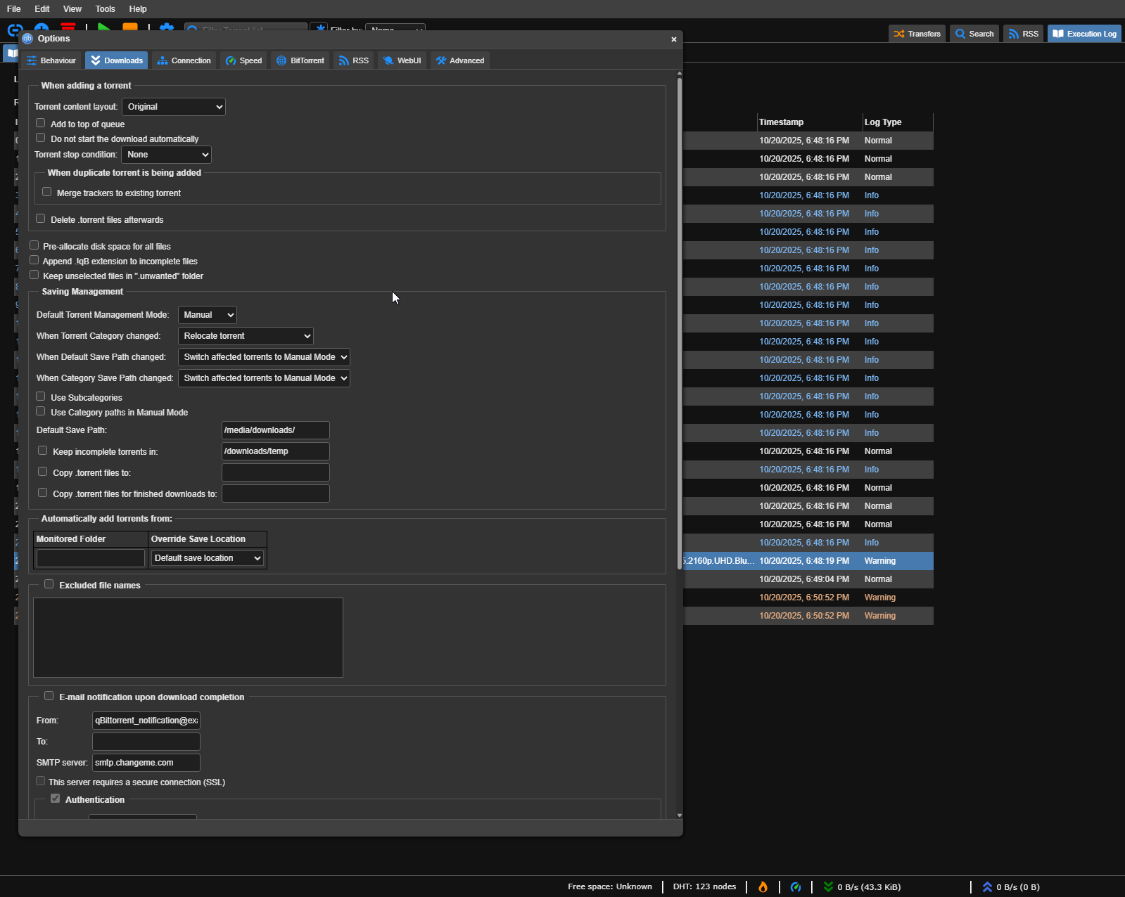

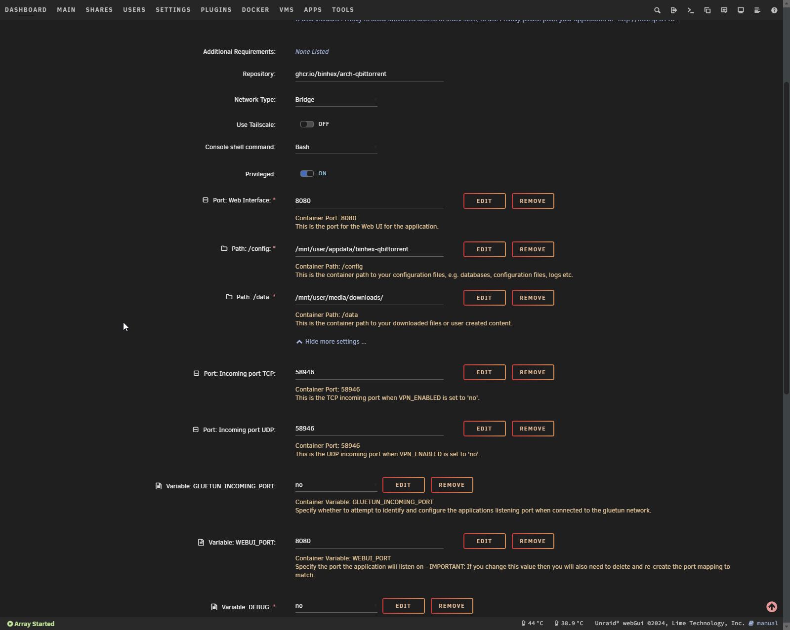

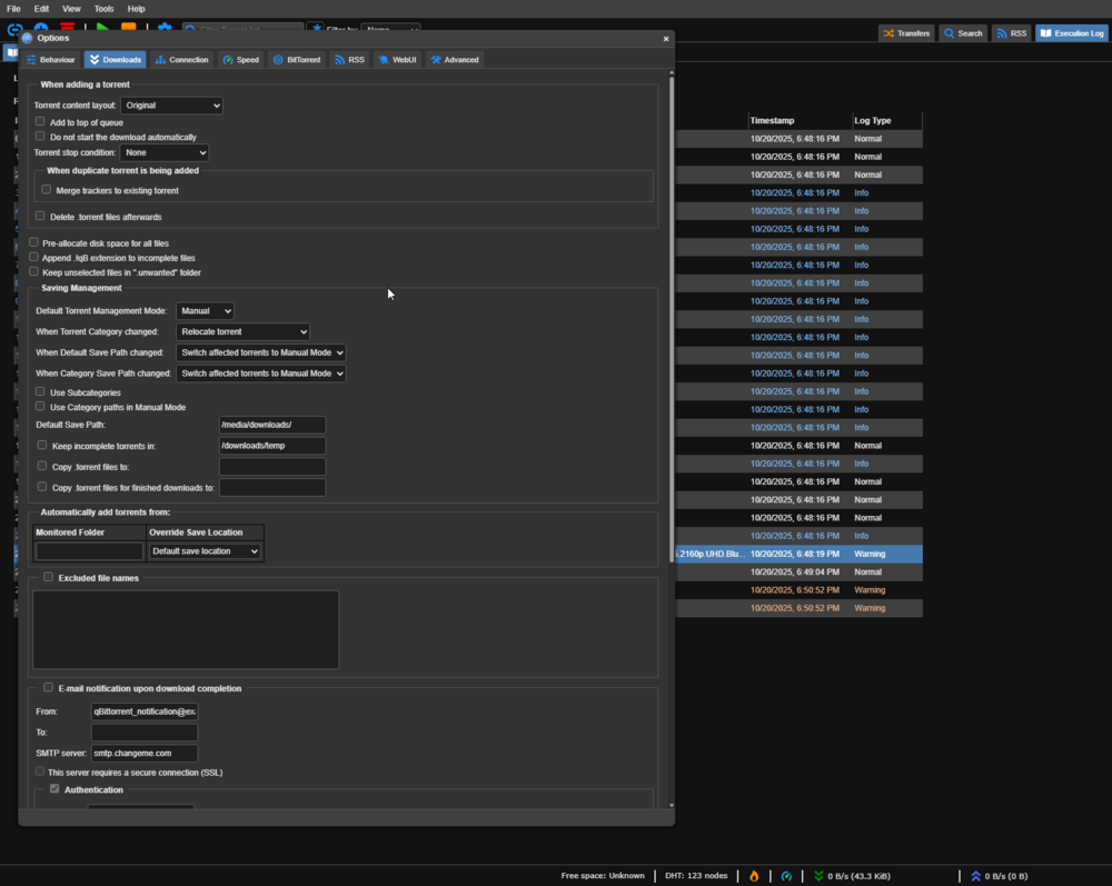

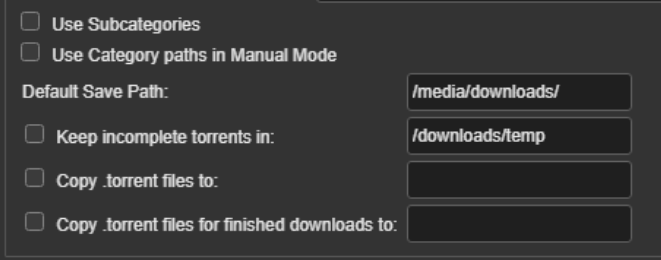

I need some help with an ongoing issue I'm having with my Q BitTorrent container when I attempt to do some downloads from many sources and I've tried different sites different connections every time I download attempts I get an error and it says like permission denied
heres the error with the filename changed
"File error alert. Torrent: "filename". File: "/downloads/Filename". Reason: "filename" file_open (/downloads/"filename" error: Permission denied"
from your screenshot from qbittorrent:
ok so looking at the screenshot for the configuration of the container, you have neither /media or /downloads defined (although thats not ticked so has no effect) for the container path, try changing Default save path to /data/completed and enable and set Keep incomplete torrents in to /data/incomplete that way your completed files/folders will end up on the host at path /mnt/user/media/downloads/completed and /mnt/user/media/downloads/incomplete
