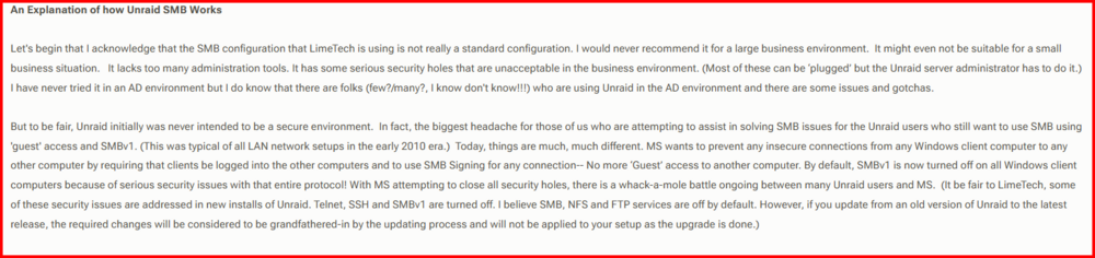

From the beginning, Unraid has been configured to enable a login to the server using a ‘guest’ account. As anyone with a security background knows, once a hacker has access inside a server, they will start to probe and test for ways to elevate the privileges of that login.
To be fair, virtually all of the home NAS’s back before 2010 were using ‘guest’ logins as their default. It made it very simple for the end-users to setup a working network on their home LAN. Plus, it was just past the era of the dial-up Internet connection and there wasn’t the 24-7 online presence for most NAS users. If you wanted more security for your files and information, you were going to do some work to get there. At that time for the vast majority of Unraid users, the threats came from the folks (or the clients) who were already on the LAN!

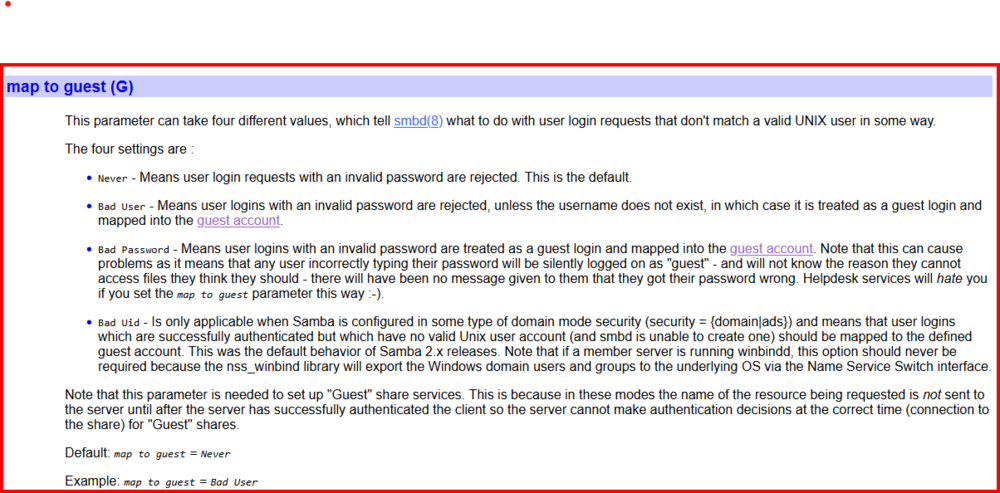

To enable guest accounts, LimeTech has changed a Samba parameter to allow them. This parameter is the ‘map to guest’ one which configured as follows in the standard Unraid install:
map to guest = Bad User
The present Samba default for this parameter is:
map to guest = Never
With this setting, a guest connection will never be permitted and you will be required to log into the server with a valid user name and password to gain any Share access even if it has a ‘Public’ share type configuration. (The figure below is a section from the smb.conf parameter table found here:
https://www.samba.org/samba/docs/current/man-html/smb.conf.5.html

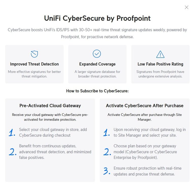

I guess if I get super duper paranoid, I can investigate the UniFi CyberSecure Intrusion Detection System yearly subscription that can be added to the Gateway for $99 a year.
The Mikrotik seemed like a good idea but I soon realized it's "router OS" while powerful just did not equate to the amount of time I wanted to spend learning it. I replaced the Mikrotik with the Ubiquiti because it couldn't handle my new fiber bandwidth. No way was I leaving 2/3 of my new fiber transfer speed on the table. Don't get me wrong, I never had issues with the CloudRouter. It ran from Dec 2018 to December 2025 with no issues. I should probably sell it or something. It wasn't exactly cheap: https://www.amazon.com/dp/B08437WT3Q?ref_=ppx_hzsearch_conn_dt_b_fed_asin_title_23

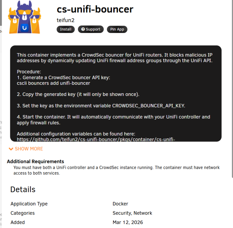

I added the docker xml into unraid.
?what issues are you having?
