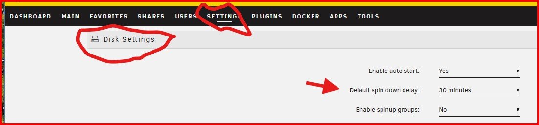

The spin down delay is controlled by two settings. The first one for all the disks is here:

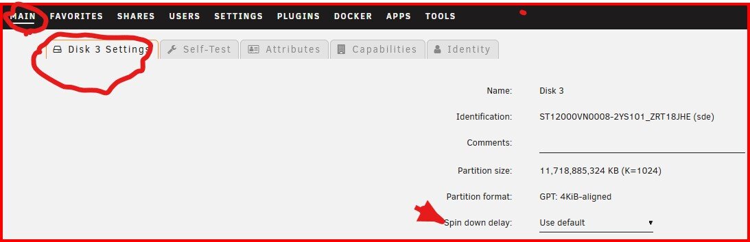

And for each individual disk from this page for that disk:

The Performance setting is intended to allow you to select the tradeoff between CPU/GPU power consumption and performance. Both Intel and AMD provide for this choice in their chip sets.
