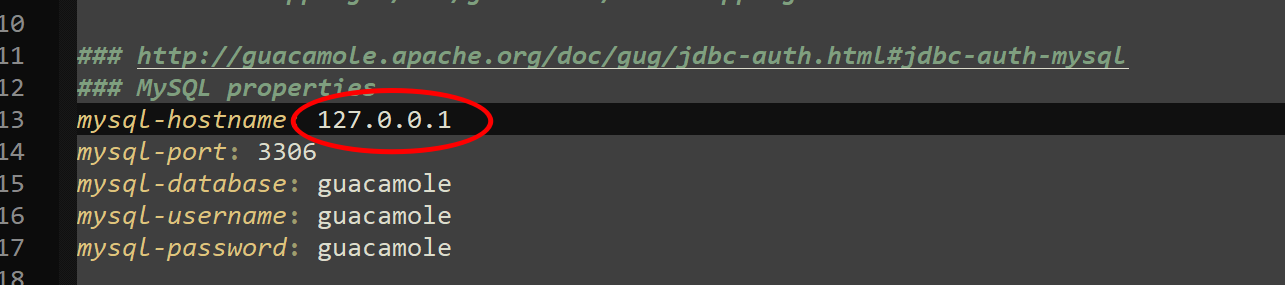

may a question @Cabé
as mine went offline with a error
now i saw you changed something, when reading, seems i missunderstand something
i added a Variable
what i still see, my .prop file is always rewritten to localhost and doesnt keep the ip from the mariadb
seems i miss something ;)
Hello altruismo, thank's for using my contentor,
For wath i see you use an existing template and pheraps an existing exported path from other guacamole app.
You must remove the app (the image must be deleted) and add it again from community apps, atention to the hidden option: AppData Config Path , you are using an external database (declaring mysql in option: EXTENSION_PRIORITY) please confirm that the path does not exist.
Dont forget to fill the options for access the external database.
This confirm a new deploy, because i see in your post the template is not the last nor the file guacamole.properties is not the one deployed with the app
Edited by Cabé

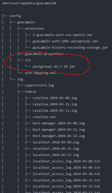

Hi @Cabé ,
The latest update to 1.0.4 bricked the functionality with postgreSQL. Reason is that the lib folder is now empty and no file for postgresql exist: https://jdbc.postgresql.org/download/postgresql-42.7.10.jar
You might remember that I stored this file manually and you suggested to put postgresql to my extension-priority. I did already do that before running the upgrade. My guacamole.properties file looks as follows:
guacd-hostname: localhost
guacd-port:     4822
extension-priority: postgresql, openid
postgresql-hostname: 192.168.20.54
postgresql-port: 5432
postgresql-database: <db details hidden>
postgresql-username: <db details hidden>
postgresql-password: <db details hidden>
openid-authorization-endpoint: <id details hidden>
openid-jwks-endpoint: <id details hidden>
openid-issuer: <id details hidden>
openid-client-id: <id details hidden>
openid-redirect-uri: <id details hidden>
I think there is a bug which does not put the latest postgresql jar file to the lib folder. Maybe you know how to fix it.
I can't reproduce your problem, you say there is no postresql-42.7.10.jar file in /config/guacamole/lib of the docker?
Try to change 'AppData Config Path' (edit docker and Show more settings)
Yes, after upgrading to latest docker image I did see no postgresql*.jar file anymore in /config/guacamole/lib folder. I did not change any settings. I am using the following environment, path settings:

PGID=100
/mnt/cache/appdata/guacamole/config -> /config
/mnt/cache/appdata/guacamole/recordings -> /var/lib/guacamole/recordings
/mnt/user/appdata/guacamole#
├── config
│   ├── guacamole
│   │   ├── extensions
│   │   │   ├── 1-guacamole-auth-sso-openid.jar
│   │   │   ├── guacamole-auth-jdbc-postgresql.jar
│   │   │   └── guacamole-history-recording-storage.jar
│   │   ├── guacamole.properties
│   │   ├── lib
│   │   │   └── postgresql-42.7.10.jar
│   │   └── user-mapping.xml
│   └── log
│       ├── supervisord.log
│       ├── tomcat
│       │   ├── catalina.2026-03-08.log
│       │   ├── catalina.2026-03-11.log
│       │   ├── catalina.2026-03-13.log
│       │   ├── catalina.out
│       │   ├── host-manager.2026-03-08.log
│       │   ├── host-manager.2026-03-11.log
│       │   ├── host-manager.2026-03-13.log
│       │   ├── localhost.2026-03-08.log
│       │   ├── localhost.2026-03-11.log
│       │   ├── localhost.2026-03-13.log
│       │   ├── localhost_access_log.2026-03-08.txt
│       │   ├── localhost_access_log.2026-03-09.txt
│       │   ├── localhost_access_log.2026-03-10.txt
│       │   ├── localhost_access_log.2026-03-11.txt
│       │   ├── localhost_access_log.2026-03-12.txt
│       │   ├── localhost_access_log.2026-03-13.txt
│       │   ├── manager.2026-03-08.log
│       │   ├── manager.2026-03-11.log
│       │   └── manager.2026-03-13.log
│       └── tomcat.log
└── recordings
I think the download trigger for postgre*.jar is not started correctly.
I did quickly check your code at: https://github.com/cleao01/UnraidDockerGuacamole/blob/main/image/etc/firstrun/firstrun.sh#L261. The else case on line 261 is no else case. It should run in my opinion if extension priority postgresql is set and if no postgresql*.jar file is in /config/guacamole/lib. Do you think so also?
Is the one you copy manualy?:
In line 261 i test if no postgresql extension exists , its the same of testing the connector because the two must be present
Edited by Cabé
Yeah exactly. That‘s the one I copied manually.
