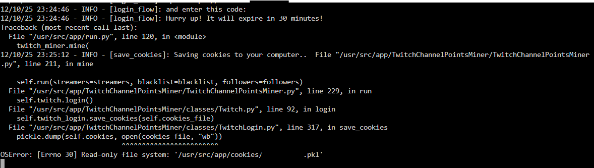

it feels like its kinda stuck in a loop. i start the docker, open the logs, authorize the twitch TV thing and then it starts all over again and wants to log in again.
even when i try to use my login settings in the run.py it askes for the twitch tv authorization...
and i really think its missing the 2fa...
Edited by stFfn
i even tested removing my 2FA and it did not work :-/
twitch-drops-miner works without a flaw. i can log in and its farming drops. but this does not log in :(
Can maybe anyone of you guys give me your config and i try to use it, after i changed my twitch name in it?
should it load the webinterface even if its not loged in?
Edited by stFfn
i think i know why its not working. the cookie folder is read only.. but i dont know why. i´ve set the folder in unraid to read write for everyone and in windows i did the same.
But that does not makse sense. i´ve created the .pk1 file manually and set the permissions for everyone and it still does not work and write the cookies...
Edited by stFfn
ok, i got pissed of, uninstalled it all again and redid everything and now it works.. 0o
