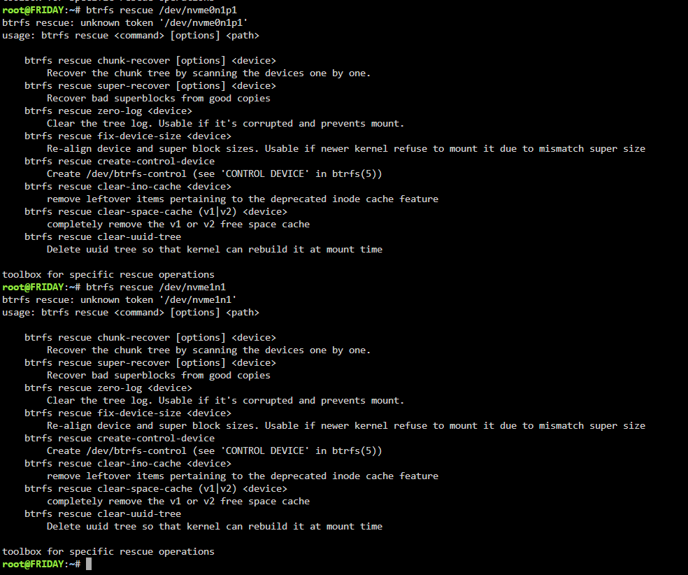

October 15, 2025Oct 15 Author tried both btrfs rescue /dev/nvme0n1p and `btrfs rescue /dev/nvme1n1` results are in the image what dose this mean i removed the zero log stuff.i just want to be though as i dont want to mess it up

October 16, 2025Oct 16 Community Expert Restart the array and hopefully that pool will now mount, if it does, you should run a scrub on both pools and delete any corrupt files. Some corrupt files are expected due to the bad RAM, and they will be listed on the syslog after the scrub.
