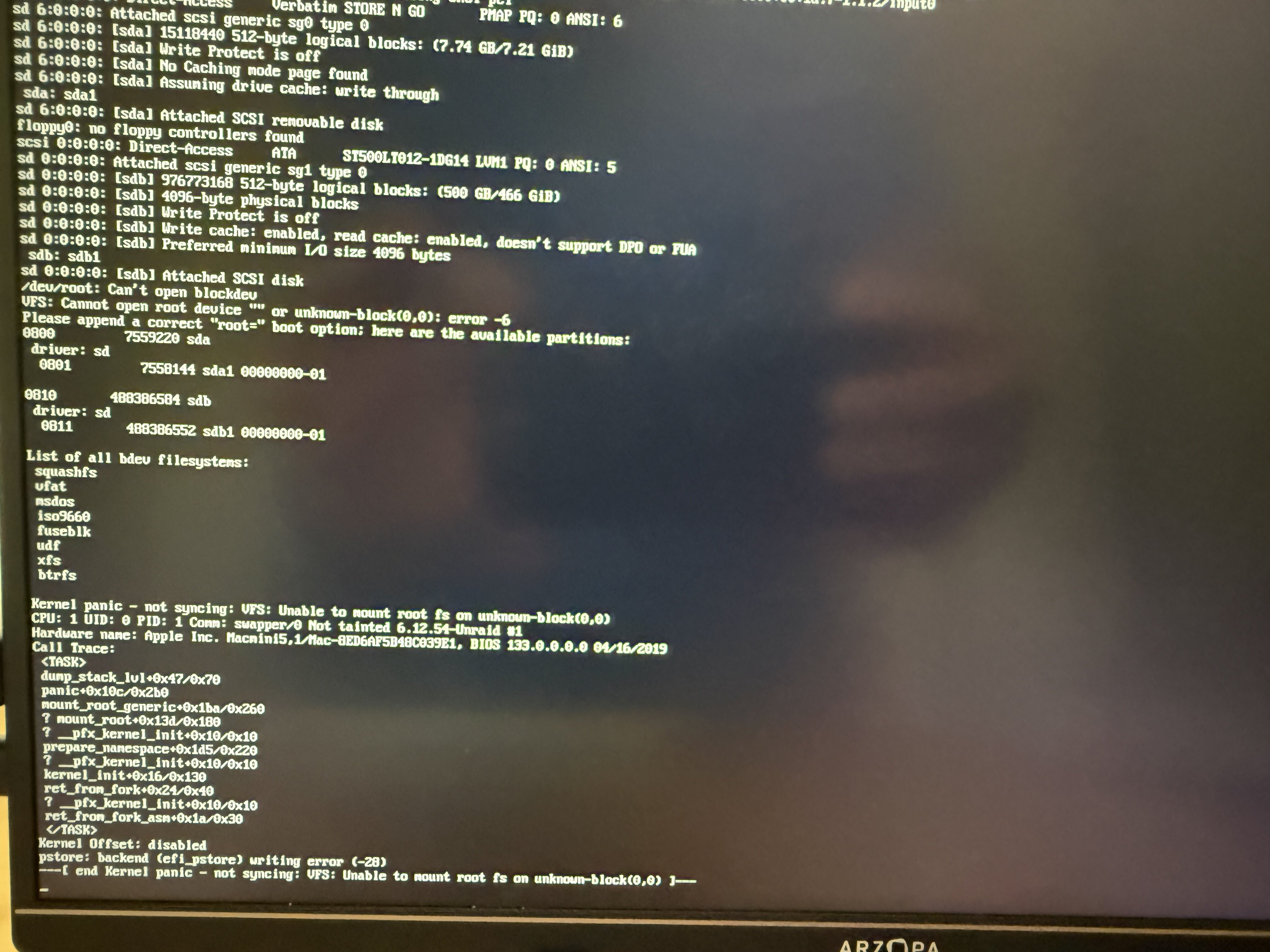

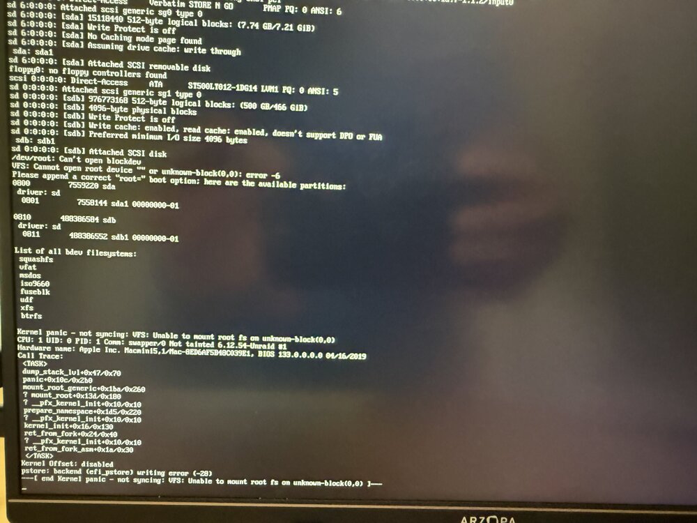

As a troubleshooting step, I grabbed a seperate (and admittedly older) Mac Mini and a different USB stick (Verbatim) and did a fresh/vanilla install of 7.2. The attached error is the same on the PROD UnRaid Mac Mini (noting PROD is a Macmini6,2 with a Kingston USB), but apart from that difference the kernel panic and error is the same.
Any suggestions welcome, and/or is there some difference with 7.2 which is preventing it from working on the Mac Minis now?
Try recreating the flash drive, first backup the current one, then recreate it using the USB tool, confirm the flash drive boots with the stock install, and if yes, restore only the /config folder from the backup overwriting any existing files.
Thank you for that suggestion and I tried a variation of that. I grabbed a new/clean flash drive and used the USB created tool to make a new/vanilla one. Exact same error (that’s where the screen shot is from).

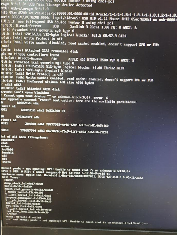

Same here with a Mac Mini Mid 2011 and a Sandisk Ultra USB-Stick. Downgrade to 7.1.4 works just fine.

BTW, are you guys booting UEFI or legacy? I tested before with a late 2012 Mac mini and could reproduce the issue, it had OpenCore Legacy Patcher installed, and I only saw the UEFI option.
I've since reformatted it without OpenCore, and UEFI boot doesn't even start, but legacy works with 7.2.1

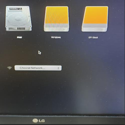

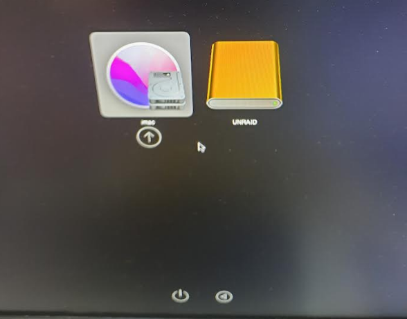

After I restored the Mini to use the latest supported macOS without the patcher, I had to press the boot selection key, and there are 3 options:

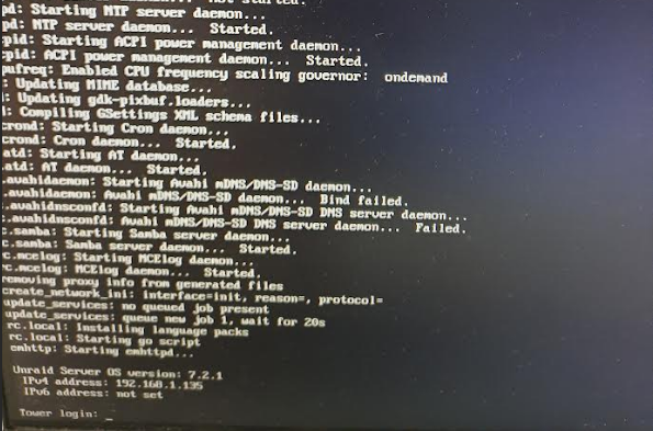

For some reason, the EFI boot option is not working now; it locks up on that screen, doesn't show anything else, but choosing the Windows option, it boots legacy, and it can boot 7.2.x fine. This is the part where it crashes during UEFI boot:

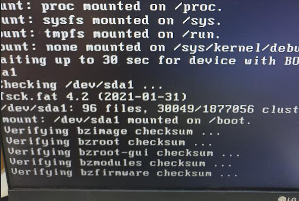

Boot complete:
So worth testing for anyone else having the same issue, if legacy boot still works.

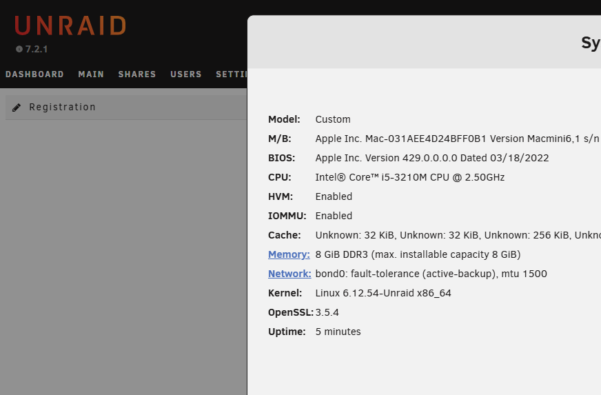

I’ve been testing this tonight and appears to work. Able to boot the Mac Mini 2012, in EFI mode with the Thunderbolt 2 enclosures attached.
@James Miller did you just use the config settings posted above? I have a mini with this issue too.
The posted config is an example; you can adapt it to the options you are using, but that one will work as is.
