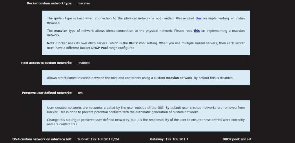

52 minutes ago, SmokeyColes said:
I have a PLEX container running in Docker with a custom: br0
You didn't enable "Host access to Custom Networks" in the unraid docker settings page.
@MowMdown Cheese and Crackers - I would have been there for months!!!! Working a treat over the subnet.

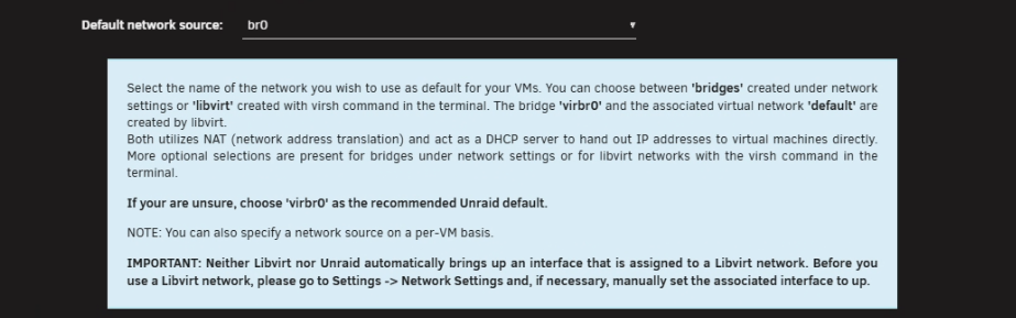

other recommended docker /vm/ unraid networking options...
vm settings:
docker settings:
