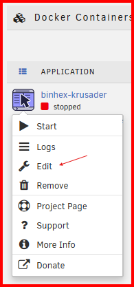

Look for the support thread for that container:
