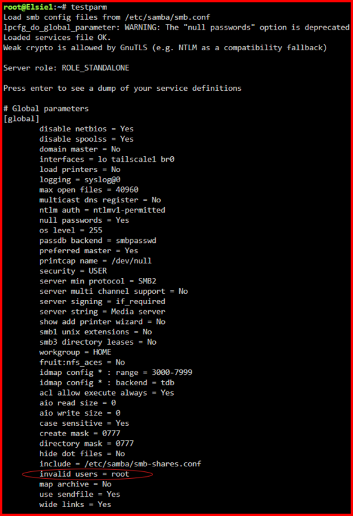

IF you are using Samba, root is not allow to be a Share Access user!!! It is a security issue. And this restriction is enforced:
