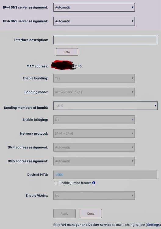

Hello,
a few weeks ago I deactivated the LAN-Port (1GBit/s) of my server within the BIOS.
On the same day I switched to an external USB-Ethernet-Adapter (2.5G). I assigned the old IP-address to the new adapter after.
Now, some weeks later, my router told me there are 2 clients using the same IP-address, both of them online - the new and the previous devices. But, there is no cable connected to the old (and deactivated) LAN-port.
Is there an explanation & a workaround for this ?
You need to identify the nic using each of those Mac address. Then assign them different IP addresses. The image has the word proxmox in it which strikes me as a little unusual for the scenario you described.

And, is has nothing to do with bridging/bonding for docker containers?
And, mcvlan or ipvlan ?
Looks like this …

IIRC that's normal with a Unifi router and ipvlan, try macvlan.
I tried to find that option… please tell me how and where to switch from ipvlan to macvlan.
And, are there any concerns switching from one to the other ?
I see both the vhost and hardware mac addresses on the same IP using macvlan in unifi. I don't recall having that on ipvlan but its been ages since I tried using it. It doesn't actually cause issues as far as I can tell but it is annoying.

unifi and their network traffic doesn't always read the other end of the bridge and its on unraids first array start that unifi over detects 2 macs, the shim bridge and the unraid interface. This is entirely over scan on unifi networking.

as the nature of the shim bridge not using or generating a random mac or unraid not programing in a random mac... the command at boot, network creation duplicates the mac address and dhcp due to ipv4 forwarding sends and gets a dhcp request. unfi detects rouge dhcp server flags this as 2 of the same macs requesting a ip and say no one is a rouge system and trying to hack in...
Thus the unfi warning and overzealous hit due to unraid bridge creation.
as what happens is eth0 mac gets cloned and makes br0 then br0 mac gets cloned to make shim-br0 unfine doesn't know what unraid did nor see the separation with the interfaces... unifi detects and see 2 of the same mac and logs a error....
Further issues with dockers on ipvlan as they can trigger and do the same...
This is why I recommend using macvlan first and ipvaln if you have errors... pfsense and opensense if the settings are high enouth can detect and see this. but I've only encountered this issues and errors on unify due to how they handle clients and record previous client connections...
unfi is overzealous in its rouge dhcp scan. unraid doesn't make the shim-bridge interface very well. This is why my user script to flush the shim bridge and static assign a different ip which will make the shim bridge interface generate a random mac... I've seen unifi client spam due to unraid reboots and the use of my workaround script...
