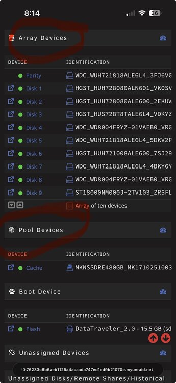

28 minutes ago, wgstarks said:
you can see that I don’t use pools at all
Your screenshot shows that you have one single drive pool named cache
@trurl Yes I installed both docker and the plex addon, but I have not enabled docker yet? So that was correct? I wont do that research until all of the data is moved. Once all of the data is on the Unraid-server I will go back into DrivePool and ask it to remove one of my HGST drives. This will let me shut down the Unraid-server and install one more 8TB drive, that way I can create the Pool finally, I think? Also I have a 4TB nas drive that will be used in the pool but it is filled to the brim with data that I want to go through first. Not yet sure how to transfer that data yet, but it is currently sitting in a USB Docking station on my main Rig and will be the very last thing I add to the Unraid-server.
Yeah, used to use a 2 drive cache pool. Just a single drive there now. Never changed it back. No zfs pools though.
