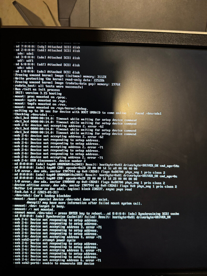

I upgraded my system to 7.2.2 from 7.2.0. I did my usual checklist of updates and backups and then dove it.
Upon the first boot of the system, I got the screen attached. I saw in this screen mention of pressing enter to reboot which I did. Then it wouldn't recognize the thumb drive(booted to BIOS). I moved the drive out of the USB motherboard header to a regular USB front port. Still no go. I checked the drive on my main Linux PC. Seemed OK. I tried a port on the back of the PC. No go. Then tried another front port.

I was able to grab the logs directory off of the USB drive after it had booted to the error state.
Can anyone tell me what's going on here? Bad USB ports on my motherboard? USB 3.1(vs 2.0) weirdness?

It appears to be a flash drive issue; try a different USB port, ideally on a different USB controller. If the same, replace the flash drive.
