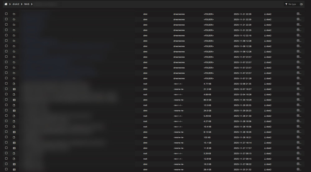

It works but the data on the original disk was luckily never a problem. The problem is only with the new drive that I added to the array and the data that was on it.
