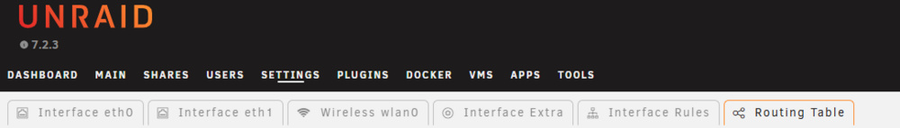

this can also be seen in the gui.
via the routing table:
*more somethign to doble check.

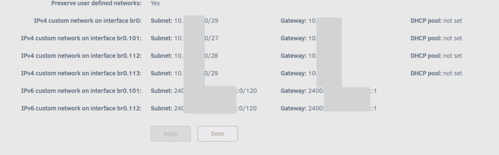

Just to show as well, this is on the Docker settings page, all values are entered
IDK not enough to go off of.
to clarify, are you using the same ip range for both br0.101 and br0.112 ? or are they different.
as unraid doesn't handle ip routes when the same ip is used on multiple interfaces.

Just now, bmartino1 said:
to clarify are you using the same ip range for both br0.101 and br0.112 ? or are they different.
They are each different subnets so there is no double ups, this was all working in its Ipv4 world, trying to add the v6 is where its coming un-stuck >_< hahah

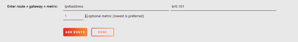

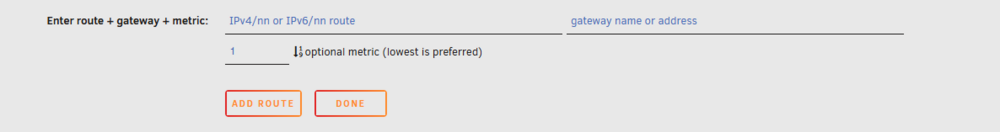

defaults are fine, but we may need to add a ip route for the ipv6 subnets.
this can be done via the gui
double check that the vlans have routs to br0 and or to the subnets for traffic. good luck. maybe another mod will be here to assit further.

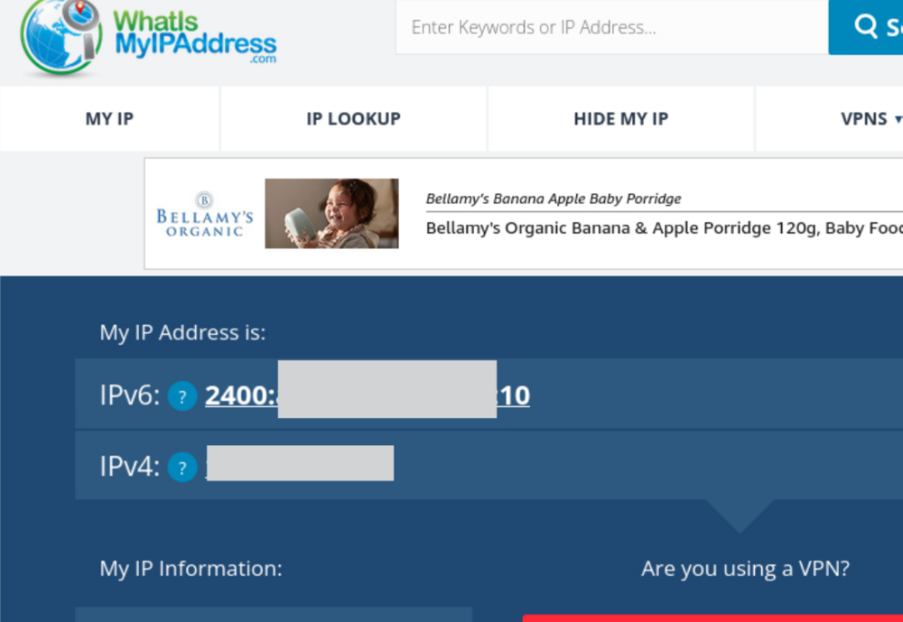

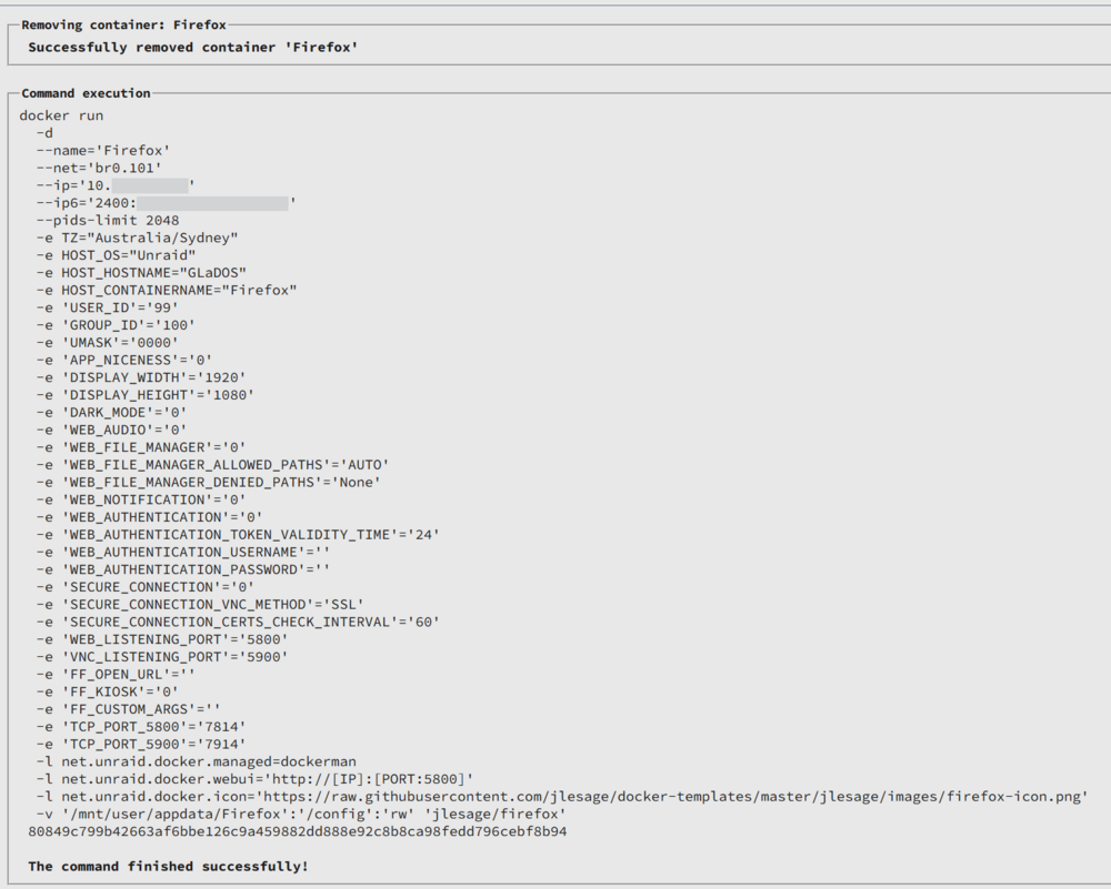

Well this is odd, rebooted, firefox started no issues, however its being assigned a random Ipv6
Add an IPv6 to the docker,
Load it up and it still gets the same random IPv6 address
Is there a way to validate within the docker the Ip6 is assigned correctly?

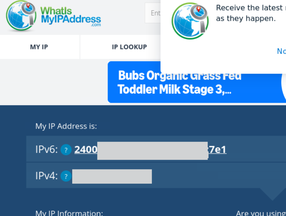

Ok more progress, my router had a combined policy and it was using NAT for both v4 and v6 my system is now showing the correct IP, more testing inbound, still cant load it directly using the IP in the address bar as it has a connection problem when it loads the ipv6 directly.
I would assume if it has an IPv6 assigned I can access it from the web UI without a port or is that not the case typically?

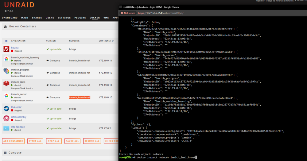

docker inspect command...
docker inspect network br0.101
look for the container name and the ipv4 / ipv6 address
