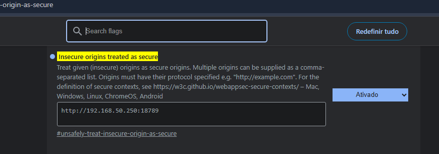

    If your on chrome or like me edge then edge://flags/#unsafely-treat-insecure-origin-as-secure Enable Insecure origins treated as secure and add your local ip on unraid server running openclaw I.E http

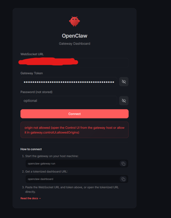

But It is stuck asking for https or running on local host, which I can't do on this box. Ideas?
OpenClaw docker doesn't like trying to use tailscale the way unraid doesnt its container setup. Run tailscale directly on unraid.

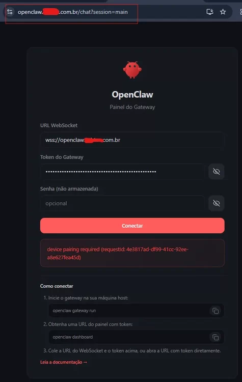

Just did another test install on unraid and it installed just fine. Only difference from post on page 6 is you now get your device pairing required requestId via the browser and don't have to run openclaw devices list.
Take the requestId via the browser and pair it openclaw devices approve xxxxxxxx-xxxxxx-xxxxxx-4443434cac61 --token "$OPENCLAW_GATEWAY_TOKEN"
Enable Insecure origins treated as secure and add your local ip on unraid server running openclaw I.E http://192.168.1.100:18789

And you have to pair you device this has been posted on a few times here now you get pairing request via the browser just take that requestid and run it with openclaw devices approve xxxxxxxx-xxxxxx-xxxxxx-4443434cac61 --token "$OPENCLAW_GATEWAY_TOKEN" inside the container.

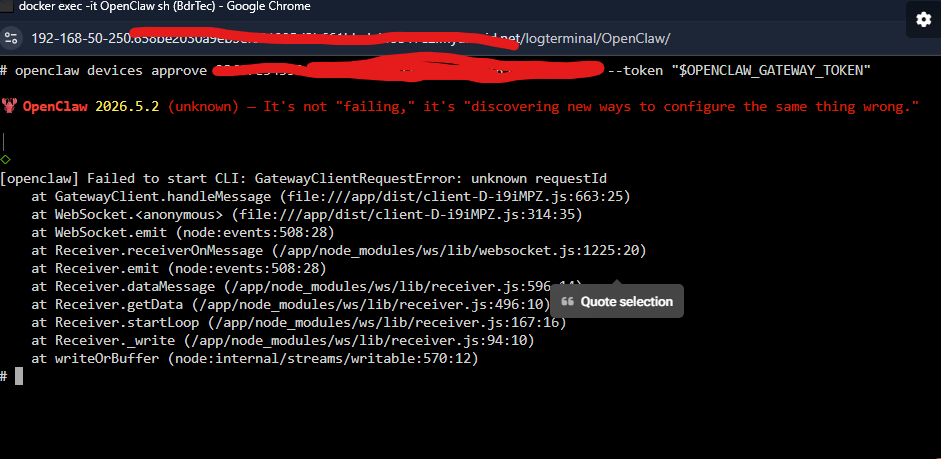

I did it but it didn't work....if you have one, I'll leave the prints.
I did this too:
I did this too:

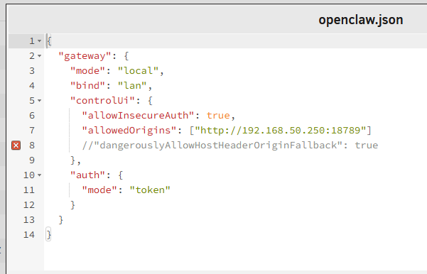

"gateway": {
"mode": "local",
"bind": "lan",
"controlUi": {
"allowInsecureAuth": true,
"allowedOrigins": [
"http://localhost:18789",
"http://127.0.0.1:18789",
"http://192.168.50.250:18789"
Your request id will show up from you browser like in your post on page before. Please make sure once
you figure this out and get it running that you delete and reinstall it dont give out your requestid stuff like that. You can also unauthrize that id and get a new one using commandline inside the container if you wiosh to do that.

"allowedOrigins": [
I deleted docker and deleted the folder in appdata. I reinstalled everything from scratch.
I added "http://192.168.50.250:18789" in the json file.
I ran the command in the docker console but I still couldn't. Did I do it right?
openclaw devices approve xxxxxxxxxxxxxxxc9d9 --token "$OPENCLAW_GATEWAY_TOKEN"

ANOTHER Temp fix
Add the below to the config to temporarily disable the https requirement.
gateway.controlUi.dangerouslyDisableDeviceAuth = true
that works here also. Had to add it to "allowedOrigins" also...
      "allowedOrigins": [
        "http://<UNRAID-IP>:18789",

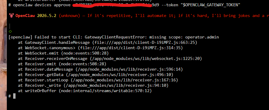

I managed to make it work.....I'll leave what I did to help others.
In docker console:
openclaw devices approve ENTER-YOUR-ID-DEVICE-HERE --token "$OPENCLAW_GATEWAY_TOKEN"
