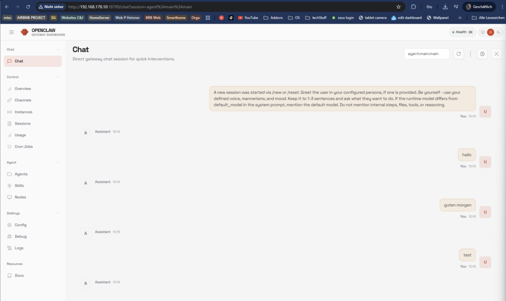

anyoneget the same issue ?
my answers are empty ( using gemini with api key)
Ive got the same issue, with a fresh install and but using Claude api key. I did try changing to host mode to bridge and custom IP, which made no difference. Does the container need to run in Admin/Root mode? Am i missing something in post install process from the Unraid store, Is there a container setup/install script to run?

same issue for me too. Also using claude api key : chatbot answering empty responses. Perhaps something to setup in the "model" tab of the setup panel in the webui of openclaw but i am too limited to successfully do something working in it ! my bad
same issue for me too. Also using claude api key. (bot answering empty responses). Perhaps something to setup in the "model" tab of the setup panel in the webui of openclaw but i am too limited to successfully do something working in it ! my bad
Same issue, I couldn't get a reply, using anthropic/claude either
you are probably getting rate limited
