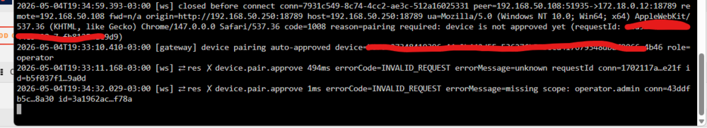

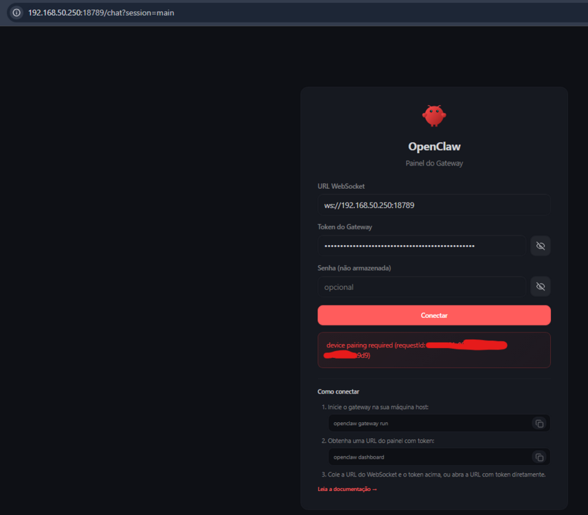

I am not sure what I'm doing wrong but I can for the life of it not get OC running.
My problem seems to be that the API can not connect to the gateway (even if the GUI shows a connmection and chatting works).
I can't seem to figure out why.
I have clean-fresh-installed 5x now, doctor will always give me "gateway connect failed: Error: pairing required".
I have manually created /root/.openclaw/identity/device-auth,json (since it did not autogenerate) but now luck.
I have tried to manually rotate tokens about 30x now, no luck.
I tried first solving it by asking OC itself for help but it seems stuck on trying to convince me that my problem is that fact that OC seems to keep its config in /root/.openclaw", a directory that OC itself calls "ephermal" and thus not "reboot-persistent".
Then I tried asking chatGPT about it and that one at least gave some intreresting hints such as correcting file privileges - but in the end it will just not work.
Apparently the installation of OC in Unraid does NOT take the gateway token over from the config dialogue in unraid into the installation for the API/gateway config.
Are there steps missing in the explanation here jdhill777/openclaw-unraid: Unraid Community Applications template for OpenClaw AI assistant ?
Any help apprechiated!
Edited by southy44

Conect ssh to unraid
http://localhost:18789/?token=your_gateway_token
open /appdata/openclaw/config/devices/pending.json
change "silent": false --> true
It works for me
It works for me
The devices folder and pending.json does not exist on my system
    It works for me
That actuall did the trick!
Thanks!

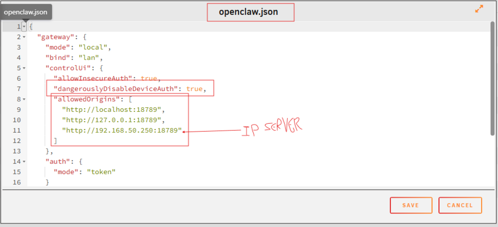

So now I also run into the gateway issue. Normal commands work fine, but when I tell OC to create a task that needs a CRON job I get the following error
[tools] cron failed: gateway closed (1008): unauthorized: device token mismatch (rotate/reissue device token) Gateway target: ws://192.168.86.45:18789 Source: local lan 192.168.86.45 Config: /root/.openclaw/openclaw.json Bind: lan
My gateway config looks like this, I have a feeling that the issue comes from OC talking to itself via the IP address and not using a token.
  "gateway": {
    "port": 18789,
    "mode": "local",
    "bind": "lan",
    "controlUi": {
      "allowInsecureAuth": true
    "auth": {
      "mode": "token",
      "token": "MY TOKEN"
    "tailscale": {
      "mode": "off",
      "resetOnExit": false
My pending.js was empty, so I added
"silent": true
but that did not change anything.
