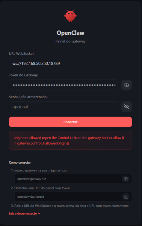

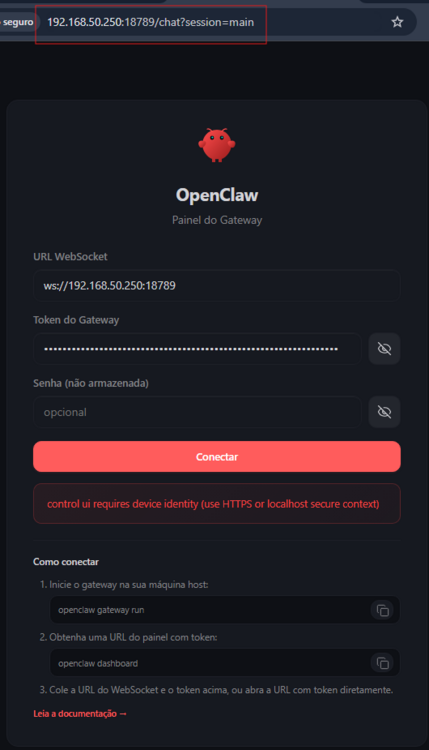

    If your on chrome or like me edge then edge://flags/#unsafely-treat-insecure-origin-as-secure Enable Insecure origins treated as secure and add your local ip on unraid server running openclaw I.E http
  • Can't seem to find the template on community apps. Was this published yet?
Enable Insecure origins treated as secure and add your local ip on unraid server running openclaw I.E http://192.168.1.100:18789
Edit your openclaw.json in appdata->openclaw->config you will see section like this
"allowedOrigins": [
"http://localhost:18789",
"http://127.0.0.1:18789"
Edit it to include your Unraid Servers IP
"allowedOrigins": [
"http://192.168.1.100:18789",
"http://host-name-or-whatever:18789",

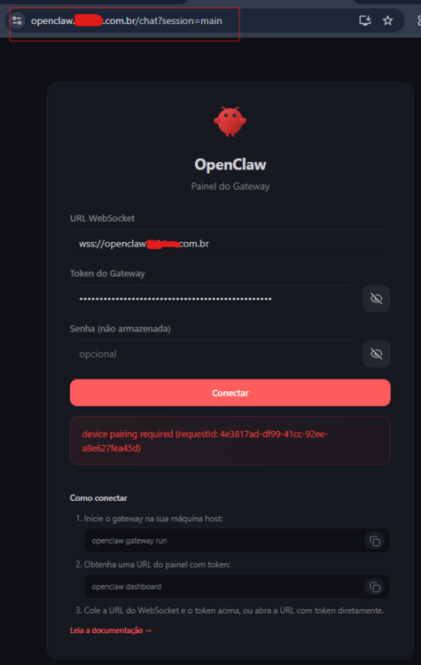

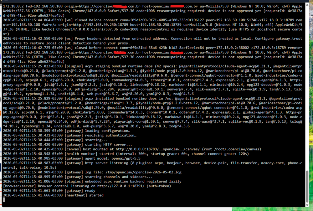

Start OpenClaw Docker and open the webui. then just close it.
Open console terminal for OpenClaw docker and run
printenv OPENCLAW_GATEWAY_TOKEN
openclaw devices list --token "$OPENCLAW_GATEWAY_TOKEN"
It will spit out some stuff like
🦞 OpenClaw 2026.3.24 (unknown) — Say "stop" and I'll stop—say "ship" and we'll both learn a lesson. │ penclaw devices approve --latest --token "$OPENCLAW_GATEWAY_TOKEN"◇ Pending (1)
under that you will see your Pending (1) client and you will see a key something like xxxxxxx-xxxx-xxxx-xxxx-xxxxxx3971
copy that key and run
openclaw devices approve xxxxxxx-xxxx-xxxx-xxxx-xxxxxx3971 --token "$OPENCLAW_GATEWAY_TOKEN"
After that try opening webui should work.
If you use a reverse proxy you could set it up at OpnClaw and probaly skip the "Enable Insecure origins treated as secure"

Oiii, pessoal não consigo entrar no openclaw....alguma dica pro favor?
Tenho Adguard, Npm, OpenClaw.
When I enter like this, I get this error
http://192.168.50.250:18789/?token=mytokenhere
https://openclaw.mydomain.com.br/?token=mytokenhere
If I edit the openclaw.json file to
  "gateway": {
    "mode": "local",
    "bind": "lan",
    "controlUi": {
      "allowInsecureAuth": true,
      //"allowedOrigins": ["*"]
      //"dangerouslyAllowHostHeaderOriginFallback": true
    "auth": {
      "mode": "token"
The error now is
