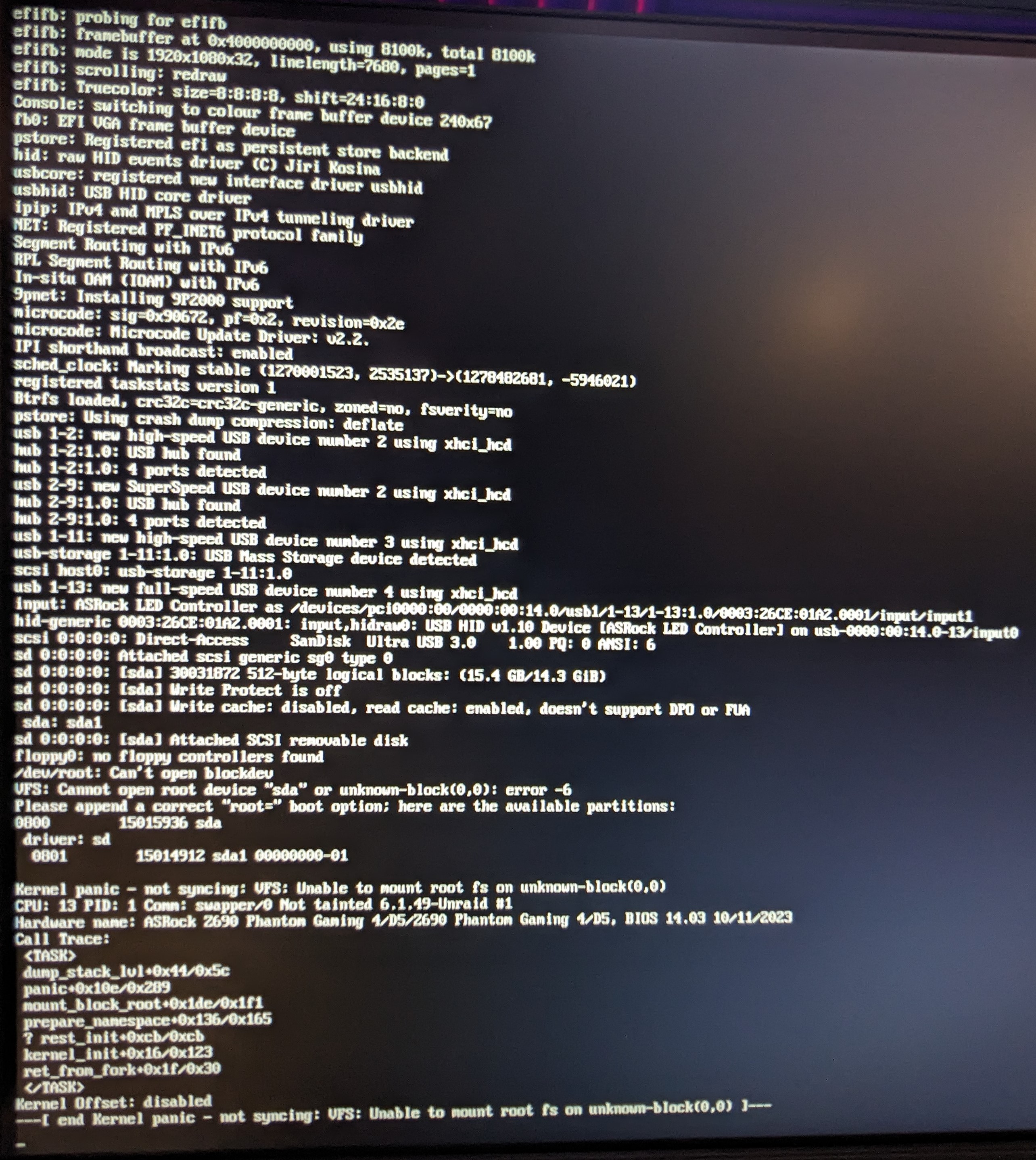

  7. I was able to get the new USB to boot. It seems there may be an issue with the UNRAID USB Creator. When I use the Local Zip option to write any zip file, including my backup USB zip and the Archived downloaded from here (unRAIDServer-6.11.5-x86_64.zip) the USB failed to boot. To get my new USB to work I used the UNRAID USB Creator and selected the Stable option. It downloaded the newest version of UNRAID (6.12.8) and wrote it to the new USB. I then copied my backup config folder to the new USB. This solved my issue and my array is back up and working normally.
  8. My original UNRAID USB drive died, fortunately I preformed backups and saved them externally. I used the UNRAID USB creator, local zip option, to flash my backup to a new USB drive. When I boot the new UNRAID USB I get a kernal panic - "Cannot open root device" I've tried the solution mentioned here with no luck. I have also tried different USB drives and USB ports on the computer. Help! syslog.txt

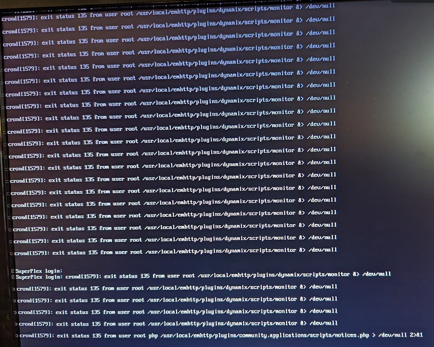

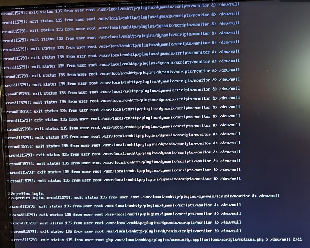

  9. I have been running UNRAID for about a month and it has crashed on me twice. When it fails I am unable to SSH, access the shared folders, or GUI. When I connect a monitor, keyboard & mouse to the server I am not able to login and I see the message below... crond[1579]: exit status 135 from user root /usr/local/emhttp/plugins/dynamix/scripts/monitor &> /dev/null I have Syslog running and pointed to the UNRAID server however when I look at the log it jumps from Nov 10 to Nov 17. There is no data in-between. What could be causing this issue? UNRAID Version 6.12.4 2023-08-31 ASRock Z690 Phantom Gaming 4/D5 CPU i5-12600K Memory 64 GiB DDR5 --Plugins-- appdata.backup.plg - 2023.10.16 (Up to date) ca.cleanup.appdata.plg - 2022.10.21 (Up to date) ca.mover.tuning.plg - 2023.08.22 (Up to date) community.applications.plg - 2023.09.30 (Up to date) dynamix.system.temp.plg - 2023.02.04b (Up to date) dynamix.unraid.net.plg - 2023.09.08.0637 (Up to date) fix.common.problems.plg - 2023.10.08a (Up to date) folder.view.plg - 2023.11.04 (Up to date) nut-dw.plg - 2023.11.08 (Up to date) plexstreams.plg - 2023.06.29 (Up to date) unassigned.devices.plg - 2023.11.10a (Up to date) unbalance.plg - v2021.04.21 (Up to date) unRAIDServer.plg - 6.12.4 user.scripts.plg - 2023.09.30 (Up to date) vmbackup.plg - 2022.12.25 (Up to date) syslog-192.168.1.9.log
