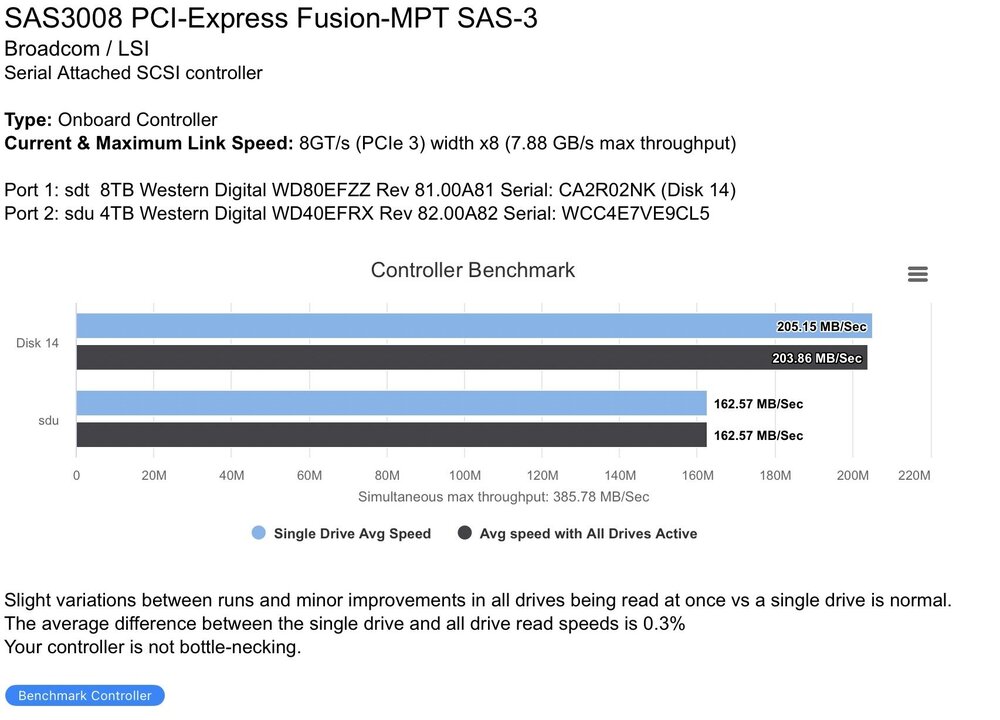

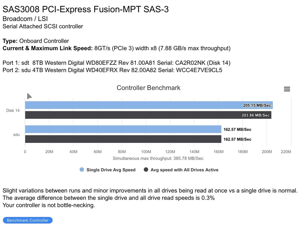

I installed the Disk Speed docker and ran the benchmark on all of the drives and all reported the correct full speeds. So I decided to remove the two Optane drives that are on PCIe x1 to NVME cards and now the parity calculation runs at the 140MB/s speed that I was previously seeing. So Iโ€™m assuming this means that I donโ€™t have sufficient PCIe lanes to support all of the devices at full speeds?
That doesn't make much sense. Did you run the controller tests as well?
Iโ€™m finding it odd as well. I did some benchmarking on the controllers. The only difference between the two sets are with and without the Optane drives installed in the PCIe x1 cards.

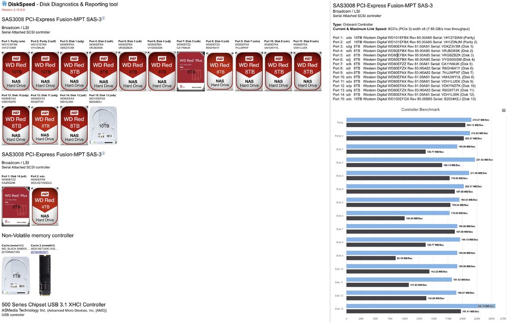

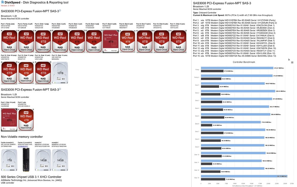

These first two screenshots are without the two Optane drives installed
These next two screenshots are with the Optane drives installed

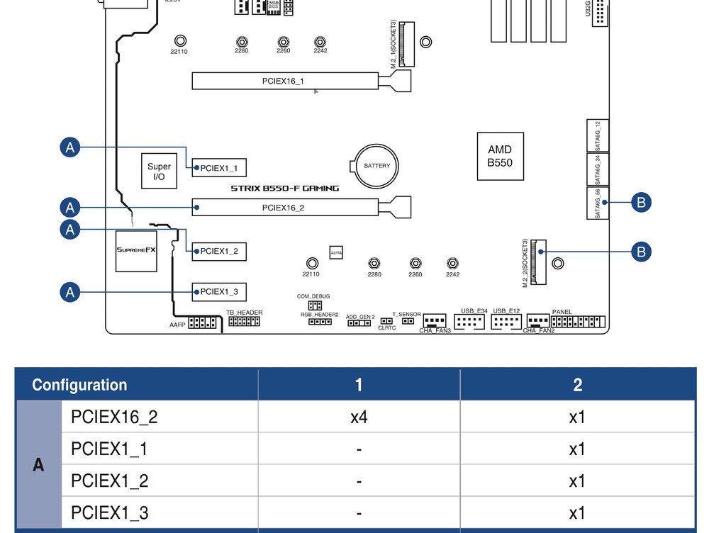

Have you tried changing the PCIe slots the cards are plugged into? I've ran into scenarios on my DiskSpeed dev box where a card wouldn't have the expected speeds if it was plugged in x slot vs y slot, even though the slots had enough PCI lanes for it and the bios hadn't changed the number of lanes utilized (that may also be an issue, check your MB docs).

So I think Iโ€™ve got everything sorted out. I initially had the graphics card in PCIEX16_1 and the LSI HBA in PCIEX16_2. As soon as I added anything into any of the PCIEX1_x slots, then PCIEX16_2 will change from x4 to x1. Since Iโ€™m only using the video card for transcoding, I swapped the slots that it and the HBA are installed in and now my parity calculation is running nicely at about 170-180MB/s with the NVME risers in PCIEX1_1 and PCIEX1_3 (PCIEX1_2 is blocked since the video card is a double height card).
